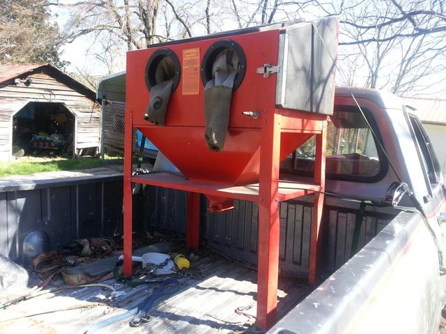

ibskot 37 #1 Posted March 31, 2015 It's a HF model...the standing one. I have never used one. It's cheap so I figure not too much invested to see if I can use it...plus, I see guys restoring these WH's here and I think my son, instead of a go kart, would like a resto project with me. Maybe one of the tiny RJ ones. Any help/knowledge is appreciated. Share this post Link to post Share on other sites

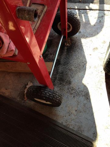

Dhodge 530 #7 Posted March 31, 2015 I have seen a lot of pro's and cons on those units. I have one and it works great, however it did not start out that way. As stated above if it has not been caulked, do yourself a favor and take it apart and caulk every seam with clear silicon caulk. If that has the ac/dc converted light fixture in it replace it with a light system of your own. Hook a shop vac up to it to keep the dust cleared away and it will blast really well for you. I put an axle and pneumatic tires on mine. Made some wheel barrow handles out of 1/2" galvanized pipe I had laying around so I can move it any place I need to. 2 Share this post Link to post Share on other sites
ibskot 37 #8 Posted March 31, 2015 Well, definitely not new...the legs are slightly bent and it's missing a few sheet metal screws but nothing I can't replace. Wonder if those sites would have parts that fit a HF cabinet? Anyway, I still have to get it off my truck. I thought it ironic that the PO had the same compressor as me. Comforting I suppose. I have seen a lot of pro's and cons on those units. I have one and it works great, however it did not start out that way. As stated above if it has not been caulked, do yourself a favor and take it apart and caulk every seam with clear silicon caulk. If that has the ac/dc converted light fixture in it replace it with a light system of your own. Hook a shop vac up to it to keep the dust cleared away and it will blast really well for you. I put an axle and pneumatic tires on mine. Made some wheel barrow handles out of 1/2" galvanized pipe I had laying around so I can move it any place I need to. Some great suggestions...thanks. Share this post Link to post Share on other sites

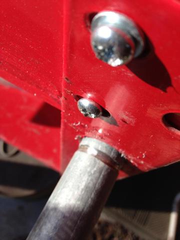

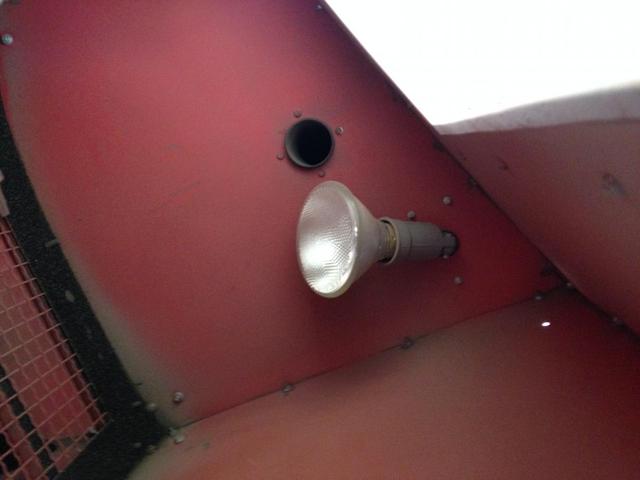

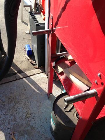

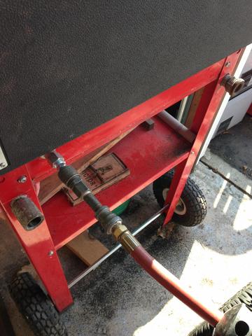

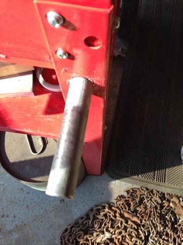

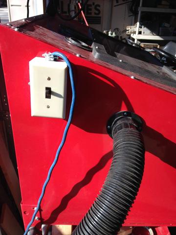

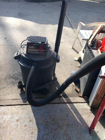

Dhodge 530 #13 Posted March 31, 2015 Here are some pics of mods I made to my blast cabinet.. I used my chop saw to cut grooves into the handles so that they would accept the angled metal above to keep the handles from pushing on through while moving it. I also used the threads on the pipe (handles) for what should have been galvanized cap fittings, which I didn't have in the shop so I compromised with what I had so they can't pull thru. My light is a simple flood light with outdoor box and lamp holder. Make sure you have the plug on the back that is removable so you get a negative pressure inside the cabinet while vacuum is running or you may suck the sides of the cabinet in and compress it like squeezing a beer can. I run mine at 90 psi and it works with all kinds of abrasives. Send me a private message for my phone number if you have questions. I would be happy to help if I can. 1 Share this post Link to post Share on other sites

ibskot 37 #15 Posted March 31, 2015 Awesome, thanks. Big mouse trap there huh? Mine is a tad different I think. I will take more pics later. At work til 11pm. Share this post Link to post Share on other sites

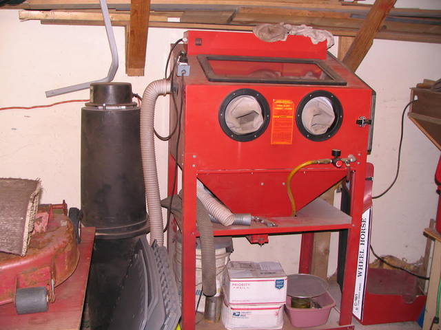

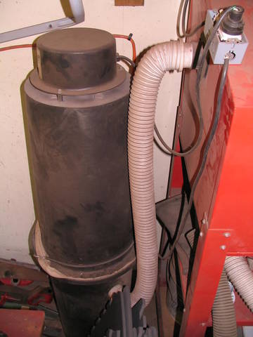

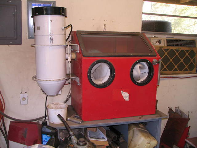

pacer 3,181 #18 Posted March 31, 2015 I made some few mods to my cabinets also.I kept the small cabinet and even tho the bench top cabinet is inferior to the leg model, I have tinkered with it off an on and have it working pretty well now. On the big cabinet I added casters to the legs for moving, added a ball valve to turn air off at cabinet, added a Cyclone recovery system for dust and added a toggle switch to control both to come on at same time and added a shelf in bottom. The existing cabinet light failed after a time and I replaced it with an 'under the cabinet' 24" fluorescent fixture from big box store (also added one to the small cabinet, it didnt come with light) When my gloves wore out I replaced them with longer cuffs for easier access to parts inside. If I had known about the HF "Blast Cabinet Reclaimer Kit" shown on the side of the small cabinet I would have elected to put one on the big cabinet - its just all around a better system, and cheaper! Share this post Link to post Share on other sites
ibskot 37 #19 Posted March 31, 2015 Dhodge, I have what looks to be the same model as Pacer is showing in his pic. I have a 60 gallon Kobalt....the same as the guy I got it from. It was the most I could get money wise. Share this post Link to post Share on other sites
ibskot 37 #20 Posted March 31, 2015 Pacer, how does the reclaimer kit differ from a dust collector? Share this post Link to post Share on other sites
1989520HC 13 #21 Posted March 31, 2015 I grew up with a sand blast cabinet in the garage. I sand blasted everything I could get my hands on....My Dad made one out of three sheets of plywood. He restored two model A Fords with it and it still works today. They do gulp down the air. Share this post Link to post Share on other sites
ibskot 37 #22 Posted March 31, 2015 I have seen the plywood ones. I guess I coulda went that direction but as long as it takes me to do stuff, that may have taken another year. 1 Share this post Link to post Share on other sites
pacer 3,181 #23 Posted April 1, 2015 I dont know how "reclaimer kit" came to be, what it "reclaims" is about like flour and is of no more use. The HF unit is more compact and easy to clean the 'reclaim' than the much larger Cyclone version - at least the one I have. Share this post Link to post Share on other sites
