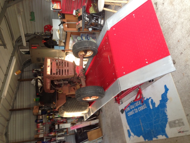

Bobster 19 #29 Posted June 8, 2015 My wife bought this lift for me. l just finished putting aluminum walk board down each side to widen it. I think I am going to like it 3 Share this post Link to post Share on other sites
876wheelhorse 46 #30 Posted July 2, 2015 if you widen the table to fit the tires fully on the table, how does that make the table feel? my concerns that it may become alittle top heavy and tip over? would making the bottom alittle wider be a good idea? 1 Share this post Link to post Share on other sites
Bobster 19 #31 Posted July 4, 2015 I didnt notice it being unstable in any way. I love it. I used it the other day to put my K181 on the 857 frame, I had the engine mounted on a high work cart. I raised the lift to it's max. It was about 3 inches lower tha the cart. Using a piece of plywood, I slid the engine over onto the lift. Then I parked the tractor at the end of the lift and let the lift down on the front wheels. Then I slid the engine onto the tractor, All by my self. Pretty neat. Love it Share this post Link to post Share on other sites

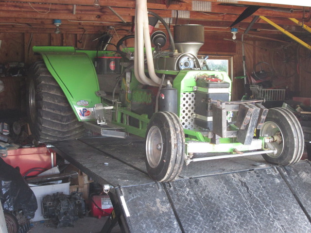

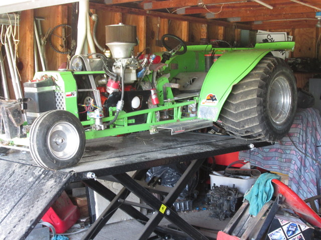

baerpath 517 #32 Posted July 16, 2015 I used mine today 1600lb modified Could be a little bigger table though 2 Share this post Link to post Share on other sites

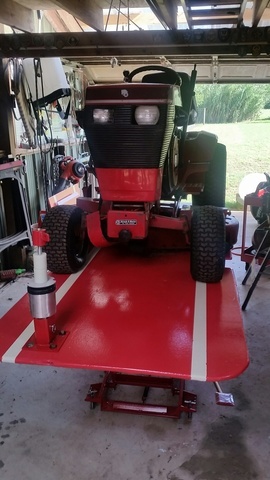

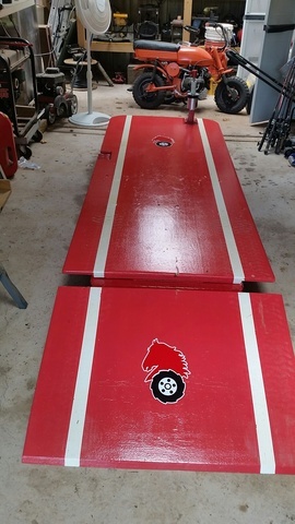

Texas Todd 1,026 #45 Posted June 17, 2016 Well, I had the same idea many of you did. Modified with some 3/4 plywood. May still be a tad narrow for the 520-H but fits the 312 just fine. Looking forward to not standing on my head! 2 Share this post Link to post Share on other sites

WNYPCRepair 1,924 #48 Posted June 18, 2016 2 hours ago, TVR said: Well, I had the same idea many of you did. Modified with some 3/4 plywood. May still be a tad narrow for the 520-H but fits the 312 just fine. Looking forward to not standing on my head! Looks great! What are the measurements of it when it is down? I would love to have one, but I don't think I have room. Great idea for the tire machine, too. 1 Share this post Link to post Share on other sites
Texas Todd 1,026 #49 Posted June 18, 2016 (edited) Its 38"x 96" just ripped the width. Shoulda done 40" The 512 may be a touch wide but everything else is good. The tire machine worked well, for what it is. Put 5 3/4" runners beneath to keep it from twisting. Edited June 18, 2016 by TVR 2 Share this post Link to post Share on other sites
