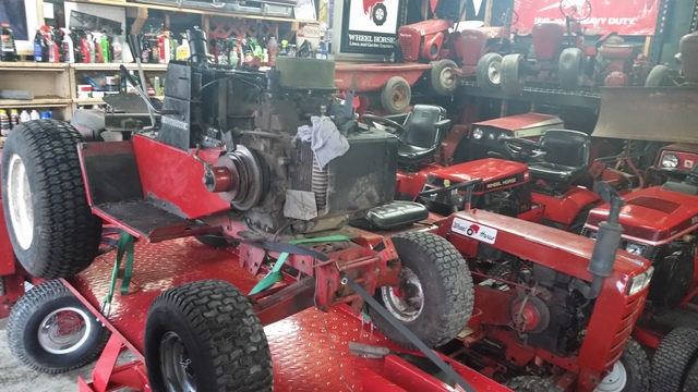

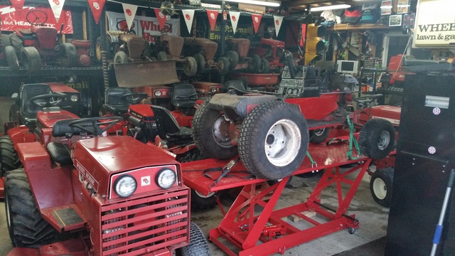

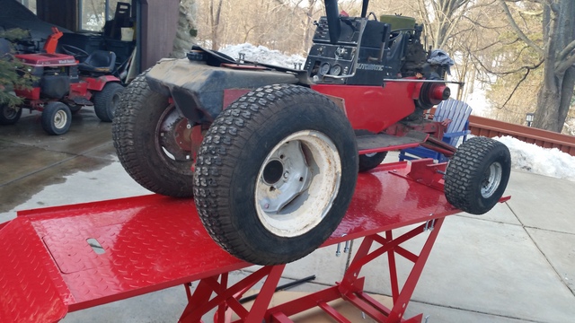

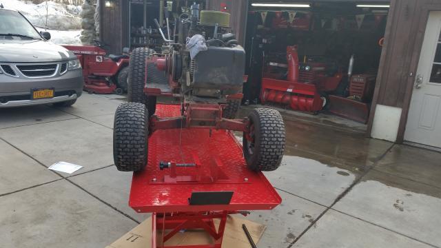

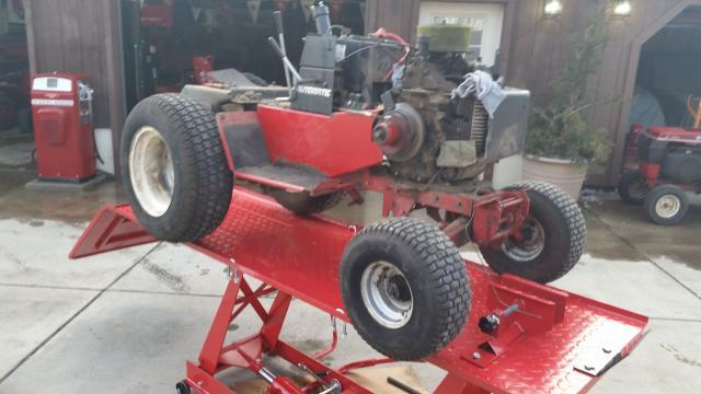

Cutlas3391 776 #1 Posted March 14, 2015 I bought the harbor freight lift for 299.00 not bad for lifting up the wheel horses. I'll have to custom some wider plates to the side for wider tractors. Otherwise very impressed with the quality of the lift... The 420 lse is on the lift in the pictures. 5 Share this post Link to post Share on other sites

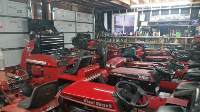

KC9KAS 4,746 #2 Posted March 14, 2015 (edited) Very nice. I have thought about that same purchase. It is on sale locally now ($299) Yea, maybe a little narrow! Nice looking herd in the barn. Edited March 14, 2015 by KC9KAS 1 Share this post Link to post Share on other sites

squonk 48,260 #5 Posted March 14, 2015 I'd be chaining that tractor down or getting it off and build those extensions before going any farther! 2 Share this post Link to post Share on other sites
formariz 12,381 #6 Posted March 14, 2015 I also bought one a couple of months ago. It works great, but the extensions are a must for safety sake. Carefull lowering it with a tractor on top. Mine has a trigger like control that if you are not carefull it will drop it in one shot. It sits about 6 inches high in the lowered position (wood extensions will of course make it higher). It is real easy to push around unloaded and I actually move it back and forth with a tractor on top. Since I have some real heavy machines that if not running I cannot push them up the ramp by myself, I installed a winch with a remote control on the shed back wall which allows me to steer the tractor and acticate the winch at the same time. So that the winch does not also pull the lift I modified the adjustable stabilizers by removing the pads and grinding them to a point that sticks to my plywood floor when using it. Nothing like working on a tractor with a straight back being able to see stuff that ordinarily one would have to be on their knees sticking ones head under the hood, and also having a place to keep your tools handy. Here was the frustrating part of purchasing mine. They actually list two models one being called a motorcycle/ATV lift with a different product number. When one reads the specs for it it states clearly that it is not only about 6 inches wider than the other one but it also lifts about 4 inches higher. I had to go through 8 different stores until I found the right one in the next state. I buy it, bring it home and then see that it is the same as the other one. Whats the point of listing two different ones when they are the same? 3 Share this post Link to post Share on other sites

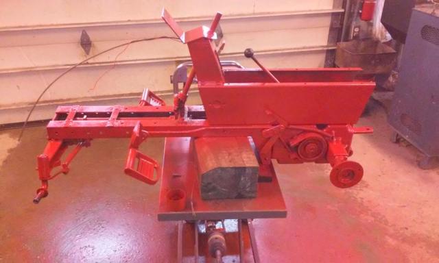

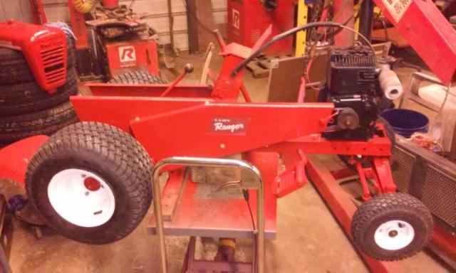

steve k 82 #7 Posted March 14, 2015 I bought one of the smaller ones and love it. You can sit in a chair and work all around it. Just used some blocks in the center. wheels come off easy when they are dangling. One problem though , it will not go low enough to just slide under this lawn ranger so some fussing around is needed to get it on and off but no big deal for less than $200. Also use the lift for my hit and miss engines. 3 Share this post Link to post Share on other sites

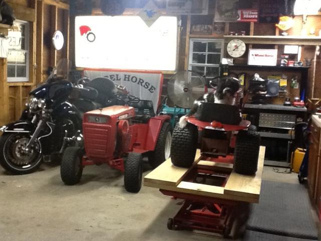

Marv 996 #9 Posted March 14, 2015 I have one of those. I mounted a sheet of 3/4 plywood on it to widen the platform. Works well for me. Getting "down" to work is no longer a good option for me so having the lift helps a lot. Marvin 1 Share this post Link to post Share on other sites
squonk 48,260 #10 Posted March 14, 2015 I bought one of the smaller ones and love it. You can sit in a chair and work all around it. Just used some blocks in the center. wheels come off easy when they are dangling. One problem though , it will not go low enough to just slide under this lawn ranger so some fussing around is needed to get it on and off but no big deal for less than $200. Also use the lift for my hit and miss engines. I have one of those little tables. It has jus enough oomph to lift my 704. Comes in handy for decks and blowers too! 1 Share this post Link to post Share on other sites

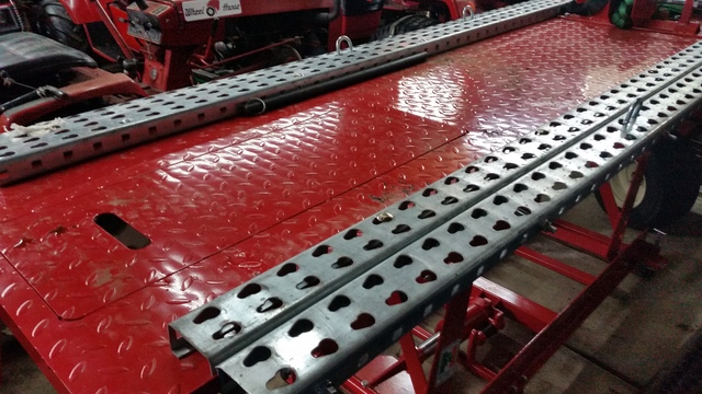

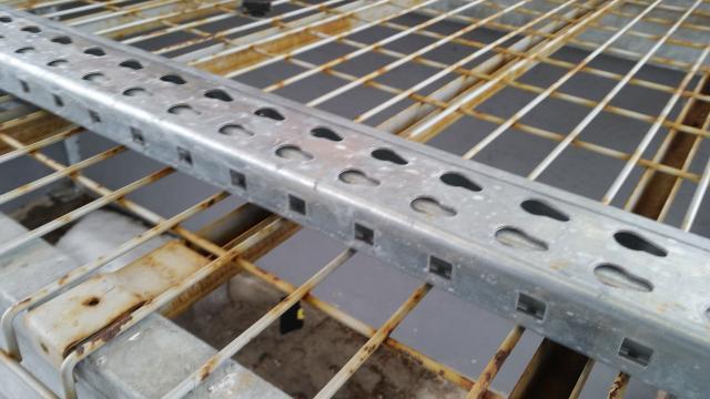

Cutlas3391 776 #21 Posted March 15, 2015 I figure I make these work for the sides Share this post Link to post Share on other sites

Cutlas3391 776 #24 Posted March 22, 2015 Updated the motorcycle lift from harbor freight. Pretty easy way to make the table wider to fit tractors more comfortably. Cut up some pallet racking and bolted together and to the table... Share this post Link to post Share on other sites
