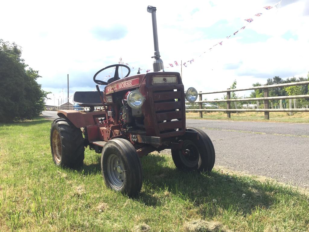

callum12 257 #190 Posted January 18, 2019 On 1/17/2019 at 1:32 PM, pullstart said: It’s a bummer that all these pictures have gone away 🙁 to photobucket’s deep pockets I know! I can't believe they have done this, 1000s of informative posts, peoples projects etc rendered almost pointless across the internet. The tractor is great, a couple of adjustment I will be making, I'd like to replace the chain with a toothed belt as the chain is quite noisy, and I need to adjust the routing of the belt, it gets quite hot due to all the bending it has to do! all the best, Callum 1 Share this post Link to post Share on other sites

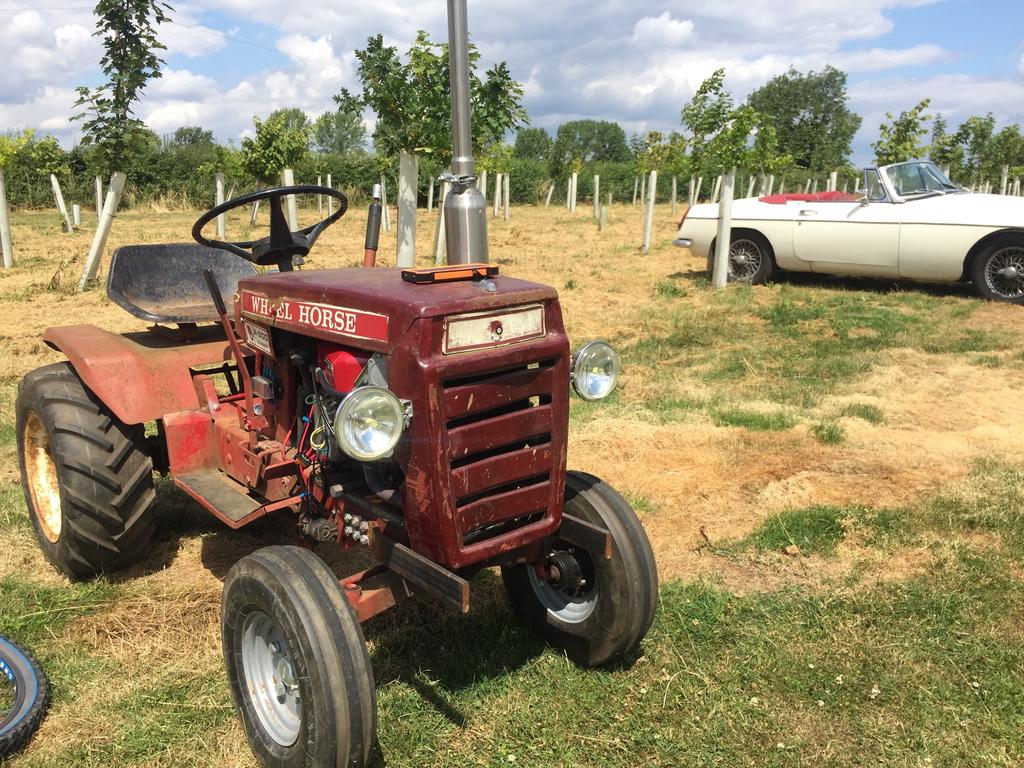

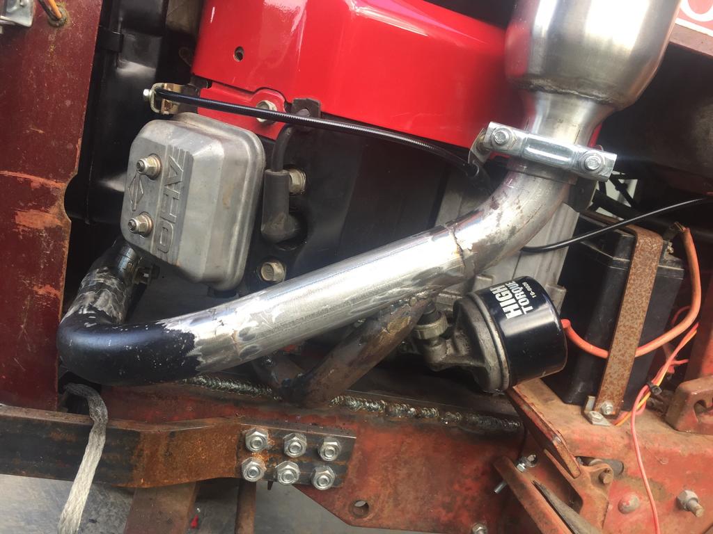

callum12 257 #191 Posted January 19, 2019 I just had a re-read of the thread and actually a little bit has happened since I last updated (I was really disheartened about the whole picture thing ) As was always the plan, an 8 speed came up and i was able to install that so i now have high and low range! this required a lever to be made up and adjustments of the brake setup, all in a weekend's work though. the biggest change is the new engine! i'm sure i did a post about this somewhere. I was able to find a briggs V twin, a little bit of cutting and welding was required. I took the opportunity weld a 10mm thick steel plate the the top of the chassis to mount the engine (she's a bit heavier now!) the new engine is fantastic, starts perfectly, powerful, governor works, the lot! the old engine was such a faff all the time, I never did get it to start and run well, it was one or the other! Callum 1 Share this post Link to post Share on other sites
Pullstart 71,153 #192 Posted January 20, 2019 (edited) Here is @callum12‘s Agri-800 as it sits, it sure looks tough! I’ve urged him to become a member for unlimited picture posting abilities, but couldn’t stand letting the build history of this creation be lost to the hands of a greedy photo sharing site. I was bidding on a vertical shaft A-80-R locally on Thursday, but someone saw way more value in it than I, but I’ve got a 13 or 14 horse Briggs that I thought would make a fun mower. That’s what got me searching for A-800 details and how I found Callum’s build. I'll just Keep my eyes open for another some day... Edited January 20, 2019 by pullstart 2 Share this post Link to post Share on other sites

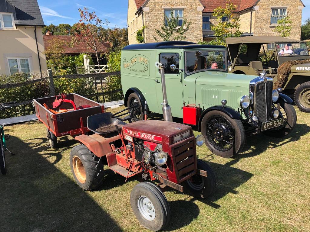

callum12 257 #197 Posted January 19, 2020 Hello all!! so the horse has been roaming around recently, she's been at a mates house putting in full days work hauling, ploughing and general tomfoolery! everything has been working great, I've routed the belt differently and now the clutch action is very smooth and progressive but doesn't seem to slip. I picked up a great saxon industries tipping trailer that suits the horse really well. for now, here's a video of the briggs twin and exhaust, this video is actually quite old but don't think i ever posted it on this thread. I'm currently compiling a video (or series) that should cover the project as best i can from start to finish, this should fill in those that missed all the pictures during the summer i'll be getting to some shows and definitely getting lots of use out of it! many thanks, Callum 1 Share this post Link to post Share on other sites
callum12 257 #198 Posted January 19, 2020 At a local car show with the saxon industries trailer! it made quite the stir actually haha 3 Share this post Link to post Share on other sites
