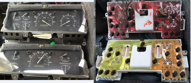

persof 14 #1 Posted January 24, 2015 Guys, I have a 1993 F150, 302 V8 , 2WD pickup truck. It has the standard instrument cluster without a tachometer. I found a 1993 instrument cluster with a tachometer is a junk yard for $50 and thought I might install it into my truck but the connectors are different. Is there a detailed wiring diagram that I could use to make this mod or is this a lost cause? fyi my truck is 2WD and the instrument cluster is from a 4WD. see the attached pic Thanks Francis Share this post Link to post Share on other sites

TT-(Moderator) 1,173 #3 Posted January 24, 2015 I'm sure it can be done but I would have probably went with an aftermarket tach. Since you're into it for $50, I'm sure you will be installing this new cluster in your truck. Look for the factory Ford EVTM (electrical / vacuum troubleshooting manual) for the '93 F series. Not only does the EVTM have the diagrams, it breaks them down into individual circuits and explains their function. 1 Share this post Link to post Share on other sites
KyBlue 655 #4 Posted January 26, 2015 It can be done but as others have said you're going to have some time in on the wiring to connect the circuits... part of the difference is the 4x4 cluster...has additional lights ... Share this post Link to post Share on other sites
smoreau 658 #5 Posted January 26, 2015 Also you may need to add a tach wire that the original cluster harness would not have. Share this post Link to post Share on other sites

SousaKerry 503 #8 Posted January 26, 2015 I actually tried this exact same thing once. If your cluster is from the exact same year and engine it should work, however mine wasn't but the plugs matched. What I found out is when I plugged in the new dash with the tack my charging circuit no longer worked. And subsequently my truck would die about 2 or 3 miles from the house. I did find some useful information by searching the F-150 forums and had actually traced out all the wires on the film and was going to rewire the differences but there were a few leads that I could not trace and I was getting a major headache from it. I eventually scrapped the project and sold the truck. Good luck Share this post Link to post Share on other sites
