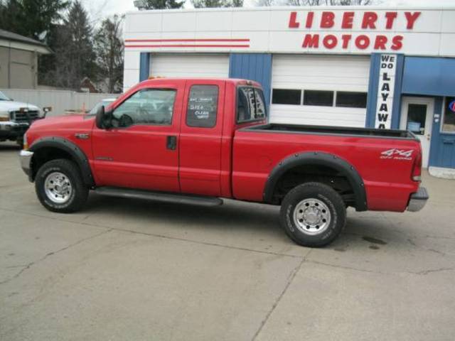

smoreau 658 #1 Posted January 8, 2015 (edited) Just picked up a 2002 F250 Super Duty 7.3 diesel 4x4 1 owner with 216456 miles.100% stock. Has a few issues, but one more thing off my Bucket list! Edited January 8, 2015 by smoreau 6 Share this post Link to post Share on other sites

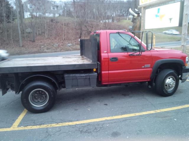

stevasaurus 23,868 #13 Posted January 8, 2015 Nice looking truck Scott, but it looks like you will need a trailer for the picnic table. Share this post Link to post Share on other sites
smoreau 658 #14 Posted January 9, 2015 Nice looking truck Scott, but it looks like you will need a trailer for the picnic table. Now Steve, Don't you remember that I unloaded it from the back of the truck. It was made to fit in a 6' pickup Box. Well last night I intentually left the block heater unpluged to see how the glow plugs were, well it started right up with no problems! It was around 0 deg with a wind chill around -20, Too cold for a week glowplug system for sure. Oil leak has me consurned a little as it's also too cold to clean off the engine and find it. I have put on 200 miles on it the last 3 days and its a pleasure to drive something with all that power when its needed! I'm iterested in the fuel milage, but in winter its not so great with wanting to warm up that jello in the crank case before driving it 2 Share this post Link to post Share on other sites
CRE1992 143 #15 Posted January 9, 2015 Now Steve, Don't you remember that I unloaded it from the back of the truck. It was made to fit in a 6' pickup Box. Well last night I intentually left the block heater unpluged to see how the glow plugs were, well it started right up with no problems! It was around 0 deg with a wind chill around -20, Too cold for a week glowplug system for sure. Oil leak has me consurned a little as it's also too cold to clean off the engine and find it. I have put on 200 miles on it the last 3 days and its a pleasure to drive something with all that power when its needed! I'm iterested in the fuel milage, but in winter its not so great with wanting to warm up that jello in the crank case before driving it Nice truck and good luck with it! As for the oil leaks, I have worked on enough of my friends 7.3L powerstrokes to tell you to look at the turbo pedestal, the high pressure oil pump, the valve covers, and the oil pan. Those are the most common places they leak, I have yet to see any of them leak from the rear main seal before the other places I mentioned. 2 Share this post Link to post Share on other sites
smoreau 658 #16 Posted January 9, 2015 Yup that's what i was thinking too. They said they did the pass valve cover. But like i said, too darn cold right now. I also have done all but a oil pan in the past as I was a mechanic. Switched to the food industry for a cleaner job, more $, and better benefits. 😃 Share this post Link to post Share on other sites

smoreau 658 #19 Posted January 12, 2015 (edited) A little warmer today and cleanded out the valley of oil and its looking like the leak is from the HPOP. Most likely from the pumps mounting gasket. Thinking of doing a complete O ring repacment on all the hoses and fittings, also installing the nonserviable plug kit. I also notied the exhaust servo in the turbo stand is wet. Turbo has a lot of lag and may need attention. So I plan on rebuilding the turbo stand exhaust brake servo and the turbo while i'm in there. Diesel O rings has it all I need for around $300. Only got 12 MPG on the last tank of diesel, but it had about 2 hours of warm ups in the morning as its been in the single digits the last few days. But I expected that in the winter. I do use the Extreme Deisel with the heat aditive and cetain boost. I have to say its a blast to drive and with a little TLC it should last for many more years to come. The power is nice to have with that big truck! Edited January 12, 2015 by smoreau 3 Share this post Link to post Share on other sites
