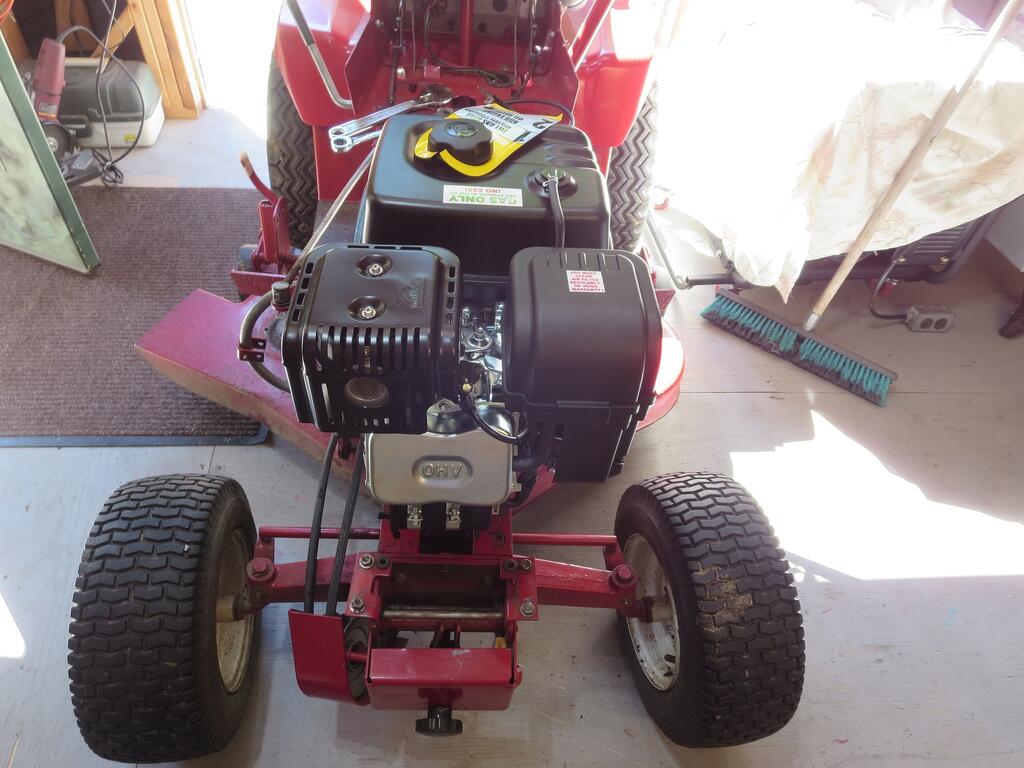

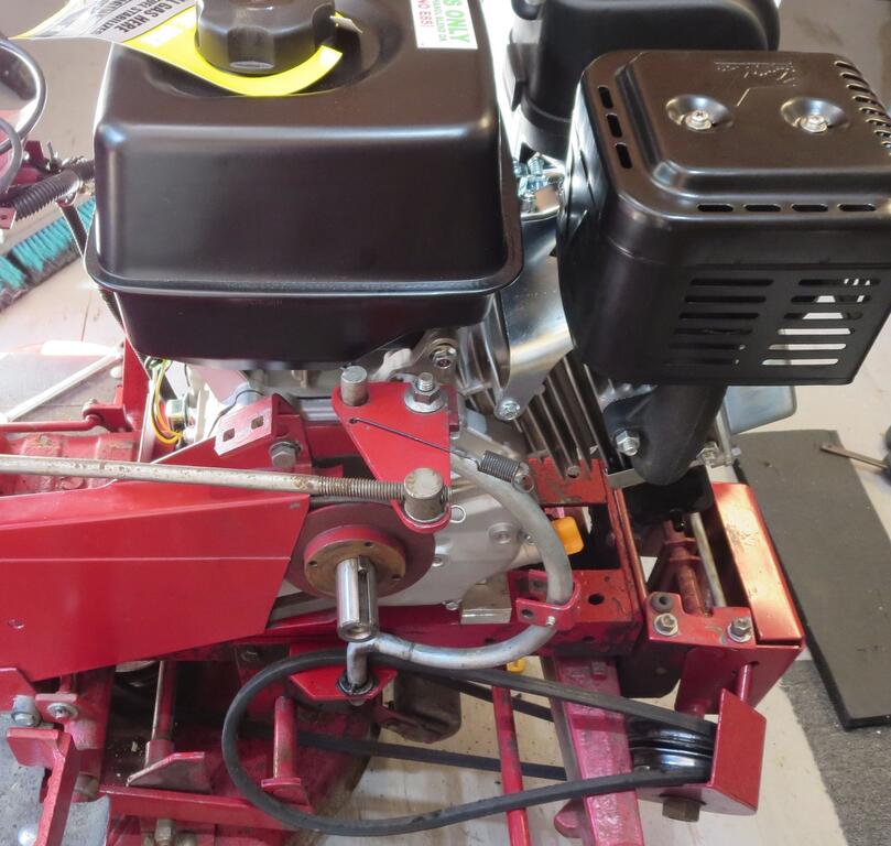

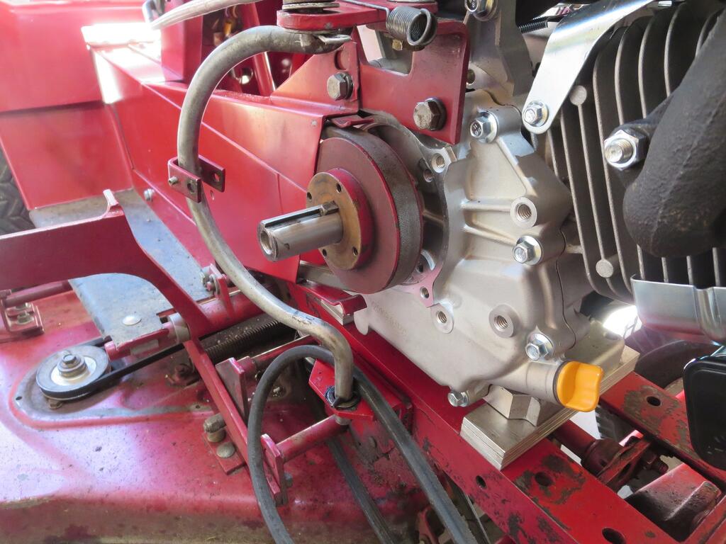

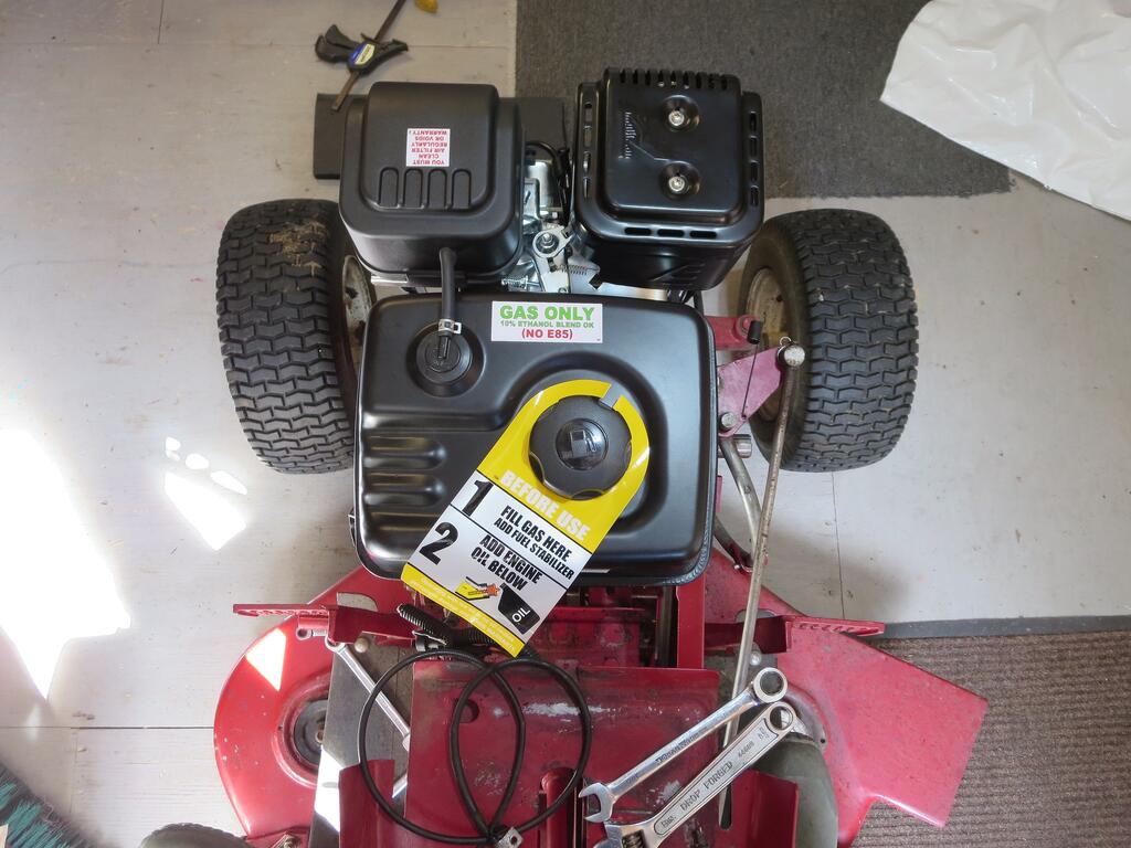

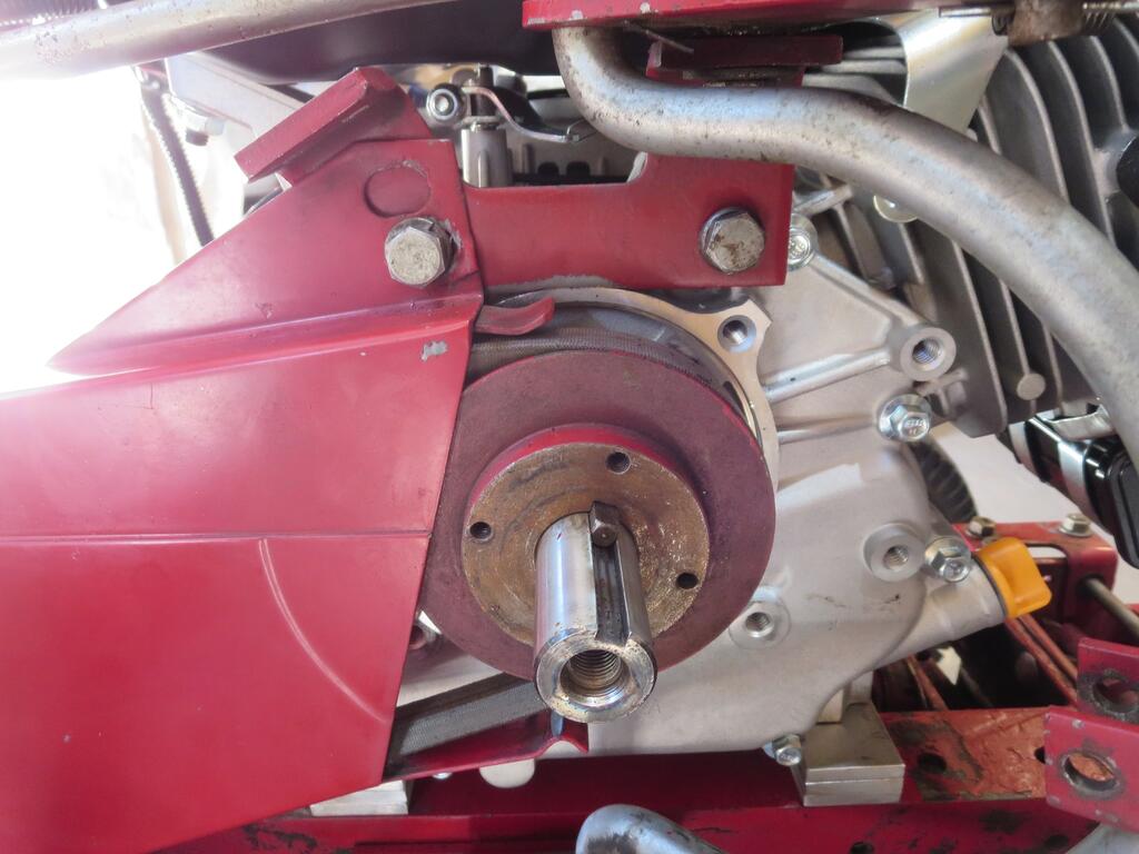

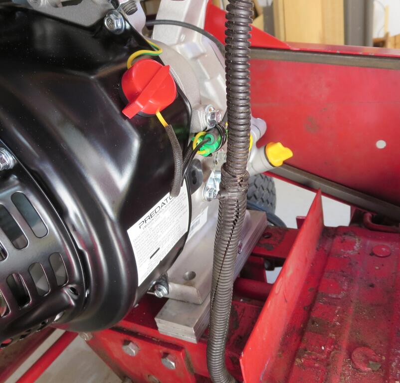

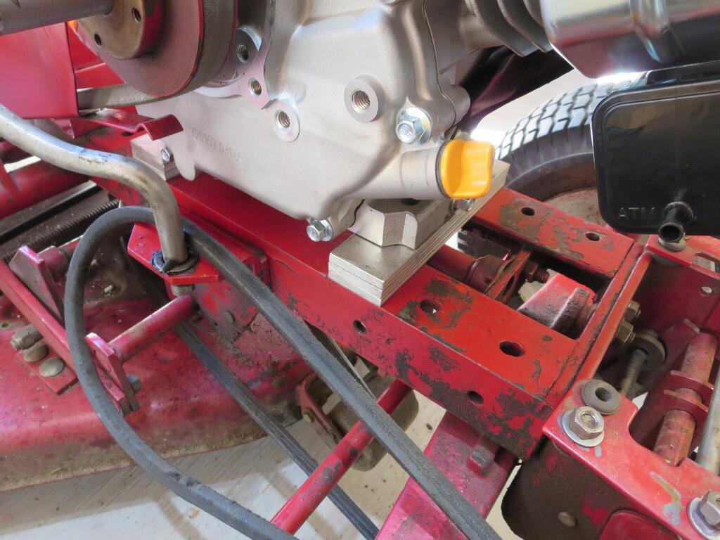

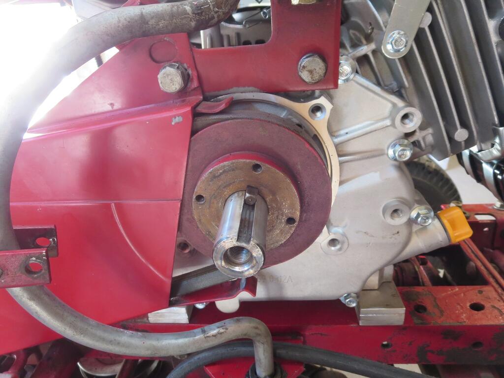

Oldarmy 113 #10 Posted September 23, 2022 So, a little more information for any who may be considering this swap. I got the engine and have begun to mock it up and see where any problem areas may be. To my great surprise this thing is about as close to a plug and play as one might ask for lol. I had to remove the original "riser plate" my name for it. I replaced it with three 1/4" x 1 1/4 " x the width of the rails and the stack gives me exactly 3/4" lift for the engine. This got the height right on the money. The bracket to mount the clutch assembly to the engine is almost dead on and bolts to the new engine in the same location with the slightest bit of grinding on the bracket in the bottom center of the bolt locations. This clears a little bit of raised casting on the engine. I have the belt in line and on the pully and it just sits in almost perfect alignment with its own weight and one bolt on the bracket holding it all. I have to finish locating and drilling the mounting holes and I may be up and running. The only thing that needs to be addressed to shut the hood is the air box needs to be replaced with something else. I see some options on the web. Some pictures to show the fitment for any interested parties. 4 Share this post Link to post Share on other sites
Oldarmy 113 #11 Posted September 30, 2022 It lives and was a pretty easy swap. I cut the grass/weeds yesterday and it was just fine. A few tweaks and she ran like a horse lol. I am going to add some spacers to raise the hood a bit at the front to make clearance and avoid changing the air box/filter and see how that works. It is much quieter than the old mill too. Share this post Link to post Share on other sites
