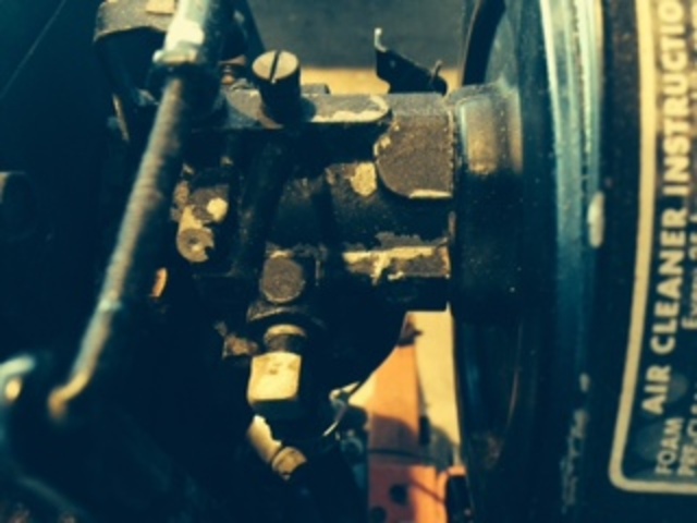

Are you getting fuel in the bowl of the carb? if not then maybe the float needs adjusting? If you are getting fuel to the bowl then there could be a blockage in the carb. What brand of carb is it? Kohler, Carter or Wallbro?
oliver2-44
The best I can tell the carb is a Kohler. Looking at the parts diagrams the kohler carb float has a round hole in the middle (like mine) while the Walsbro has a "D" shaped hole in the middle of the float. Does that sound right?
