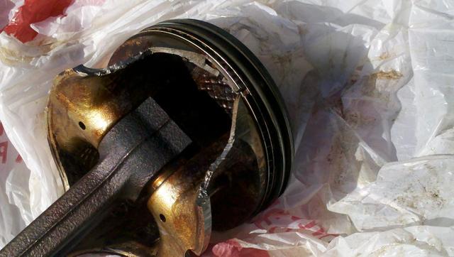

nylyon-(Admin) 9,168 #1 Posted October 27, 2014 Last winter, during one of those super cold days, I started up the Cherokee (because the diesel had gelled) and took a kid to cheer practice. On the way home I heard a really loud and bad knock. I parked the Jeep and really didn't get motivated during the summer to fix it. Well, this weekend I got it torn apart and this is what I found! I've ordered up 6 new plugs, the rest of the engine looks really, really good. No sludge, everything is clean, can tell it was maintained. Turns out that the 4.0 is NOT as bulletproof as you would be led to believe since this is a relatively common problem. 1 Share this post Link to post Share on other sites
Ed Kennell 47,802 #2 Posted October 27, 2014 No damage to the cylinder ? Maybe it is bullet proof. Share this post Link to post Share on other sites

nylyon-(Admin) 9,168 #6 Posted October 27, 2014 The cylinder is fine, no scratches at all and still has the hone marks in it. The Jeep has about 120,000 miles on it and has been well maintained mechanically. From what I am reading, this is a 1998 - 2002 issue mainly. I bought it about 8 years ago and it's had all the common issues (track bar, shocks, intake gasket whistle, radiator, heater core etc). I had hoped that it would be more robust, but as the common ailments arise, the aftermarket fixes them permanently. I spoke with a guy who had a 2001 Grand which had the same thing. He replaced the engine with a junkyard one and that one did the same thing after 10K. It's a good Cherokee but not the kind that the off-road crowd like because it has the weaker axle's, select trac and such. But for a street driven Jeep it's perfect because the select-trac has full time 4wd which is perfect for this time of year with leaf slippery roads and the heated leather to keep the touchy warm in the winter. I had contemplated replacing it with something else, but it'll cost less to repair and who knows what I would inherit from someone else. Share this post Link to post Share on other sites

stevasaurus 23,880 #9 Posted October 28, 2014 (edited) You going to replace all the pistons Karl?? Good call on the Jeep before the Horse. Edited October 28, 2014 by stevasaurus Share this post Link to post Share on other sites
nylyon-(Admin) 9,168 #10 Posted October 28, 2014 I was originally going to replace just one, but I'm really getting too old to jerk with this stuff, so they're all getting replaced. The rod bearing looked NEW, I've never seen one in such nice condition. I think that it's going to last a long time with 6 new pistons. 2 Share this post Link to post Share on other sites

Coadster32 793 #15 Posted November 4, 2014 Surprised that no other damage happened considering the picture. I agree and good call on replacing all of them while it's apart. I'm sure others would help you out,..but everyone up your way is over @ Steve's building a barn. 2 Share this post Link to post Share on other sites
