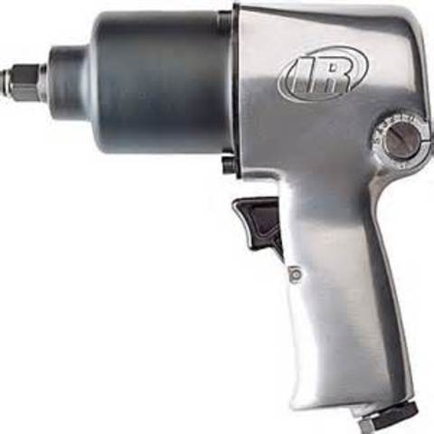

squonk 47,454 #2 Posted September 11, 2014 (edited) Lots of variables on torques and guns but for all around work I like my Ingersoll- Rand IR231. Edited September 11, 2014 by squonk 1 Share this post Link to post Share on other sites

smoreau 658 #7 Posted September 12, 2014 As I am a mechanic, I have tried about every brand there is and I always go back to a IR titanium plastic handle gun. 1000 FP in rev at 90 psi and it's very light but heavy on the pocket book at over $400. For the normal Shade tree mechanic squonk has above pictured is very good. Not a fan of snap on or craftsman guns. Stick with a IR!!! 2 Share this post Link to post Share on other sites

Forest Road 595 #14 Posted September 14, 2014 I've had an IR 231 for years. It's def the old standby go to gun. How big an air tank does your compressor have? For home use I run a Makita job site 6 gallon 6cfm @ 90psi. I found an old 20 gallon tank to ad on. With the two hooked up its great for breaking stuff loose. No good for continuous use. Just a matter of waiting for the unit to fill both tanks and then I'm on my way. Share this post Link to post Share on other sites

mattd860 163 #17 Posted September 15, 2014 Thanks to everyone for their help!! I have a 100gal compressor with cast iron pump that came from an autobody shop so it can more than handle anything. I'm on the fence between the 231C and the 2135TiMAX. Share this post Link to post Share on other sites
Geno 1,931 #18 Posted September 16, 2014 Well this one is easy. The 2135 has over twice the torque and is made in USA, the 231 has half and made in China. Share this post Link to post Share on other sites
Forest Road 595 #19 Posted September 16, 2014 Depends on what you have to spend. 231 can be had for about $100 new. With your air supply it won't matter which gun you choose. Share this post Link to post Share on other sites

mattd860 163 #25 Posted October 4, 2014 (edited) So i stumbled over an IR 231TL-2 1/2" impact wrench today at a local farm show. Guy wanted 35 bucks but I picked it up for $20. I got home and was horrified after reading the specifications online because the product description states that it only has forward torque and the rating is 35-50lbs which is deplorable. I doubted that this meaty 1/2" impact wrench could only have 50 ft-lbs so I tried to remove a rusty old lug nut on my old ford truck and it zinged it right off with no effort! So it seems good to me. Can anyone find out the actual specs of this gun? It says forward torque only and 30-50 ft-lbs but it removed that lug nut easily in the REVERSE. I tried finding some more specs on the first 10 pages on google search but there seems to be very little info out there on this model. EDIT - it's a 231TL, not a 213TL Edited October 4, 2014 by mattd860 Share this post Link to post Share on other sites
