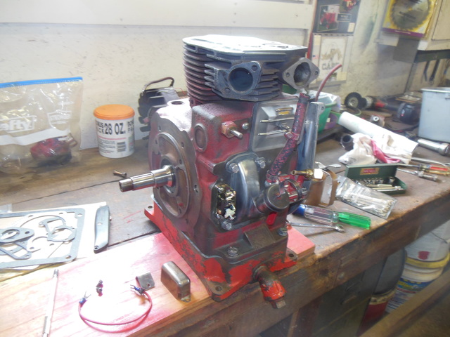

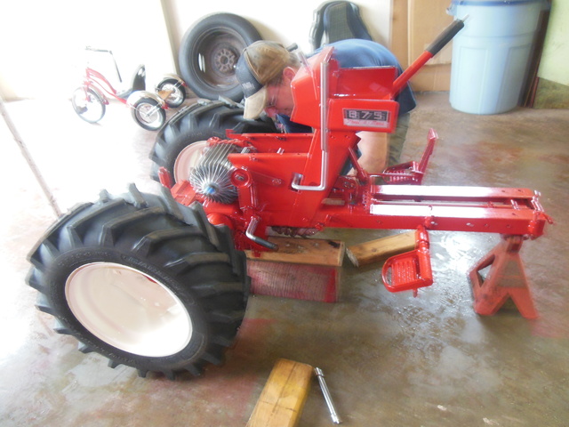

PeacemakerJack 11,080 #51 Posted July 22, 2016 THE RESTO: My dad always worked The Iron Horse really hard but he took care of it just as religiously. The oil was changed every year, sometimes more often if needed. The hyrdo fluid was changed on a regular schedule. Every zerk got some grease every time we used the tractor whether it needed it or not! The hydro fan screen was cleaned of debris after every lawn mowing. This tractor received great maintenance from 1975 through today and it shows. Take a look at these 50 year old front end parts! The pivot pin and spindles are in good condition even after all these years and hours. The steering gear is fairly worn but still in amazing shape after how many turns that it has gone through. The front rims aren't in bad shape and so we elected to use a stripping wheel and a buffer to strip off the old paint. Dad is sending the rear rims to be sandblasted but since the front wheel bearings are still in great shape, we didn't want to chance getting sand in them. They look almost custom, like puller rims, with all the paint stripped off. We of course want to create that "little tractor" look and so the tires that have been on it since it left the factory in 1965 will now be relived of duty... We looked at several different styles but liked these the best to achieve the look we were going for (The original tire is on the right of course!) Dad is going to keep one of the originals to display on the wall. Although you cant tell it in these pics, the originals had a lot of dry cracking and checking... Something tells me that these new tires aren't likely to last as long as the originals even with far less use. I'm not convinced that the new rubber compounds are as durable and longlasting as the old stuff.Dad also decided to start prepping the hood too. A couple of things to note about this hood. First, you'll notice the bondo where dad brased the holes shut that he put in about 25 years ago for the headlights. Wait till you see the picture of this thing with my brother on it in about 1995 with those big ugly fog lights hanging off the sides of the hood! Next, if you are very familiar with this series of WH you'll notice that dad's hood bulges out on both sides quite a bit. That was done in about 1978 to accomodate the new K301 which repowered the Horse after removing the tired old 8hp. The 12 was a much bigger engine dimentionally and required several key adaptions, the hood tweaking being a key one! After dad was happy with the finish, he shot the first coat of primer to protect the metal from flashing until he was ready for final prep and paint. 6 1 Share this post Link to post Share on other sites

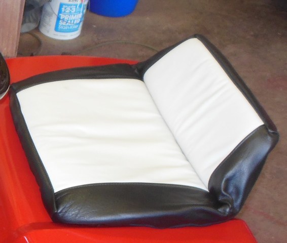

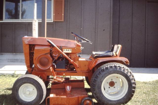

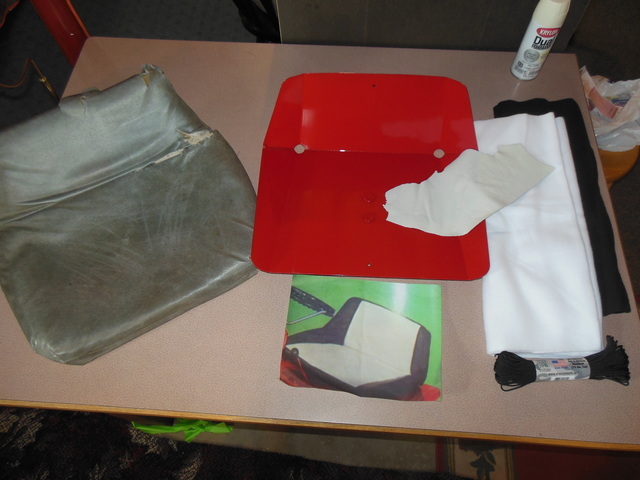

PeacemakerJack 11,080 #53 Posted July 22, 2016 Lets talk about WH seat material for a little bit. To me it seems like the original stuff was pretty prone to drying out and splitting apart. The Iron Horse was only 10 years old when dad bought it and yet the seat was already in sorry shape. The tractor had spent some time outside and the sun along with the elements had already done a job on this thing... From this angle it doesn't look too bad (Circa 1979). But same day, opposite side... I don't know if you guys have ever worn light fabric shorts while riding on a seat in that condition, but it can pinch you like a six month old baby! Mom wasn't a fan and so she set dad to the process of making a new seat cover. He got a hold of some very durable vinyl and made his own cover... This is the cover that was on it from 1980-2015. It was starting to crack and look nasty but it served its purpose well for a long time. However, It is now time to make something new. We took the old seat apart... Needless to say, the bottom of the pan wasn't looking great. I can't imagine what that would look like on a tractor that was always stored outside! We sanded it down and primed and painted it. I had bought dad a pristine condition sales brochure for the 875 for Christmas. After looking at the pictures of the original pattern, we decided to duplicate it as closely as possible. Dad is a master at fabrication of things and he decided to use a cheap fabric to make a template for the cover. Now, what to use for the actual seat material? I have a buddy who works for a major airplane manufacturer in our area. He told me that he could get his hands on scraps of premium leather that they use to cover the seats of 50 million dollar aircraft. I told him that I needed black and white. He was able to come up with the white right away but it took a couple of months to get some Black. Finally he had some for us and we are off and running. The mock up is on the right and the leather scraps on the left. We then turned the finished pattern into a local leather seamstress and they took care of the rest! It may not be a perfect original seat cover but it looks sweet and should be very suitable for the little work duty this boy will see these days! Nothing like a genuine leather saddle on a thoroughbred horse!!! 8 Share this post Link to post Share on other sites
AMC RULES 37,260 #54 Posted July 22, 2016 From our vendor list... 1 Share this post Link to post Share on other sites
PeacemakerJack 11,080 #55 Posted July 22, 2016 55 minutes ago, AMC RULES said: From our vendor list... Thank you for including this here as it will be a big help to anyone restoring one of these tractors that follows this thread. It would've been much easier and in the end cheaper to purchase the above replica. I certainly don't recommend all the work we went to but it makes a super cool "one-of-a-kind" seat. It also has a neat background story much like the rest of the tractor. 2 Share this post Link to post Share on other sites

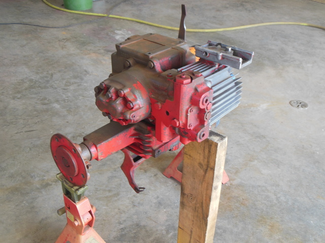

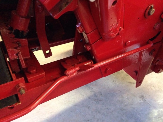

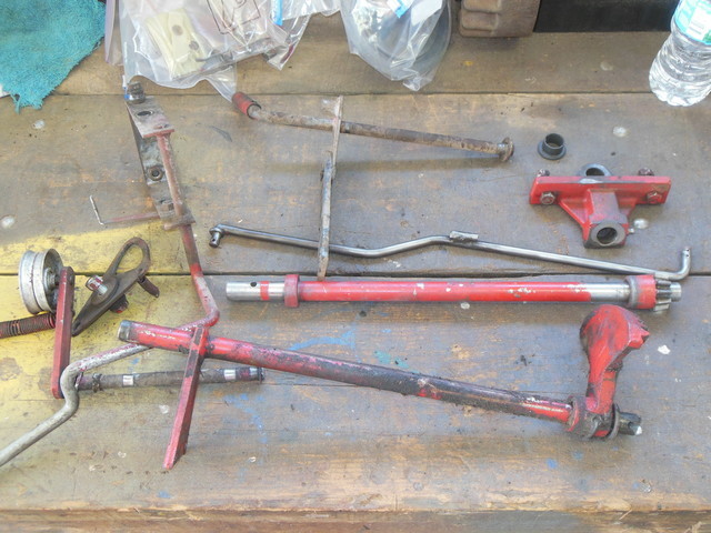

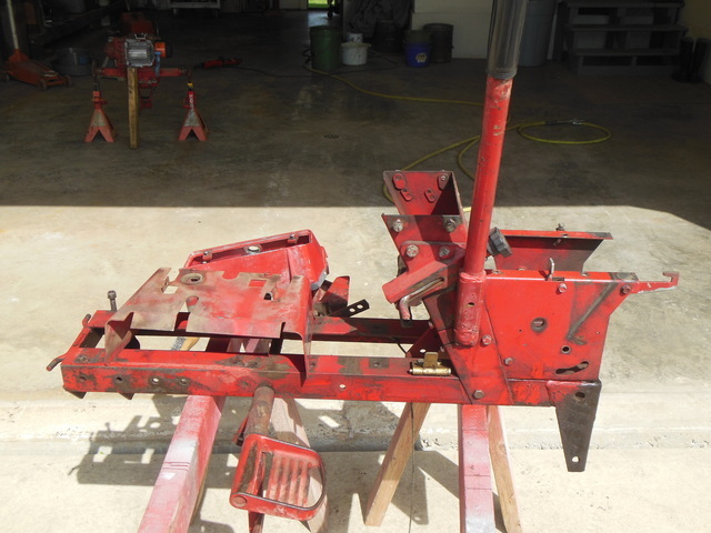

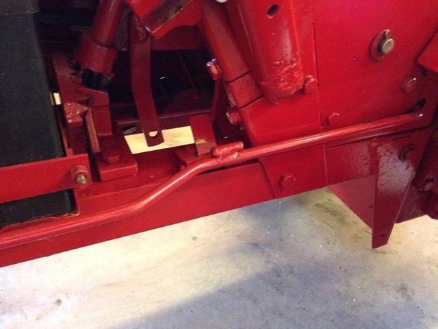

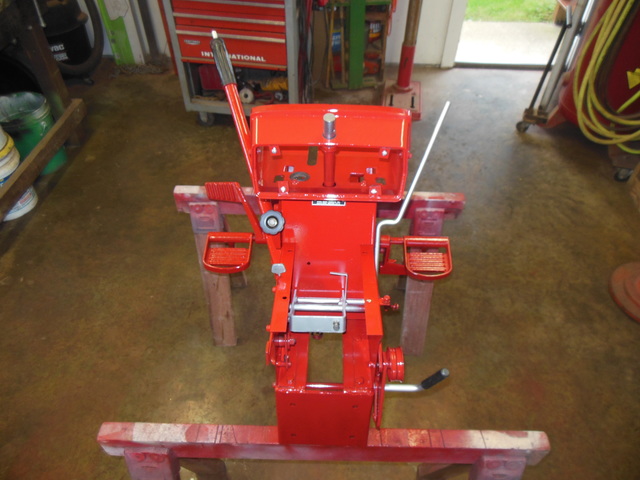

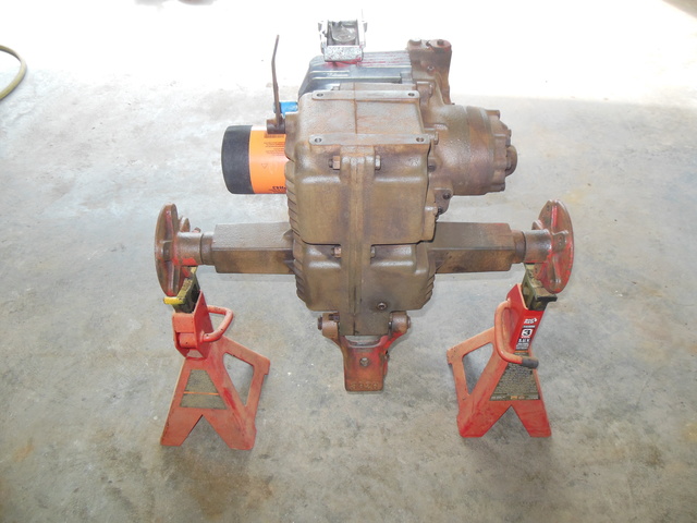

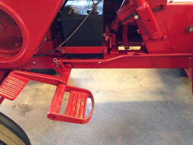

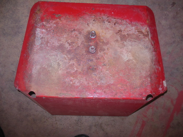

PeacemakerJack 11,080 #57 Posted July 24, 2016 THE RESTO: The disassembly continues! It is easy to pull them apart unless they are super rusty, putting them together (especially after paint) takes a little more work and precision! If you look carefully at this picture you will see something unique mounted to the frame. Anyone who has used this vintage of WH horse for any length of time know that the hydro likes to walk out of neutral fairly easy once they are worn. Dad decided to "engineer" a true "parking Brake" on his tractor. We both understand that their is a friction adjustment on these tractors but with the old parts, it seems like it doesn't last real long and then it begins to loosen. Dad noticed that the brake pedal linkage travels right next to the frame. So, he took a heavy duty hinge and modified it to have one "finger" that tilts out until it touches the brake linkage rod. Them we pushed the pedal all the way down and marked the rod where the finger was located. Dad then took a small piece of rod and welded it to the linkage rod in the proper orientation. This way, you press the brake pedal down, then flip the finger out to rest behind the stop on the rod. It is a positive parking brake that works like a charm and is easily reached from the drivers seat. Once painted, its hardly noticeable except by the most discerning eye. THE STORY: This is out of chronological order but it fits here! It was about 1992 and I was cutting the lawn. It was one of those sticky summer days and the RD deck was spewing clippings all over me! I was about halfway finished with the lawn when I decided to run in the house and grab a drink of water. I parked the Horse right in front of the house,unlocked the throttle, and quickly ran inside leaving the 875 idling in the front yard. I was enjoying the cold fresh water when I heard dad yell from his office, "Who left the tractor running unattended?" His office was right beside the front door of the house with a large window facing that direction. He heard the tractor moving and looked up to see it idling across the front yard! I bolted for the front door and glimpsed the Iron Horse as it came to rest "nose" against the ash tree in the front yard. The tires were just clawing it the grass as I ran to the tractor and pulled back on the SR lever! It put a little dent in the front hood which dad finally removed with this restoration. This picture brings to mind another story that I am too young to remember but dad has shared several times over the years. I don't know if any of you have run into this on your tractors but I thought it was interesting enough to share here. Dad was cutting the lawn when he hit a big bump. All the sudden, the tractor began to feel very strange! It felt very strange, almost like a car that has bad shocks. It was bouncing up and down across the yard as he drove. He limped it to the garage and began his inspection. The plate in the above picture that hold the rear end to the frame broke loose! Talk about a spongy ride! Dad took everything apart as far as needed to weld it back together. Then he did the farmer thing and "beefed" it up with some extra steel and welding. It has held sound for nearly 35 years. In the above picture you can see the small piece of rod welded to the brake linkage. Lots of cleaning, sanding, and prepping for paint! 2 1 Share this post Link to post Share on other sites
PeacemakerJack 11,080 #58 Posted July 27, 2016 Here are a couple of pictures of the above positive parking brake lock... this is with the brake pedal in its relaxed position. Note the short retention Rod and the finger angled back behind it. here the brake pedal is depressed and the finger is flipped on to the brake Rod just behind the retention piece. 3 1 Share this post Link to post Share on other sites

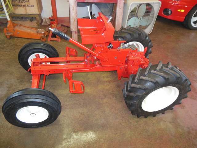

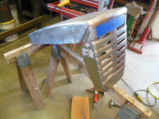

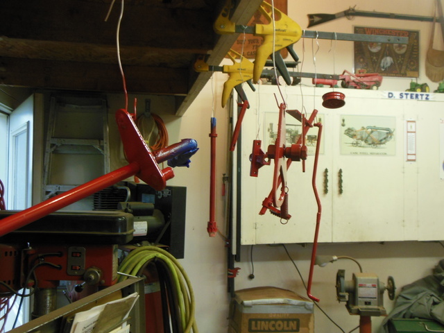

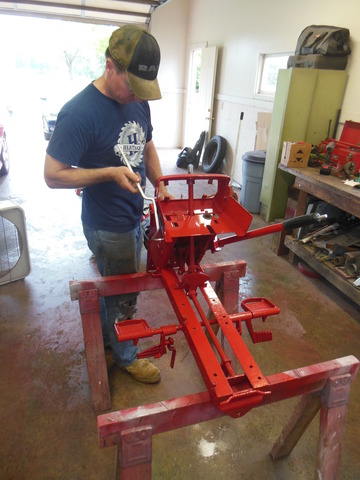

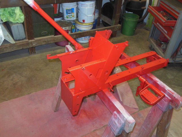

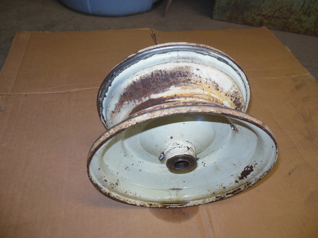

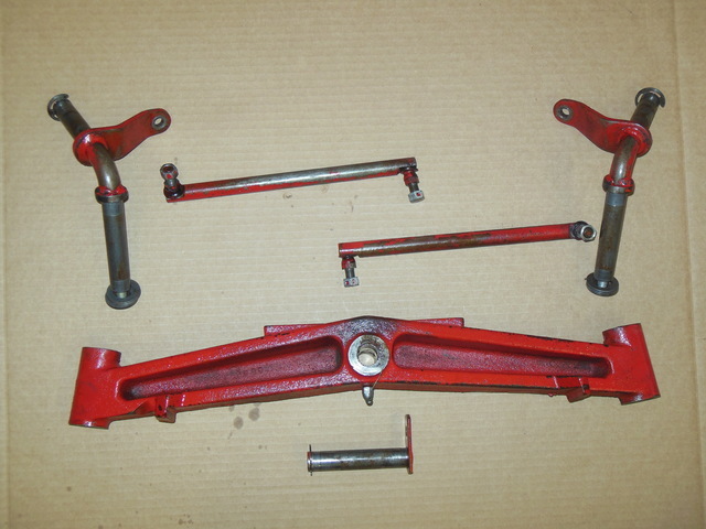

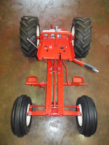

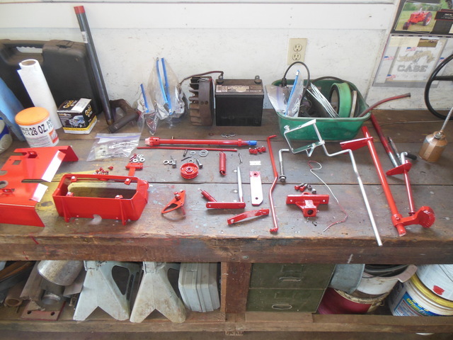

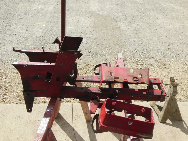

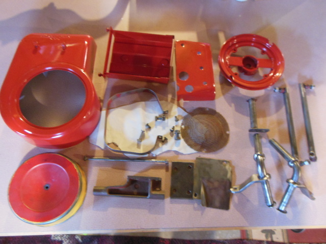

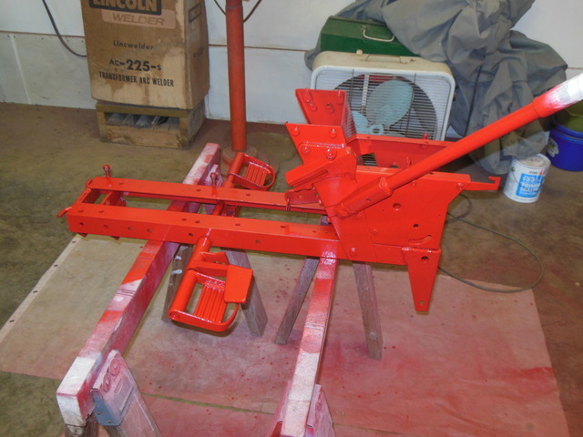

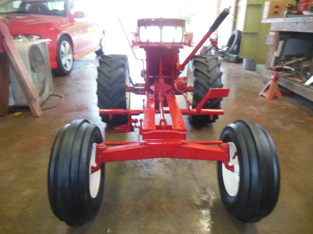

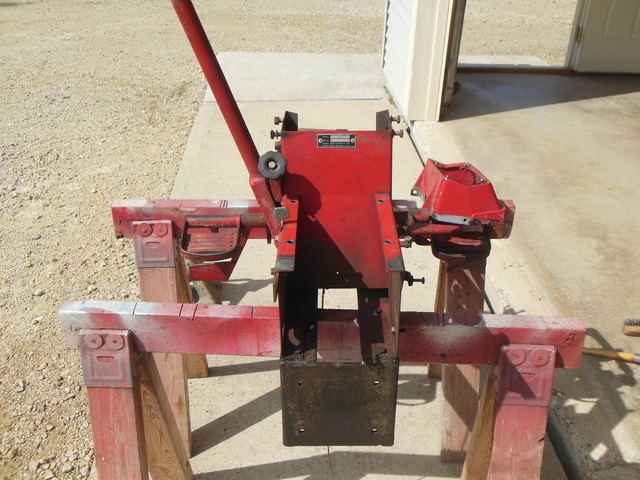

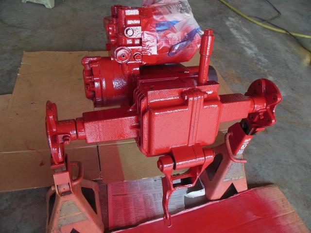

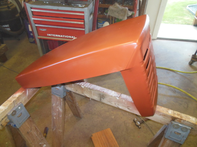

PeacemakerJack 11,080 #59 Posted August 18, 2016 The RESTO: At this point in any tractor restoration project, the formula is the same: inspect the parts for wear, decide if they need repair or replacement, then clean, prime, and paint... I wouldn't have to post these pictures but I know you guys too well {} Some of you may cry "Foul" that we didn't strip the frame further than this. However, dad and I made an executive decision at this point that we had it far enough for a tractor that had been restored about 30 years previous and had been stored inside ever since. It is always awesome when your shop begins to look like a "chop shop"--meaning that once you start hanging and painting all the detail parts it is such a good feeling. You know by this point that you are getting close to the super fun stage of any resto--THE REASSEMBLY! We went through every piece. Some items we have decided to paint red as they did it at the factory. Some of the items we opted to paint black or silver to give it a custom, detailed look. I had been watching Aldon's GT-16 resto and loved what he was doing there. We did some of the same types of things after seeing how awesome his turned out! Thanks Aldon for the inspiration! Then it is time to lay out all the parts and make sure that you have everything ready for assembly. How many times have you guys in the excitement of this phase of a resto, realized that you forgot to restore a certain key part that you needed to assemble your tractor and it held you up? Been there done that! In this photo you can see the borrowed cub air cleaner that dad got in 1978 from the parts bin at the IH dealer along with some others... Boy--This is a B-E-A-UTIFUL sight! Isn't that fresh Valspar IH red sharp when it is glossy and fresh? Assembly continues.... 6 1 Share this post Link to post Share on other sites
Racinbob 13,250 #60 Posted August 18, 2016 Looks great!! I'm a big fan of highlighting parts with a different color. 3 Share this post Link to post Share on other sites

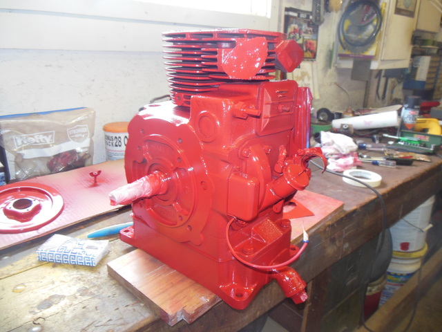

PeacemakerJack 11,080 #62 Posted August 18, 2016 The STORY: About 1979, the old 8hp was really tired and my dad's oldest brother Bob came across a new K301 stationary motor for a super good price. Dad decided that it was rebuild the old 8hp or repower with a brand new 12hp. The K301 seemed to be a no brainer to a man in a family where bigger is always better! If 10hp is good, 16hp is better or so goes the thinking. Dad took one long look at the Iron Horse and thought that a fresh set of new "clothes" would look good to go with the heart transplant. The nice thing was that he still worked at Chief Equipment in 1978 and they had all the equipment to paint. Dad did all the work for that resto at Chief. Try as I might, I can't find any pictures or slides of it being worked on while there. That would be really cool if there were but alas, it isn't to be. I'm glad as many pictures exist of it as we do have... As any of you know who have studied the short frame tractors, there are a lot of subtle differences between the early small engine models and the later 12hp models. It wasn't a simple bolt in procedure. (It was super fun to show Dad's tractor next to Achto's 1076 this summer! We looked at many of those differences side by side. I must say here that the quality of Achto's tractor is even more amazing in person than it is in pictures!) Dad welded Studs to the frame to accomodate the wider engine pan bolt pattern. As previously stated, he ad to widen the contours of the hood on both sides to clear the engine. He had to fabricate his own S/G bracket to work with the width of the motor and make a hood bracket to raise the front of the hood for clearance. What he didn't do which would have taken a ton of work to make or finding a parts tractor to rob from, was a taller dash tower. (If I can ever make it to the end of this thread and the official "unveiling", I would like Achto to post some of his good quality pictures of his tractor next to dad's that he took at Symco for observation of the factory versus the Don Stertz fabrication! Not yet though!) Another thing dad had to deal with was the drive belt shield which was now too low and close to the wider engine. I know that im forgetting some of the other items that dad had to do but that gives you a good idea of the work that went into it! Dad used an acrylic enamel IH red that the were spraying on the big tractors there at Chief. A few pics of the dealership back then... Dad setting up the "new" 815 IH combine! Driving the beast! So, dad mixed up and shot the paint on his "horse" after all the fabrication and prep was finished. I'm not sure what was mixed wrong or if it was just the conditions but dad said it took nearly three days for everything to dry well enough to be handled! It was a super glossy finish though and turned out beautiful IMHO... He even took the time to paint the deck! Speaking of the deck, O great WH gurus---HELP! Would that deck have originally come on that tractor? All the pics that I see of 875's the deck is more rounded. I only ever see this deck on older WH tractors. This is of course the picture that I use for my Avatar. My interest and love affair with these little red tractors grows more with everyone that I work on and even see. However, for obvious reasons, this will always be my favorite! Zoom in on these pics and you will notice some of the changes that I shared above. By this point the factory throttle wasn't holding and dad replaced it with a chrome aftermarket T handle that is still on it today. The above mentioned IH Cub muffler made its way on to the tractor at this time and still resides there today. The front spindle dust covers were still on the tractor at this time. Those were unfortunately lost somewhere along the journey over the next 30 plus years. My dad is my greatest earthly hero for reasons too numerous to share here, however even as an adult he amazes me with: his tenacity to finish a project with excellence, his awesome fabrication skills, and his ability to take a problem situation and turn it into a success! HERE'S TO DAD! 7 1 Share this post Link to post Share on other sites

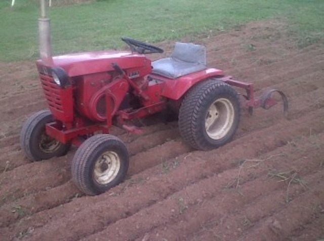

PeacemakerJack 11,080 #65 Posted December 5, 2016 (edited) Well after a few month hiatus, time for another installment: The STORY: After dad finished the first 'resto' on the 875 it was pressed right back into duty. As I've said numerous times in this thread, dad was and is a stickler for maintenance of his stuff however he isn't afraid to use it. The horse was used for mowing, gardening and playing... This was a family tradition back in those days. Dad would tie the radio flyer wagon to the back of the tractor and then take me and mom on rides around the yard. It was really a lot of fun and is probably the reason today that i let my kids drive their GT's around the yard when they are old enough and give rides to the little ones. Do I look right at home in that drivers seat or what? My work boots, Oshkosh B'Gosh bibs, and engineer hat You can see from these pictures that this tractor was used. My parents always put a premium on family time. They still do to this day. As I write this post, they have my two oldest children with them on a short vacation trip. The kids are having a blast! I hope and pray that I am doing the same for my own children and someday for their kids too! The RESTO: The engine was next. Dad has the expertise to completely rebuild one of these but because of his now very busy work schedule, he elected to have it rebuilt for him. A shop about 25 miles away did all the machining and internal work... We did everything else! As always, its great to see the paint go on the key parts. Because dad had overhauled this rear end in the not so distant past and it wasn't showing any signs of leaking or issues, we elected to strip it down... clean it well... and paint it up pretty! Finally getting close to the serious assembly! Edited December 5, 2016 by PeacemakerJack 4 1 Share this post Link to post Share on other sites
