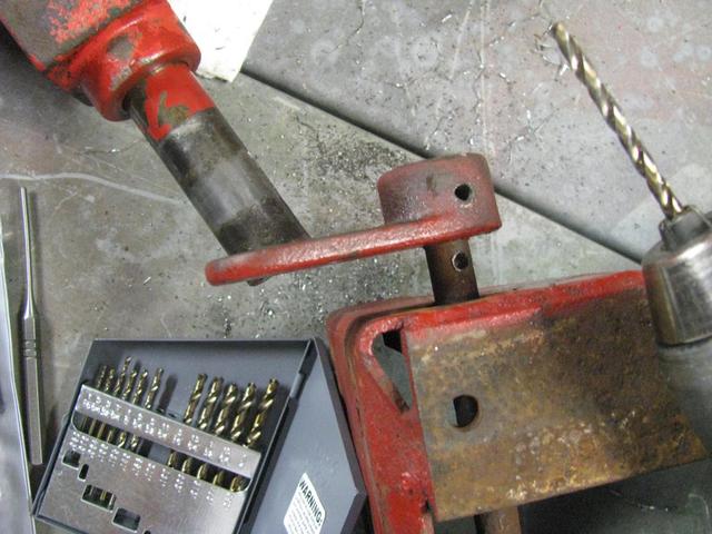

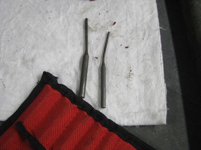

AMC RULES 37,256 #1 Posted August 26, 2014 (edited) When buying cheap tools...is it just a matter of time before this happens? Wondering if buying my next set of roll pin drivers from Matco, Snap-On, or Blue Point help to prevent this form occuring again? $16.00 vs. $80.00? Edited August 26, 2014 by AMC RULES Share this post Link to post Share on other sites

Martin 2,133 #5 Posted August 26, 2014 Craig, you can buy the good stuff and it will do the job fine and probably last forever if you treat them right. heres something that I've had success with. search for any tool surplus stores nearby. i have one close that the owner buys lots of tools from the local arsenal when they have past there useable life or they retool for some reason. usually there is nothing wrong with most of them and you can pick up some very nice professionally made tooling very cheap. i buy odd taps, reamers, bits etc and have managed to find quite a few punches and drifts for the sort of thing you are having problems with. i also have a nice older craftsman punch set that is still in excellent condition that i have looked after and not abused. the quality of the material the tool is made from is important. sometimes starting to remove a pin like you are doing is better with a shorter punch to jolt it loose and then use a longer one to remove it. the longer thin ones tend to bend or bow when they are beat hard. Jims idea has worked for me in the past too. sometimes you just know after the first blow that it aint going to come out and you need to drill it out of there!!!!! 3 Share this post Link to post Share on other sites

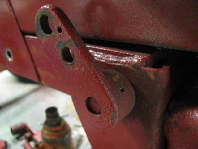

Ed Kennell 45,863 #8 Posted August 26, 2014 Are you sure the pin has not sheared and the holes are no longer aligned. On the Raider clutch I just repaired, I could see some movement between the shaft and lever when I applied torque, so I knew the pin had sheared even though there was enough friction to operate the clutch. So I had to tap the shaft out, then remove the three pcs of pin. When I put it back together, I added a set screw and a second pin. This placing of the pin near the OD of the shaft increases the shear area and the strength 2-4 X 4 Share this post Link to post Share on other sites
squonk 46,244 #9 Posted August 26, 2014 (edited) I bet Ed is right about that pin being sheared. That puny pin would have a tough time bending even a cheapie punch. Or that roll pin could be bent in a sorta Z shape. When I replace the steering roll pins in my 704 I found that in the spindles. I was drilling them out for bigger pins anyway so it didn't matter. Edited August 26, 2014 by squonk 1 Share this post Link to post Share on other sites
AMC RULES 37,256 #10 Posted August 26, 2014 I'll check it again, but I can clearly see both ends of the pin... and there's absolutely no play in the lever. But you're right, sure didn't feel like it was pushing on the pin. Share this post Link to post Share on other sites
squonk 46,244 #11 Posted August 26, 2014 You will see both ends. Even if it's bent. and there won't be play in it unless you can really put a load on the shaft and load the arm in an opposite direction. Drill out the pin ends and get the arm off. redrill the shaft if you have to. those pins normally drill easy. Share this post Link to post Share on other sites
AMC RULES 37,256 #12 Posted August 26, 2014 Everytime I've tried drilling out a roll pin... it breaks the bit. Share this post Link to post Share on other sites

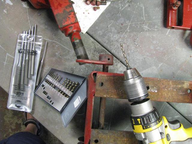

AMC RULES 37,256 #19 Posted August 26, 2014 Yep, someone has been in there before me, doing a 20ft rattle can job at some point it's past. The other end of the shaft, I believe is welded to the idler pulley bracket. I'm this close to cutting in half, but a new American made punch set is already on it's way... patience is the key here, lot's of good ideas presented here that I'd like to give a try first. I'll let you know ultimately, what ends up working for me. 1 Share this post Link to post Share on other sites

shorts 182 #24 Posted August 30, 2014 I have a complete set of professional grade tools, mostly Snap on, But when it comes to punches and chisels its hard to beat farmer tested and proven Craftsman tools, they are just about the best ones on the market. I've also been known to modify punches and chisels to do a particular job and then replace it with a new unmolested tool to fill out the set or in the case of harbor freight punches buy several sets with the understanding that they will be sacrificed/modified to the project gods. The previous posts to use a stubby or tapered punch to start the roll pin is good advice, also it is usually best to progress to a large hammer and hit with a properly sized punch if you don't get any pin movement after 1 or 2 light taps 1 Share this post Link to post Share on other sites
AMC RULES 37,256 #25 Posted August 31, 2014 (edited) So, just to update...I finally got my clutch lever off today. Got a set of cobalt bits, and drilled out the pin with a bit two sizes larger. I actually heard the pin laugh at the one size smaller, and actual size bits...absolutely was not happening, period. It wasn't until I threw caution to the wind and grabbed the next larger 11/64th bit, that I actually began removing any material. Don't know what makes rolled pins so strong, but they definitely seem pretty determined to stay in there. Edited August 31, 2014 by AMC RULES Share this post Link to post Share on other sites
