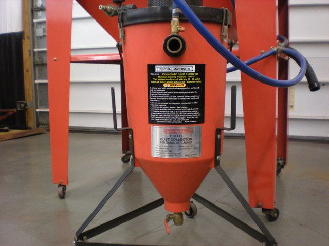

Geno 1,932 #15 Posted August 25, 2014 (edited) I have a large HF one with the doors on each end, wheels on it, and the vac made for it. I've used it a lot for 20 years and it still works great. The blaster is a Central Pneumatic 47603 and the dust collector is a Central Machinery 02448. Well I just looked on HF and it looks like they don't have these anymore. You may search the numbers and find them somewhere else though. Edited August 25, 2014 by Geno 3 Share this post Link to post Share on other sites

moltobennyg 0 #19 Posted February 3, 2019 , are you still on this forum ...I have some questions about your dust collector , I need help concerning the central machinery P 2448 , Im puzzled about setup , n cant find help or manual thanxz Ben Share this post Link to post Share on other sites
