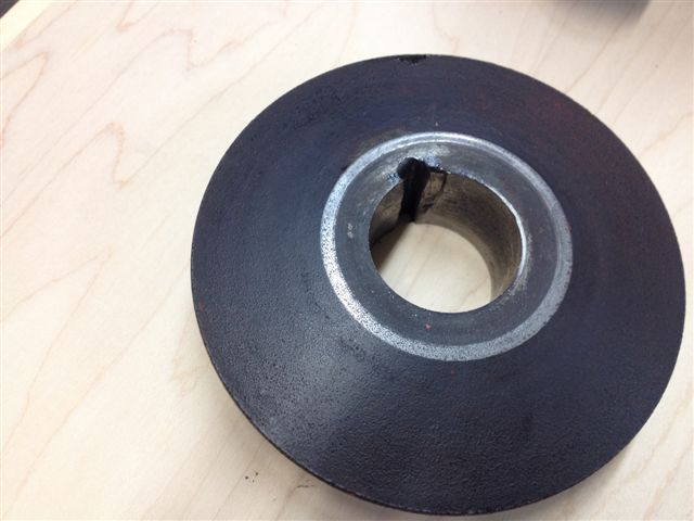

formariz
Vin
How close to the vari-speed pulley should the guard on the 56 be? Mine is very close and looks like pulley rubbed on it quite a bit sometime in the past.
Also my adjusting rod has a couple of gentle bends to it. Perhaps the best thing is to straighten it?
I also should of read instructions prior to greasing that pulley. Did it sparingly anyway but i see that there is the great possibility of contaminating belts. Any suggestions on that? Greasing it seems to become problematic sooner or later.
Edited by formariz

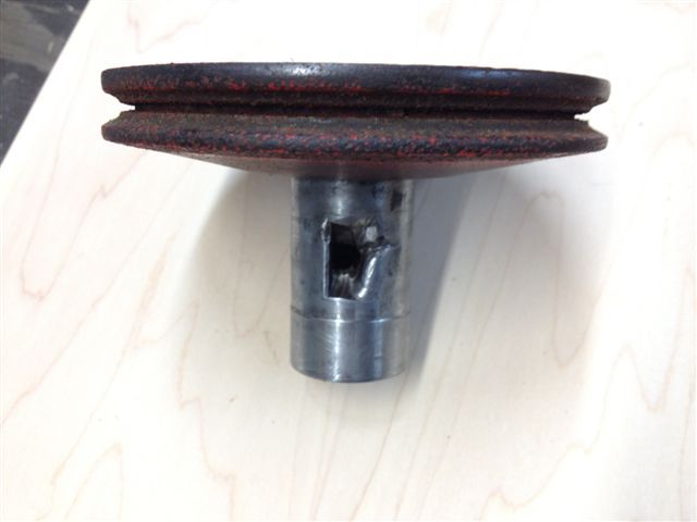

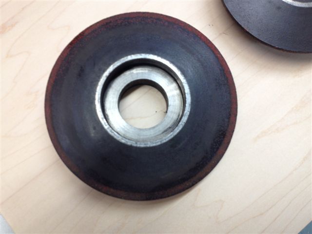

formariz
So, upon viewing video a couple of times particularly at the end when Vin shows the vari drives apart, i realized that something was not right with mine since center part rotated when it should not. Attached are photos of what I found. Seems like wodruff key was swallowed up sometime ago. Sleeve also has a considerable amount of wear most likely from center section rotating.
As per Vin seems like another key could be recut on other side? There is also a bit of damage to keyway in center section.
Edited by formariz
VinsRJ
As for the grease issue... its gets everywhere.... thats why if you are going to ride the tractor... restoring it is not in the cards, at least for me. Just add enough grease to lube everything up.
It looks like you will have to cut a new woodruff key slot in the center and cut a new key way in the chive. I have done this a number of times without issue. You can weld up the old woodruff key slot and grind it down, that way grease does not migrate out.
In full nuetral the veri-drive may sit on the belt guard but when running it should not be touching... you will have to play with the adjustment rod and even the belt sizes to work out the bugs.... they're not Swiss watches, LOL!
