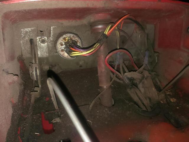

r356c 375 #11 Posted June 17, 2014 (edited) Nice work Martin! Kudzu3, that thread is better than any explanation I can give! In the months to come I will be revisiting it myself. This got me to pull my gas tank to take a better look. It was a good thing since a couple of wires were rubbing on the steering column where the shiny rings are. That would have been trouble sooner or later. It looks like I have some some detail cleaning to do. Edited June 17, 2014 by r356c Share this post Link to post Share on other sites
