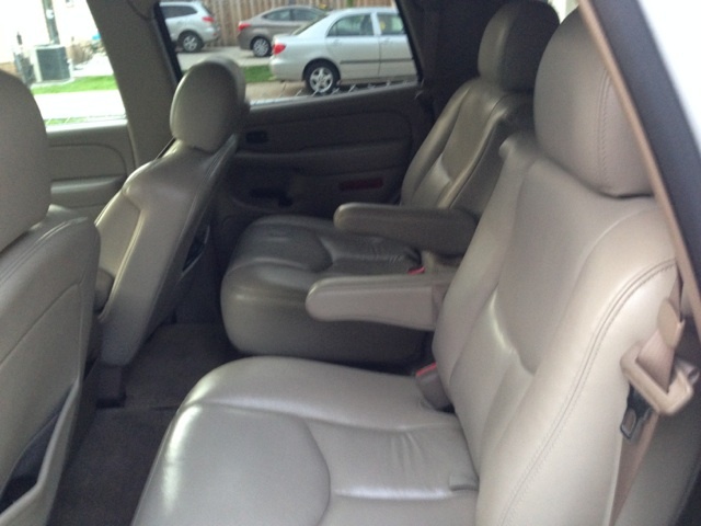

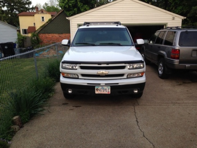

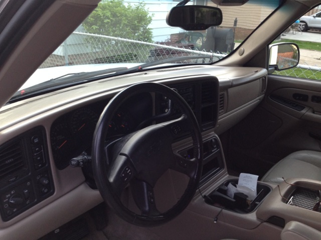

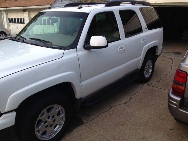

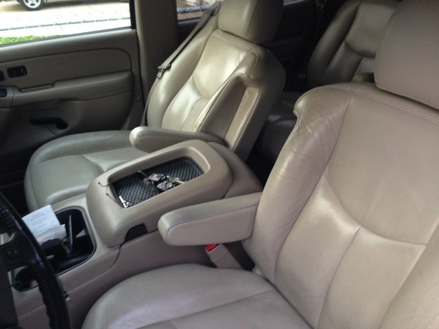

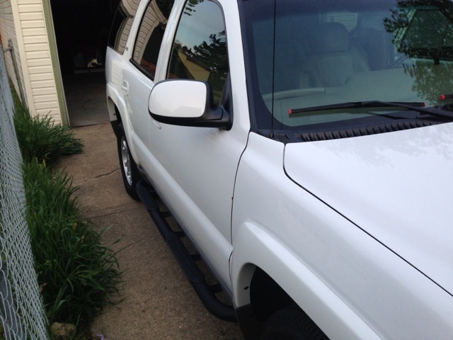

RMCIII 840 #12 Posted May 20, 2014 Update. Got the tahoe home. Had enough time to do a decent wash and started to do a complete detail. Still needs carpets cleaned, exterior rubbed, then polised, then sealed. But judging by the way it is looking now, it should clean up fairly nice. Share this post Link to post Share on other sites
stevebo-(Moderator) 8,630 #13 Posted May 20, 2014 Now I really miss mine! Mine was white with grey leather yours looks tan. You are going to love that Tahoe! 1 Share this post Link to post Share on other sites
Martin 2,134 #14 Posted May 20, 2014 wow, thats in very nice condition. great find and looks like its been well cared for....... 1 Share this post Link to post Share on other sites

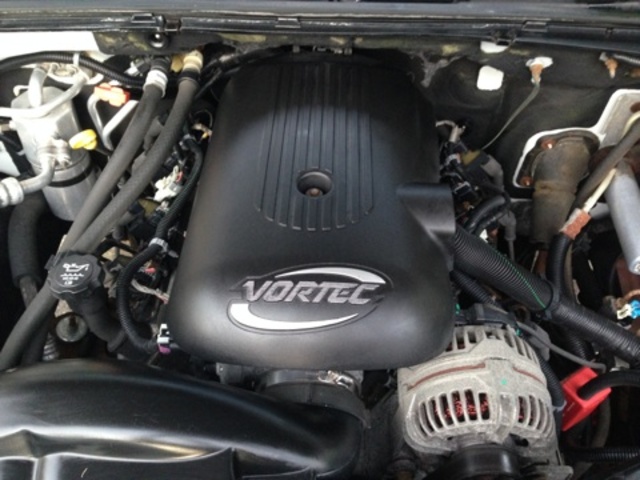

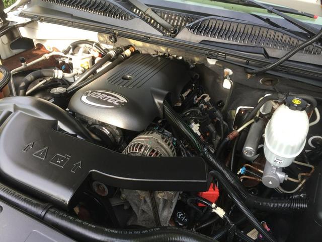

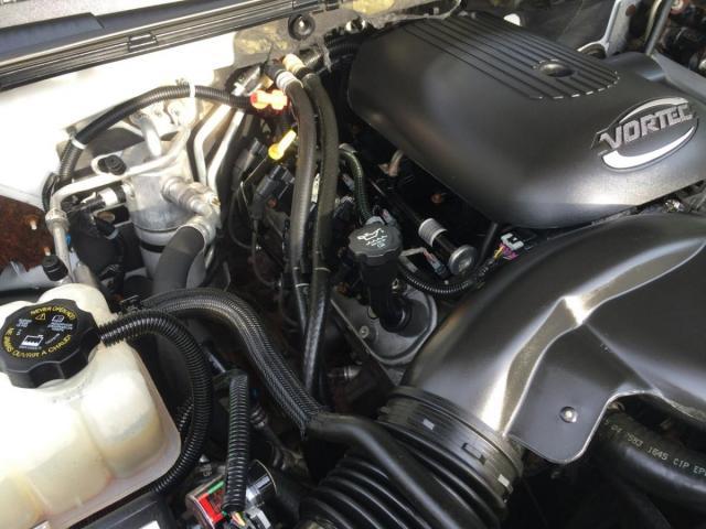

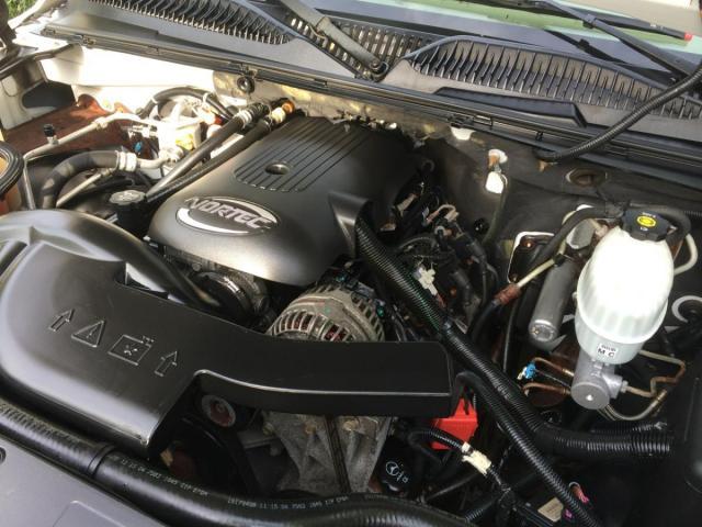

RMCIII 840 #18 Posted May 27, 2014 Decided to detail the engine area. Share this post Link to post Share on other sites
