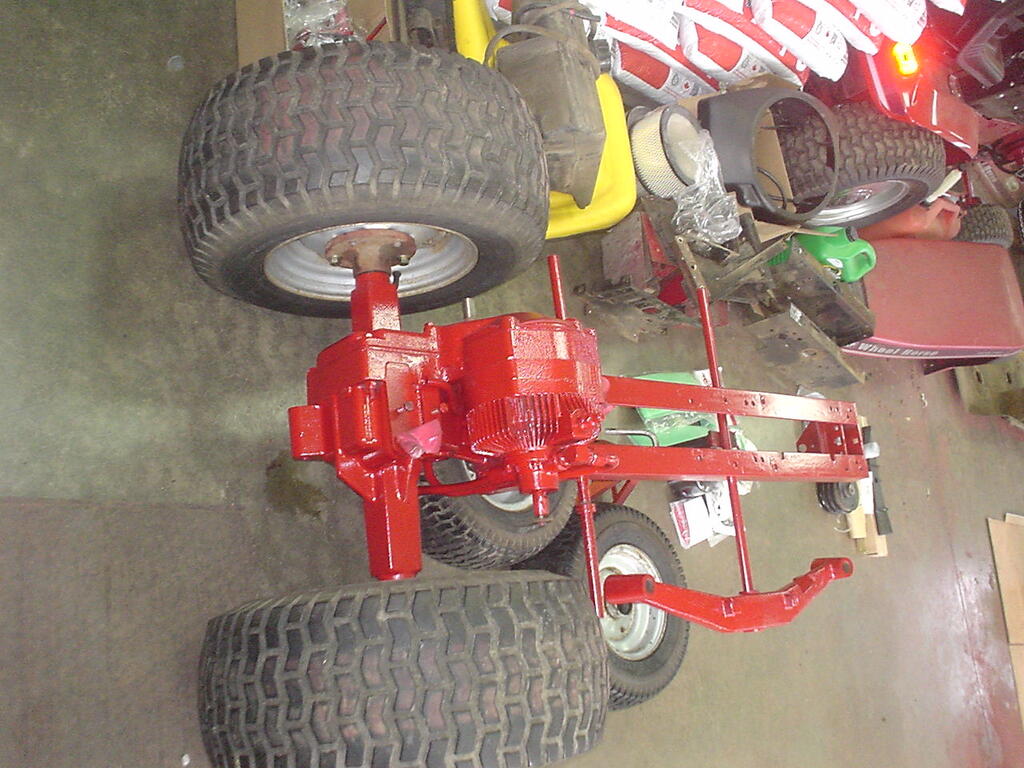

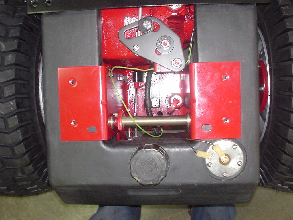

cleat
These might help a bit.
1323543323_Frameandfrontaxlecleanedprimedandpainted3.jpg.e4957ead421c42998b90a64693c7e14d.jpg
nappypappy
Thanks that does help...
