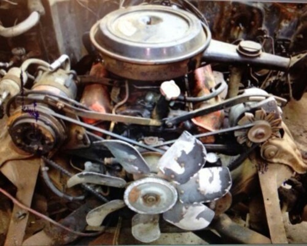

Docwheelhorse 2,991 #1 Posted February 6, 2014 Hello All, well as many of you know the (POS) 400 small block in my 1971 Nova SS decided to blow up after a fit of spirited gear throwing with the Muncie M21. I didn't build the motor and never liked it from the start.... After blowing it up I have had 99 different ideas of what I wanted to do to re-power my car. I always kept coming back to one nagging idea. Granted this idea won't be the easiest or cheapest but will be the "Coolest" at least in my mind and that's all that really counts. After looking at crate engines, used engines, rebuilding the 400, having LOTS of power versus having average power so I could let my kids drive it etc... I have picked up a 1968 Impala 250 Hp 327 Quadrajet motor. I have always loved 327's and there big brother the 427. Never had either..... but just didn't want to say "its got a 350...... siggggghhhhhhh" when people ask. I'm going to open it up a bit and see what it looks like inside---if its clean I will put in a timing chain, front cover seal, rear main seal, oil pump and whatever other gaskets I can. Motor has 96,000 and runs / sounds good. I just liked the idea that this motor is 100% complete and has all the brackets I need to run the non accessory bolt hole double hump heads, Plus I want to add after market AC at some point and the cool GM Frigidaire compressor and brackets are included. The guy I got the motor from pulled it out of the Impala to make room for a sick 572 cid 850 HP Big Block. Heres a pic of the engine.... yah maybe I'm crazy but its just plain cool. I expect to get all sorts of messages about "theres no replacement for displacement" and that's fine. This is enough motor for me at this point and if I want theres lots of room left to turn this into a Duntov 30/30 wannabe! Tony 2 Share this post Link to post Share on other sites
stevasaurus 23,753 #2 Posted February 6, 2014 Yep, that is a 327. I always thought they were great engines...and easy to work on. Tore a few of them down back in the day. That will look great in your Nova. Share this post Link to post Share on other sites
shorts 182 #3 Posted February 6, 2014 I had a 365hp 327 vette motor in a 66 el camino, lots of fun back in the day Share this post Link to post Share on other sites
smoreau 658 #4 Posted February 6, 2014 Good choice! 327 is a very responsive engine! A few things I recommend, Use a good roller chain and pull the oil pan at least. That should have a 2 piece rear seal, replace it before you install the engine as it is a lot easier while its out. Check out all the freeze plugs, if in doubt, replace them. Anything else is easy to replace after installation. Novas are light and don't need big engines to make them go like the wind. Share this post Link to post Share on other sites

Docwheelhorse 2,991 #6 Posted February 7, 2014 Thanks Guys...... I dunno why but it always seemed everybody talked about the 327 Vettes, 327 Novas (62--67), 327 Chris Craft Boats and on and on.... The Small Block Chevy was just perfection from day 1 in 1955 when the first one came to life (maybe it was 1954???). Yah the 350 is the most used, most versatile engine probably ever created. BUT.... they have become boring. Seems everything from your Craftsman lawn mower (lol) to trucks, planes, boats, hot rods used it and its just boring me to tears. Just saying I have a "327" is gonna put a smile on my face and heck the "283" is even a cool little motor. They didn't name it the "Mighty Mouse" for nothing. Tony 1 Share this post Link to post Share on other sites

Docwheelhorse 2,991 #15 Posted March 8, 2014 Hello All---- just a little update.... the 327 is sitting in my driveway all wrapped up nice and snug on a pallet. After a little bit of research on the parts that where on it I decided the small valve medium chamber heads just weren't gonna cut it. So on the way is a set of remanufactured "041" small chamber (64cc) 1.94/1.50 valve heads that will give me 10-1 and 325 hp with a mild crane upgrade cam over the factory stock one. These heads are essentially an exact copy of the old "fuelie" heads everybody talks about--except that these have accessory bolt holes on the front. I can't wait to get this motor together.... its gonna be a slow project but hopefully something I accomplish in the next 6 months or so. Next "piece" I need is a decent steel flywheel. Tony Share this post Link to post Share on other sites
RMCIII 840 #16 Posted March 8, 2014 Tony, it's great to hear you have finally decided what path to take.....Anyway you would have chose would have been correct, why? Because it is yours....Yep, you are gonna hear lots of advice on this one..... Question though, why not keep it nostalgic like you started, and find a set of 302 double hump heads. 2.02 intake and 1.60 exhaust.....In 69 on the 302 they helped to develop 11.0.1 compression......Nothing like a double hump head if you are going nostalgic......The heads, along with the bore and stroke, allowed that little 302 to turn rpm's of 8 to 9,000....Not bad for a motor that came from the 60's.... Share this post Link to post Share on other sites
Docwheelhorse 2,991 #17 Posted March 8, 2014 I was considering the double hump heads.... but they limit my possibilities for adding air conditioning etc... to the car. The "461, 461x" and similar castings do not have the 3 bolt holes drilled and tapped in the heads, these castings also do not have enough "meat" to allow them to be drilled and tapped. Yes I have all of the accessories (alternator, short water pump, power steering pump, AC compressor... all of the pulleys and brackets) off the original 327 that didn't have accessory holes from the factory BUT... I am finding that the original style rams horn exhaust may not fit my car and finding a set of rams horn castings with the proper angle dumps maybe very expensive and perhaps impossible. The reason the exhaust matters is that on the drivers side there is a cast in boss on the front of the rams horn that allows you to bolt on the alternator. No rams horn exhaust means no alternator and then I'm in trouble. So.... yes I did want a 327 with "double hump fuelie" heads on it... but after reading, and thinking I decided a set of 041's which are the "double hump heads" with accessory holes will fit the bill. Yes it not 100% nostalgic---but I am not painting myself into a corner concerning how my accessory drive/exhaust/pulley setup will work out. I would hate to pay for a reconditioned set of double hump heads just to have to pull them off because they wont work with my car. Next question---I have done plenty of reading and have found out that while people always think "bigger is better" the 2.02 valves actually hinder the intake flow out of the head up to about 5000 rpm at which point the bigger valve starts helping. I am not building a 302 DZ motor and don't have plans for the amount of $$$$ it would take to build a small block that will spin to 8000 more than once.... The heads I bought came with 1.94's from the factory and I am not going to pay to have the seats cut for 2.02s. The "041" 64 cc heads where on the LT1 350 in 1970 and then died an EPA mandated emissions death.... the "041" heads for 1971 and 1972 where 76 CC and gave 8.25/8.5-1 compression. It only got worse from then on... so my recipe is going to be a 1968 small journal 327 with flat top pistons, the 041 heads, a set of rams horn cast iron exhaust manifolds if I can, a set of log style cast iron exhaust manifolds if I have to, the 1968 cast iron intake with the oil fill up front, the original Quadrajet 4 bbl and a Competition Cams 274 H cam. Except for those 3 little holes on the front of the heads it will definitely look the part... and the 041 heads have what I think is two "square" cast markings up front which look extremely similar to the double humps anyways. Motor will easily and reliably make 300--325 hp and run between 2000 and 5500 all day. That's the plans and sorry if I was long winded... If it sounds anything like this I will have to have some quiet time with myself... ---> http://www.youtube.com/watch?v=Wk9L2Wp10II Tony Share this post Link to post Share on other sites
