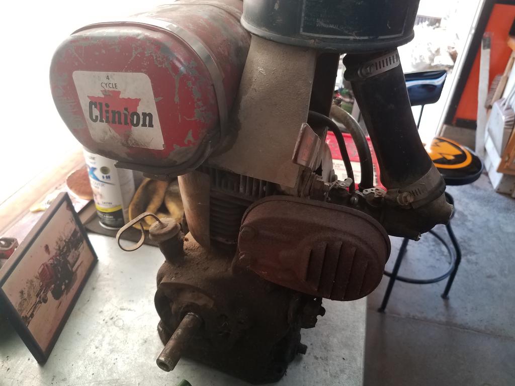

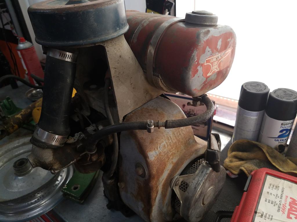

Shynon 7,723 #16 Posted May 4, 2019 (edited) 5 hours ago, pullstart said: has anyone ever tried to put a Kohler carb on a Tecky No but I just bought a K91 with a Tecky carb on it. And a Clinton gas tank Edited May 4, 2019 by Shynon 1 Share this post Link to post Share on other sites
AMC RULES 37,260 #17 Posted May 4, 2019 Oh, a Frankenkohler? 3 Share this post Link to post Share on other sites
clueless 3,440 #19 Posted May 4, 2019 1 hour ago, Shynon said: As my grandmother would say, now that's a piece of work. 1 Share this post Link to post Share on other sites
