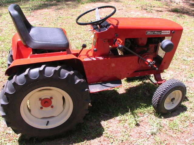

pacer 3,180 #3 Posted January 26, 2014 if you can stand 30" in height on it then heres a really nice AG tire at a quite reasonable price --- I've got them on my 1054 seen in my avatar, they are a pretty snug fit but look pretty wicked, I have a good pic of them mounted if you'd like. http://stopandgotires.com/modelsize.asp?ProductCode=%27FA512%27 Share this post Link to post Share on other sites

pacer 3,180 #10 Posted January 27, 2014 My 1054 came to me with 15" car tires on it and I knew immediately that they HAD to go! Yuck! I really wanted Ags and after much searching found them at stopandgo tires. I also have a D-180 with 15's on it and when the original Ags dry rotted a couple years ago I chose the skid steer type. IIRC they are 27" they were something like $250 - they look good too. Share this post Link to post Share on other sites

953 nut 67,390 #18 Posted April 17, 2021 Don't know if the skid steer tires would fit the narrow rear rims on your 1054. @PeacemakerJack's father put a pair of 7.60-15 ags on his 1054 and they looked great. Perhaps he can fill you in on the source. 1 Share this post Link to post Share on other sites
pacer 3,180 #19 Posted April 17, 2021 Re: 15" tires......... Geez, that is so long ago that I'm a bit fuzzy on recalling detail ... But I can say that the ag tire on the 1054 was a great choice. As far as fit, that tire (American Farmer 7.50x15) was exactly 30" tall and I seem to remember it had some 3" clearance -- just almost perfect. But!! I dont know where you would get that tire! I recall when I was researching tires during that time I was told several times that 15" tires were becoming more and more scarce - they just wasnt making them. And this morning after a brief search, I could not find it in the American Farmer listings. Perhaps one of the other guys here knows if they are available ........... You might start a new thread about it, sometimes these old threads will get passed by. Share this post Link to post Share on other sites

Jim Turner 47 #21 Posted April 18, 2021 (edited) On 4/17/2021 at 7:38 AM, 953 nut said: Don't know if the skid steer tires would fit the narrow rear rims on your 1054. @PeacemakerJack's father put a pair of 7.60-15 ags on his 1054 and they looked great. Perhaps he can fill you in on the source. Your right the skid steer tires probably would not fit the 1054. Those 7.6-15 do look great and probably best option I will order a set. I did find some 28-8.5-15 skid steer tires that would look good on that D series or even a GT-14. But the 7.6-15's Not sure if they would fit under the fenders of the GT-14 Looks like not as much room under those as the 1054. Edited April 18, 2021 by Jim Turner Share this post Link to post Share on other sites
