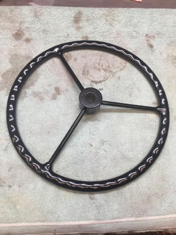

19 hours ago, dclarke said:

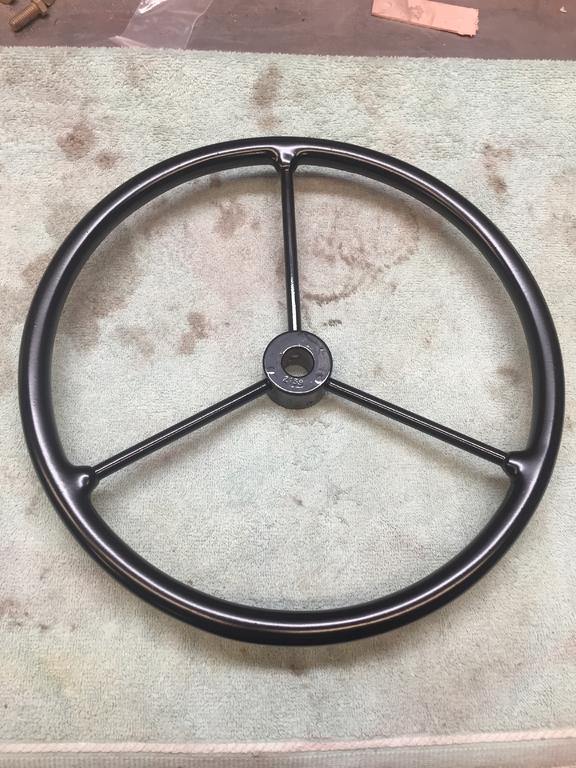

The steering wheel repair turned out pretty good. Craig, your tip on using a glove and water with that epoxy sure made this job easier. Thanks!

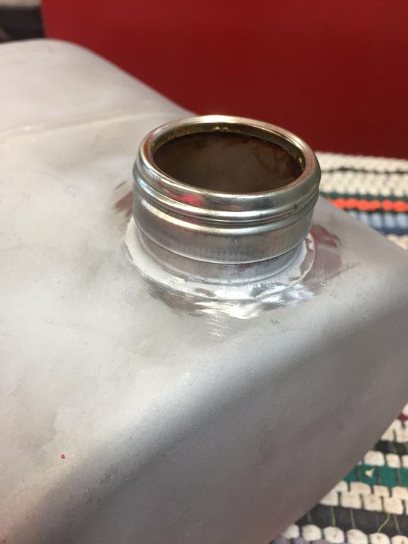

I never saw Craig’s tip until now when I scanned back through the posts, thanks for mentioning it Denny!  I have a couple patches to fill on Frank’s tank, I’lol be sure to use that method.  Fellas, I assume a latex type glove would be easiest?
dclarke
That’s what I used, Kevin.
:text-yeahthat:              That wheel looks fantastic!       Did you use Sargs's suggestion of VHT Vinyl dye and Diamond Clear?              :text-coolphotos:
dclarke
Right now it’s just Rustoleum rattle can, gloss on the hub and spokes and semi gloss on the plastic. I do plan on using the satin finish Diamond Clear on the plastic though. Right now I think it’s got just a little too much gloss on that part plus it’ll protect the paint.

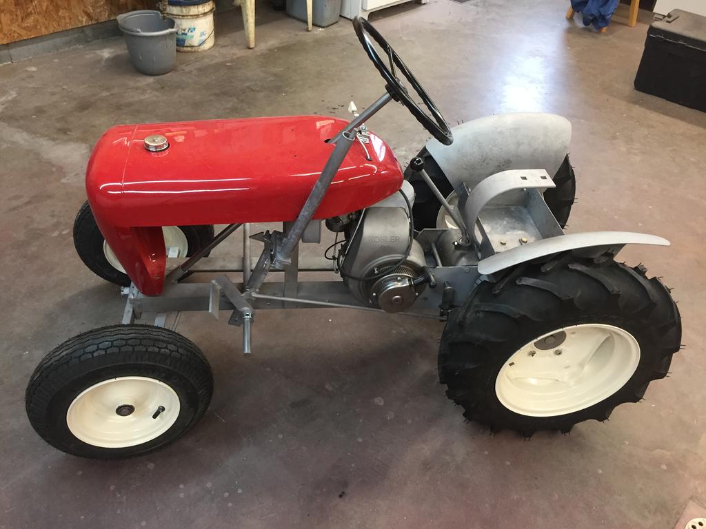

dclarke

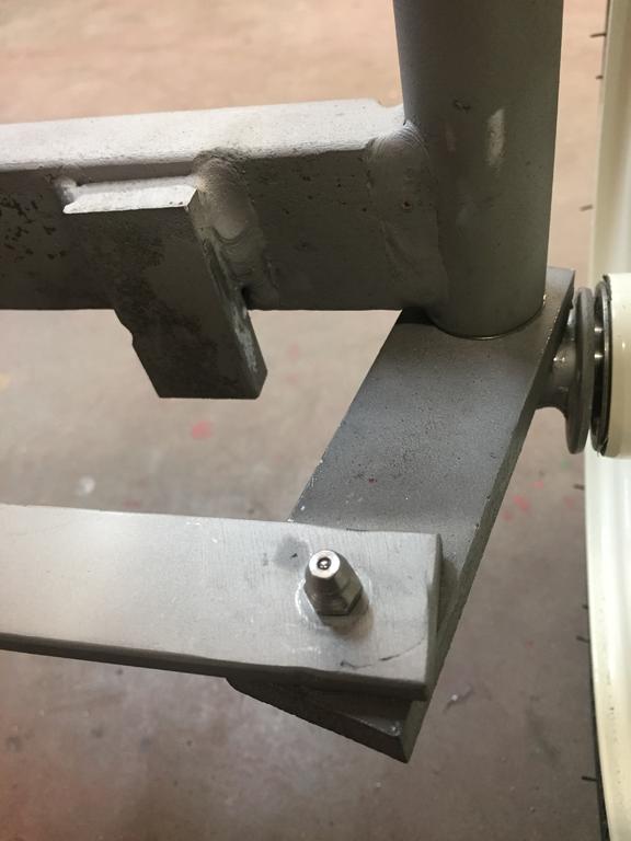

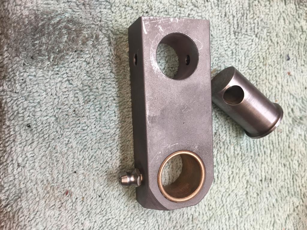

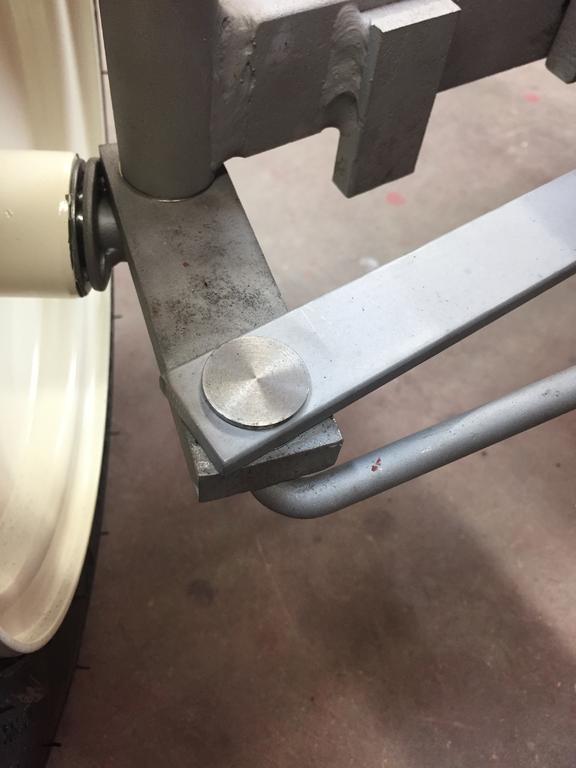

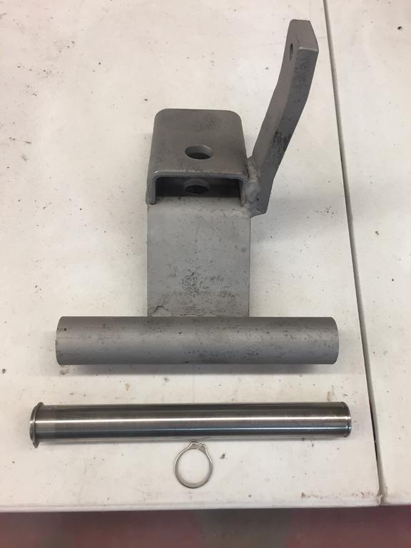

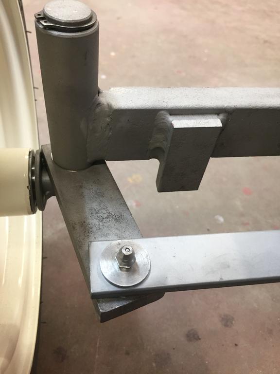

A few years ago I picked up a nice hitch, my old one had a lot of pock marks from rust. I also turned a new stainless pin to mount the hitch. This morning I added grease zerks to the bushings that I had installed in the spindles and steering block.
Edited by dclarke
  • Like 5
  • Excellent 3
dclarke

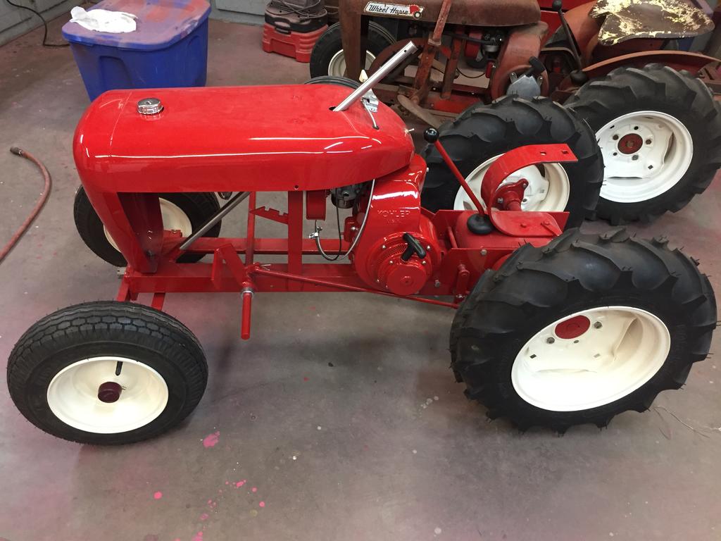

Progress on this has been slow but it’s starting to turn red.
  • Like 3
  • Excellent 4

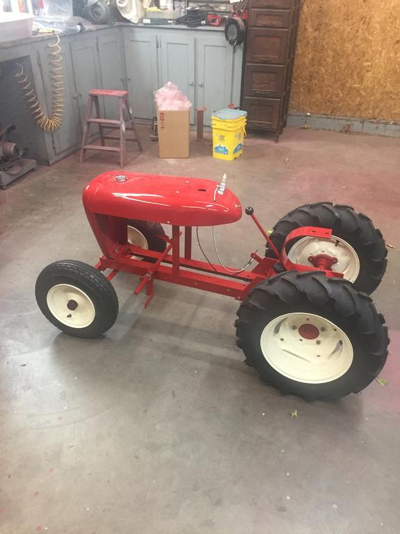

dclarke

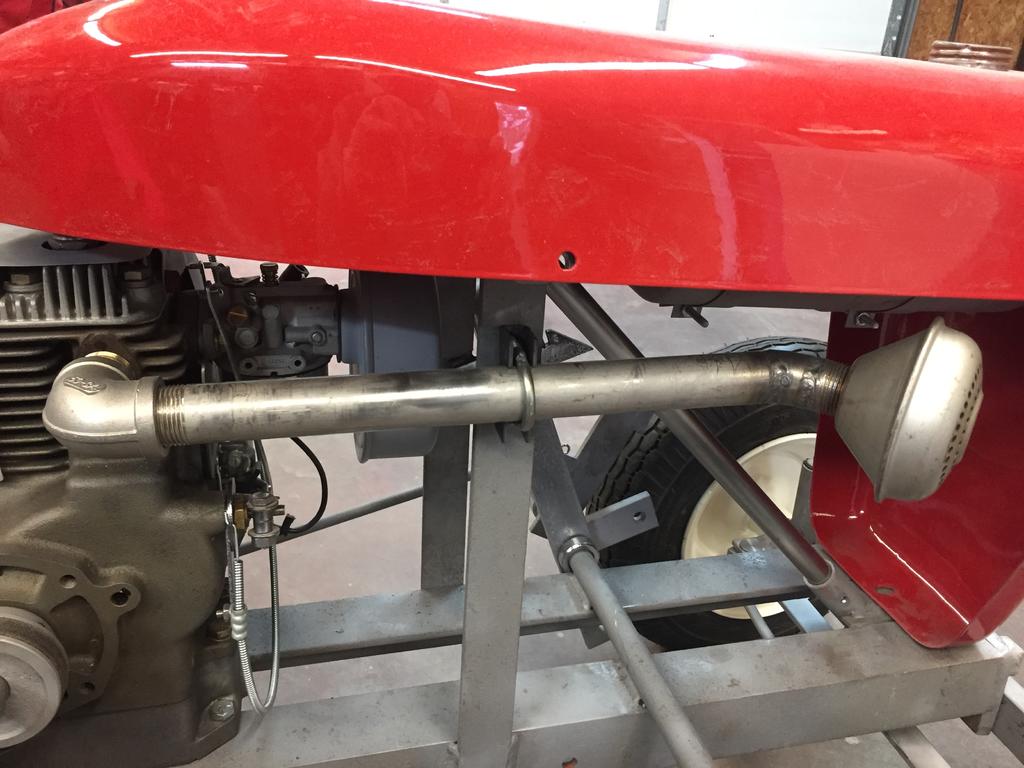

Well after starting on this project 6 years and 2 months ago I finally finished painting it today and have got the engine back in. Hopefully I can finish it up this week.

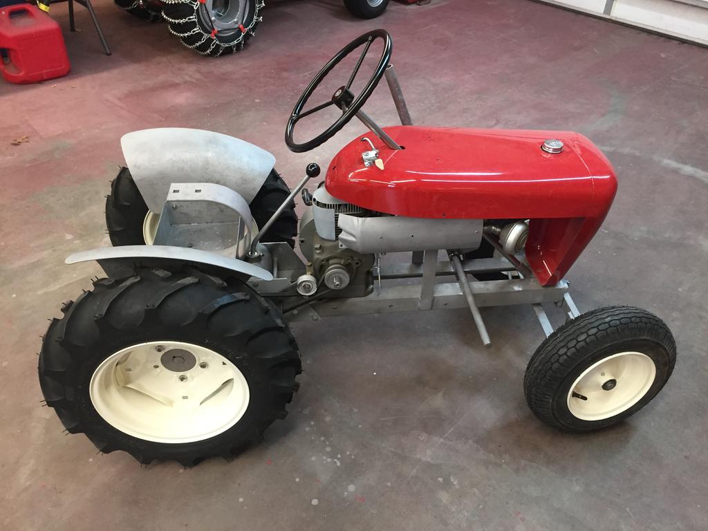

dclarke

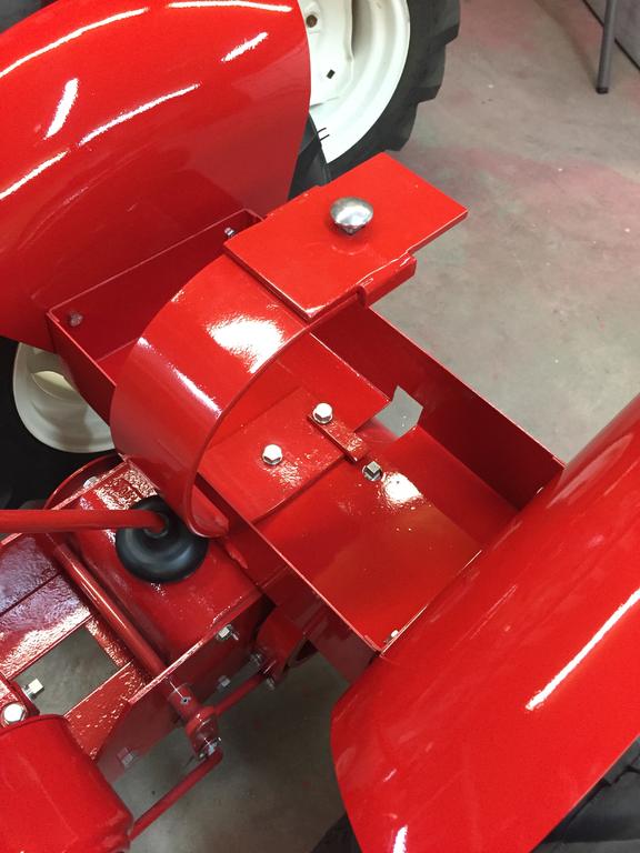

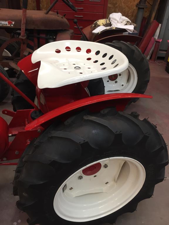

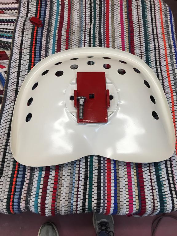

I wanted to raise the seat just a little to help keep it off of the fenders so I made a 1/4” spacer to fit under the seat then lengthened the shoulder on the carriage bolt to keep the seat from turning.
  • Like 2
  • Excellent 3
  • Heart 1
dclarke

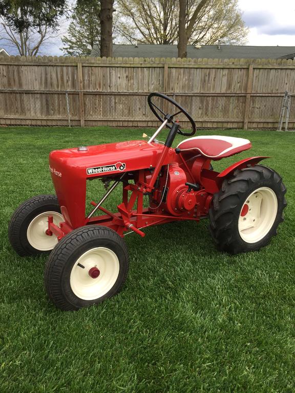

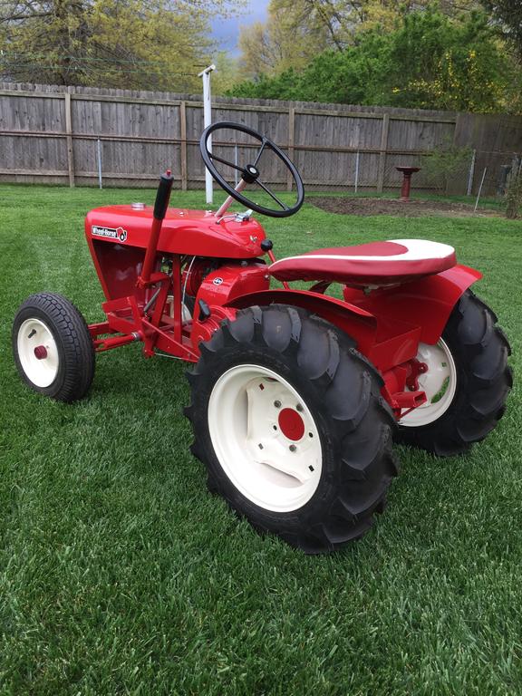

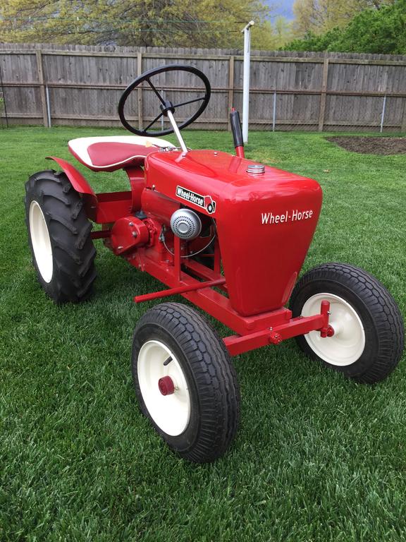

Except for installing the shift pattern decal, this long overdue project is done.
  • Like 1

WHX??
Wow Denny ... nice muffler! Dan made some nice seat elevators I'll have to show.

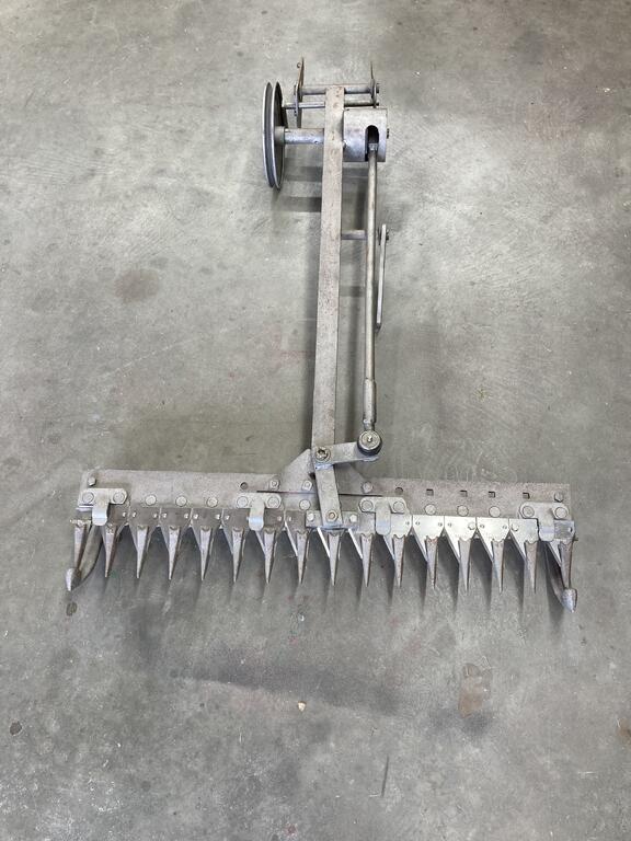

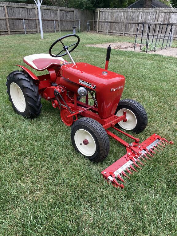

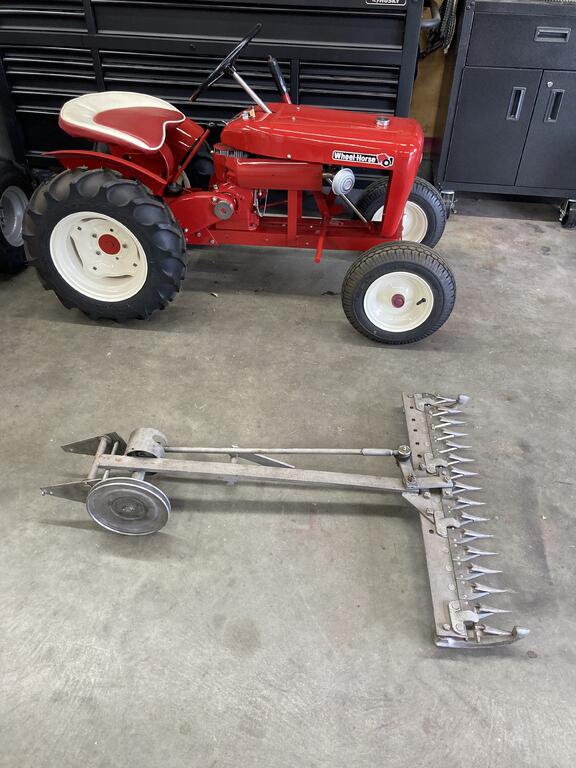

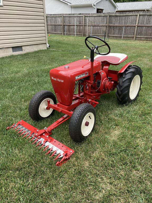

Seven years ago, during the rebuild of my RJ58 I had this CBR32 sickle cleaned up and ready for paint when I decided to trade it away. Today I got the sickle back, exactly as it was the day it left. Excited to get it painted and mounted back on this ‘58.
