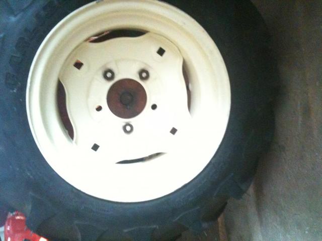

Anybody know which one of these rims is correct for the 58 RJ?
  • Like 1
Lane Ranger
Denny:  Her is a photo of a rear wheel on my 1958 RJ I bought in Oklahoma.  I am sure the wheels on this one are original to the tractor.
dclarke
Tthanks, Lane.
