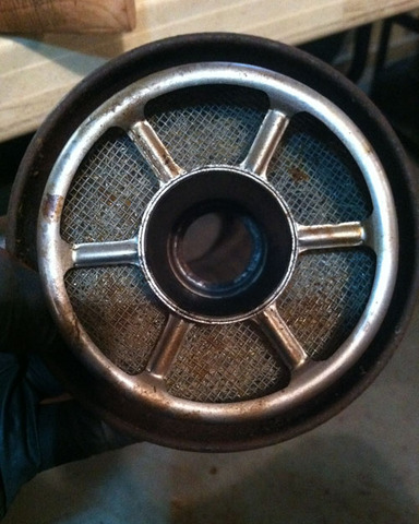

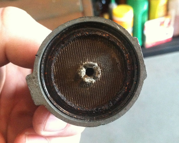

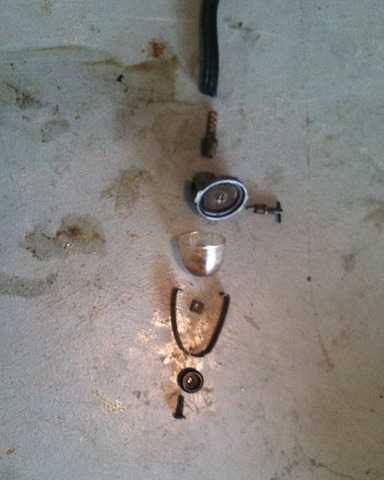

I am wondering how to get either of these filters out and how or even if I should replace them. One is for the oil bath filter and the other is for the glass sediment bowl filter on the bottom of the gas tank. Any help would be appreciated. Thanks

buckrancher
the gas filter screen will come out if you remove the bowl gasket but you can replace the hole filter unit for around 10 bucks
the air filter mesh about all you can do is clean it in solvent by soaking it

I am planning on just cleaning the oil bath filter, I was more interested in the filter screen in the fuel apparatus
wallfish
pezsox

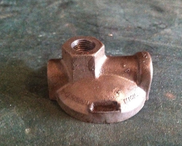

I couldn't  tell if that was an o ring or a gasket, so I didnt want to go prying the thing out of there to clean it. Thanks for the help
