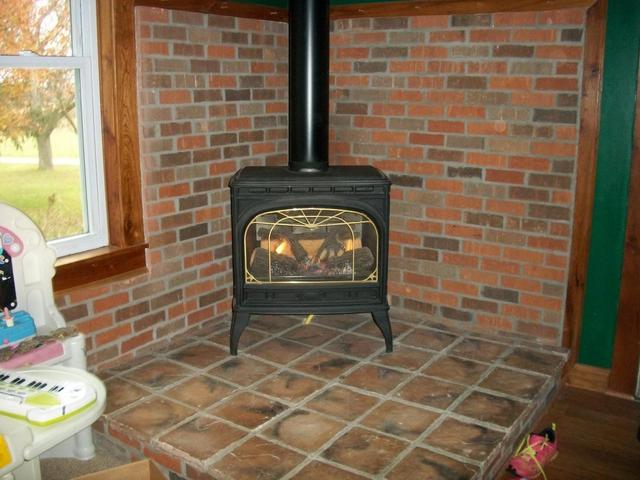

rydogg 186 #11 Posted October 31, 2013 Have you thought about a pellet stove? maybe as a secondary heating method but I would prefer a gas furnace as our primary This secondary heat source (pic below) was installed by the previous homeowner it is more or less just for looks/ambiance it uses propane and is nice on the cold evenings but not very efficient I have been thinking of putting a corn/pellet burner in place of this but they seem like a lot of maintenance. Since the hearth and piping is already there it would save a lot of cost but I need to do some more research. I will be putting a pellet/corn stove in my shop once I run out of wood from my small woods that I am getting cleaned up. I got a few estimates today for another gas furnace 96 percent efficient 2 stage variable speed like I am looking for, best so far is $2,850 for everything installed. Thanks for the link Doc I did read it and got some good helpful info. Share this post Link to post Share on other sites
