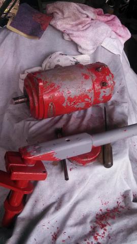

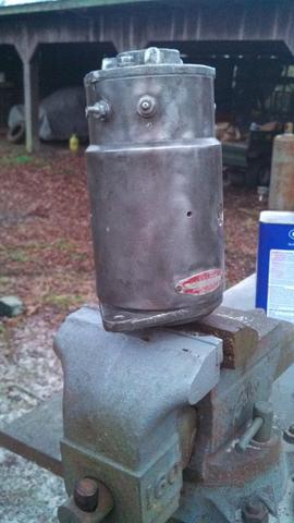

Got my starter ready for paint today..again!

In regards to the picture you have in your last post with the lift lever showing the grey primer and the red topcoat, 2 comments.
First, the red topcoat abraded off onto the sanpaper looks very "gummy" and clogging the grit of the paper. I would not have expected a gummy appearance from the topcoat if you had added a hardner to the topcoat.
Second, the area on the lift lever where the lever meets the pivot, the topcoat looks like it is peeling off in strands leaving the primer intact. Did the topcoat just peel off that easily?

That's after I put paint stripper on it :) I didn't put any on the lift arm. Just starter. it dried really nicely it just had no adhesion. I'm stripping all those parts down and doing it all again and I guess try to help out fellow horsemen with my valspar paint! And yes it peeled off THAT dang easy. It was literally no trouble at all just to flake it right off.

Is it me, or does the primer on the lift handle look shiny? An oil based paint won't stick very well to a shiny surface.
I would take that lift handle and rough it up with 400 grit paper. Wash it with mild soap and water, rinse it thoroughly, let it dry, then clean it again with grease and wax remover, let it dry, and paint it again. See if it doesn't stick.

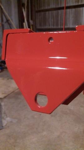

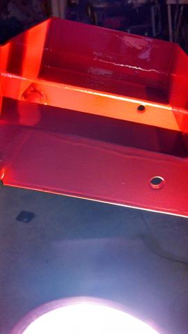

I got ALOT painted today. Camera isn't working good right now but I've got two pics of my frame. I got a sag as you can see. Of course it would be on the outside so EVERYONE can see. The rest of it looks really great. As you can see on the front of the frame in the other picture I got very little or no orange peel in most places.

Paint looks good now! Just takes a little bit of trial and error.
