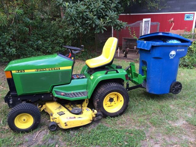

Well, I drank the green kool-aid. I bought the JD 425 and it has to be the quietest gas engine I've ever used with the exception of maybe my 2hp B&S edger...lol. It came with the 3 point hitch and 540 PTO already installed and has only 427 hours on it. It's a 2001 so no worries about the cam gear. It's my first green tractor as I've always been a Cub Cadet and Wheel Horse fan. That being said, this thing is a hoot! Still getting used to the idea of power steering on a garden tractor but I think I'll be able to adapt...lol. I've already purchased a Heavy Hitch adapter and garbage can carrier. Here it is taking out the trash...
JamesBe1
Pretty cool.  That's the first time I've ever seen a garbage can adaptor.

Blasphemy
Sycoticca
"GREEN"... :eek:  :no: Paint it RED..... It would run better and last longer too.

dyt4000
Not to fear! I still have my Wheel Horse and my IH Cub LoBoy...trust me, they are going no where!
leeave96
The 425 is a awesome garden tractor!
Very nice find. You'll love that tractor.
JackC
You made the right choice.
Trouty56
Yikes!!!  3500 clams is a on the top side of the price spectrum....IMHO.....but if you were considering....what do I know..... :)
Edited by Trouty56
dyt4000
Well, high quality garden tractors aren't real plentiful around here...especially Wheel Horses! I paid less for the Deere.

Jack Fate
deere looks good d160 looks good too (really a lot better) :bow-blue:
bet the WH mows better.
But if you wanted a mower you'd got a Simplicity right :ychain:
dyt4000
I was looking for an all purpose tractor...so far, this one fits the bill! My biggest concern with the Wheel Horse / Onan was parts availability.
