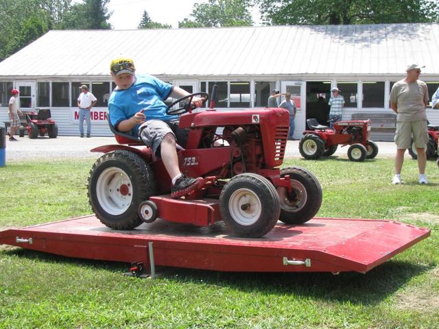

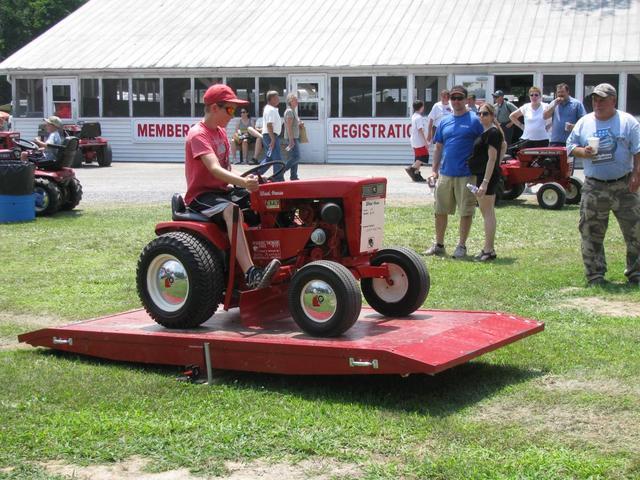

whc160 80 #1 Posted February 26, 2013 I would like to make a balacing platform for the Vintage Garden Tractor Show we have here in town. I have seen pics of them, but have no measurements to go with. So if anyone has some measurements and some good pics that would be great. Thanks. Share this post Link to post Share on other sites
AMC RULES 37,259 #2 Posted February 26, 2013 Don't know the dimensions, but here a couple picts from the 2012 PA show. Share this post Link to post Share on other sites

stevasaurus 23,741 #7 Posted February 26, 2013 (edited) That horse is basically 3' x 5'...estimating the main deck to be a 4 x 8 x 3/4" treated sheet of ply wood...the ramp part looks like about 8" x 4'...the main supports look to be a 2" x 6" x 10" with the plywood framed with 1" x 2" material. I would frame under the plywood with 2" x 6" on at least 16" centers...and double up the one across at the center (for mounting your hardware for the rocker). It would also help sturdy the deck by putting bridging between the cross bracing. The rocker is mounted a little off center so the platform returns to down on the same end when nothing is on the deck. All measurements are on estimation. Edited February 26, 2013 by stevasaurus Share this post Link to post Share on other sites
JimD 3,347 #8 Posted February 26, 2013 I would say that your measurements are pretty close Steve, but it looks like it was made of all metal. Share this post Link to post Share on other sites
