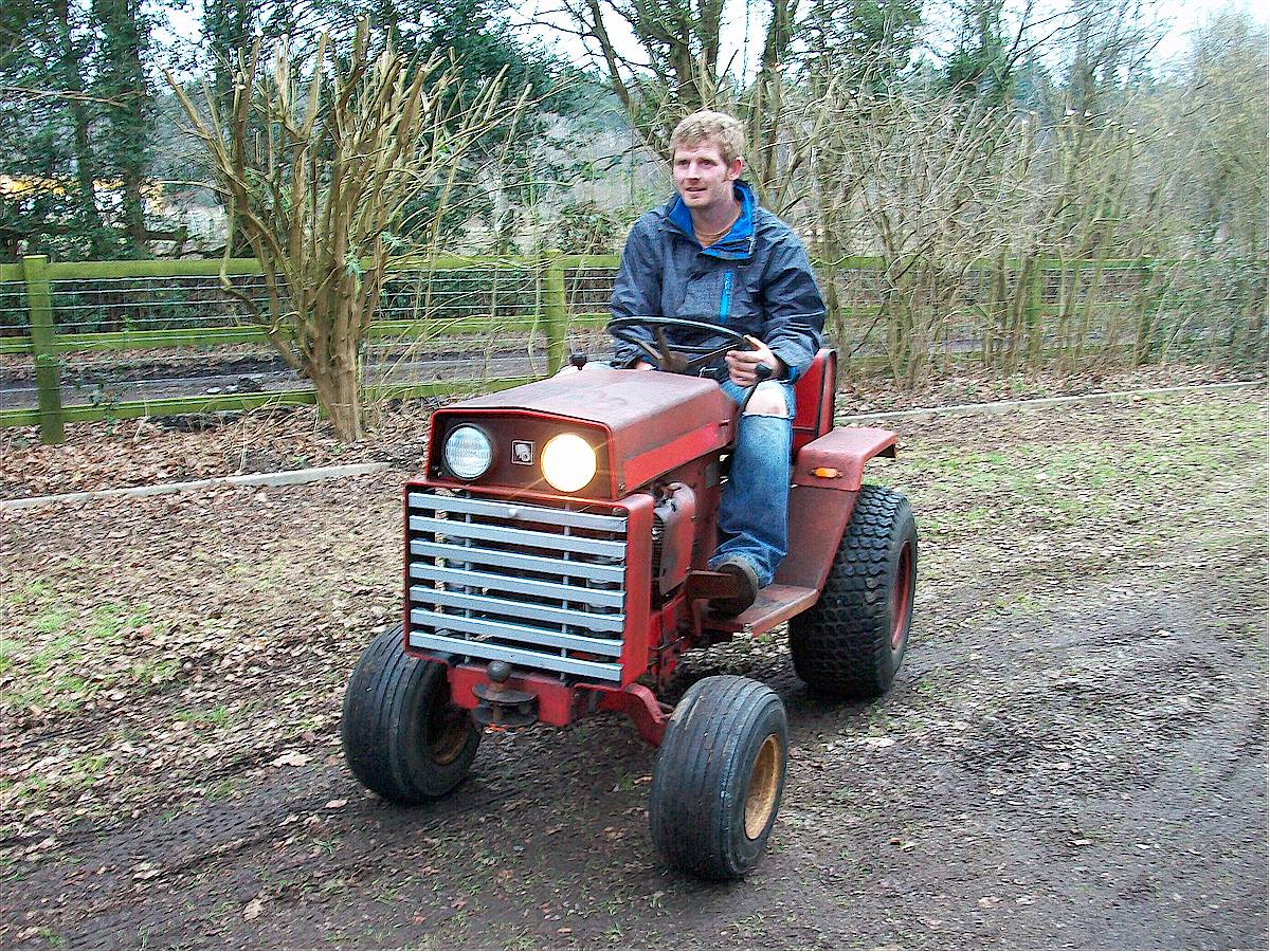

This feels a bit like one of those family anouncements made for a new arrival but I picked up another D-200 at the weekend. It's a 1978 model and so has different decals and rear wheels to the 1977 model I restored last year.
It immediately met with my son's approval but I must remember to give him the camera and sit on new arrivals myself one of these days as he's hogged the limelight on several occasions now.

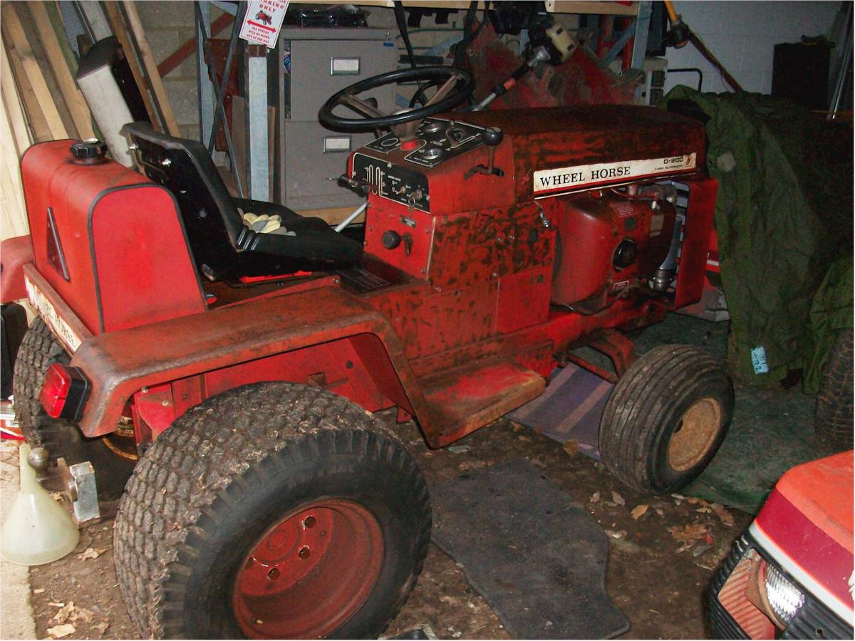

Just managed to squeeze it into the corner of the barn - sorry about the poor quality photo here but it was too cold to get it outside to give it a look over today. Its been seldom above freezing for more than a week now.

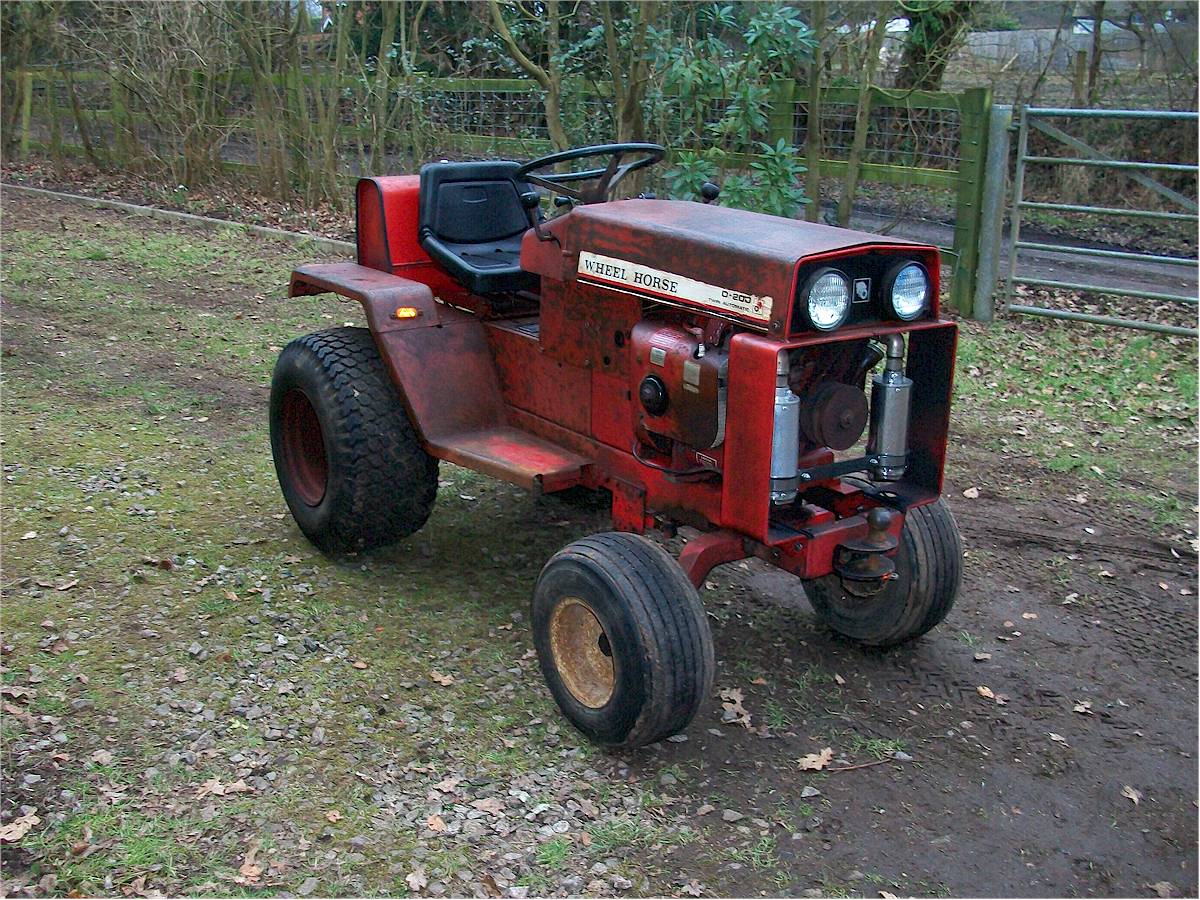

Eagle eyed 'D family' members may notice some shiny new mufflers have been fitted. Suitable replacements for a D are hard to find and have been discussed before. I can't take the credit for these but the PO found a source that none of us had considered.

I found a bit of time today and topped up the tranny as it was off the dipstick. Fixed the headlamp, tweaked the carb as it was running way too rich and reconnected the rectifier regulator but looks like I'll have to swap it out for a spare tomorrow. I was going to give it a run about the place but noticed the front axle is very loose. Had the same with the last D - oil from the engine lubes up the bolts which loosen up, a job for tomorrow. Pleased with it so far though and yes, this one goes backwards as well as forwards (bonus!).

And now the muffler solution devised by the PO.
These are pit bike mufflers to explain how I think they were adapted to fit here's a more detailed view (click either image to enlarge)
The solution is ingenious but needs developing a little further i.e. tail pipes added so that the exhaust discharges below the grille frame. I'll give the PO a call to check that I'm right but here's how I think he did it.
The elbow fittings have been changed to a smaller size. How? Well I think he cut slots into the threaded ends of the nipples from the engine then squashed the pipe to the smaller diameter and threaded on the elbows. (This is what I need to check so don't go trying it yet.)
The nipples leading down to the muffler were put in a lathe and the threaded part turned down till it fitted into the end of the muffler. There's a stock securing screw on the muffler to secure it to the pipe and it's been sealed with a bit of paste. The stock muffler mounting clamps have been braced by a bit of flat bar.
As far as I can see tail pipes in the style of the originals could be added. These are straight through mufflers but no too loud and give a pleasing 'bark' as the engine opens up under the governor. I'm guessing they'd be quieter with D style tail pipes with the side holes for discharge but I like the sound they make as they are and I don't think they'll attract any complaints from neighbors.
Credit for this solution goes to the PO but it's an idea that some of you may wish to try and develop. Despite their size, pit bike mufflers are intended for smaller engines but they've got a large straight through bore so I doubt there's any power loss. I'm both pleased and impressed. What do you think?

So how do they sound? Overly muffled?

Very good Muffler adaption. Good solution to the rareity of replacement parts. I think I've seen Baffle adapters for Pit Bike Mufflers somewhere that don't impinge much on gas flows or increase back pressure, but if you say they're pretty quiet anyway, I'll stop waffling. I bet they were the first things you checked out when you first looked at the Tractor Andy, and one major item less to worry about. A great aquisition.
ericj
you can get reducer fitting in black iron pipe ie. 1"inlet to 3/4" outlet and you can get them in 90's or straights this might help you out

The muffler arrangement I inherited isn't perfect but offers food for thought and needs developing.
I was looking at it today and the PO used very short elbows (hope that's what their called in the US) As a result the mufflers don't line up with the holes in the grille frame. Longer elbows (that dont turn though 90 as sharply) are needed. When I get time I'll take it all off and make the nipple and elbow arrangement correct to line up the mufflers with the holes in the frame.
Altough dirt bike mufflers (learned a new US word today) have that angled exit appearance I think the actual bore passes straight out so adding a tail isn't impossible.
It's always difficult to describe a sound but it grows on you. When you open up the throttle it sounds as though there's way more than 20 horses there! My other D is tucked up for the winter at present but I think the stock exhaust on that is going to sound boring by comparison.
