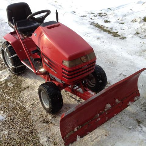

jcg1112 2 #1 Posted January 6, 2013 Finished putting the new blade on today. No fresh snow to play in, so I just pushed around some left over stuff. Thanks again to Tankman for the parts and manual info. Installation went smooth and was uneventful. Below is a pic after playing. Share this post Link to post Share on other sites
Whmaverick 54 #2 Posted January 6, 2013 Plow looks great. Hope you get snow to play in soon. I use six gallons of windshield washer fluid in each rear tire, that with chains my horses push anything that falls frozen from the sky. 1 Share this post Link to post Share on other sites
Sparky-(Admin) 26,218 #3 Posted January 6, 2013 Looks good! Get us some pics when you have some snow to push. Mike............ Share this post Link to post Share on other sites
jcg1112 2 #4 Posted January 6, 2013 Thanks for the compliments. Well, may be awhile before some fresh snow. Gonna warm up this week - 50 deg and rain by Thu. Guess the blade (aka snow repellent) is working. That's ok, I've got more plans for the spring and yard maintenance/work. Share this post Link to post Share on other sites

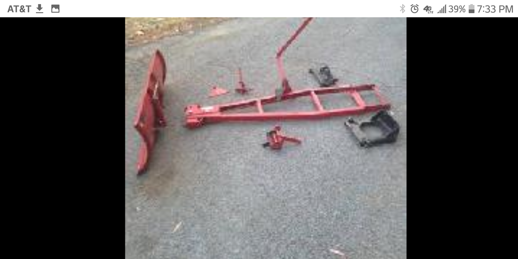

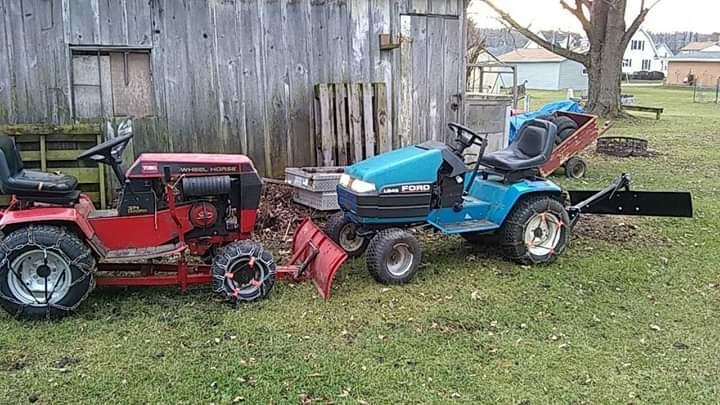

Jason P 7 #5 Posted September 12, 2019 How does the plow mount up? I have a ford ls45 which is identical to the wheel horse 267h but i have a snowplow from a 314h that i want to mount on and no luck finding hitch mounts Share this post Link to post Share on other sites
WVHillbilly520H 10,379 #6 Posted September 12, 2019 5 hours ago, Jason P said: How does the plow mount up? I have a ford ls45 which is identical to the wheel horse 267h but i have a snowplow from a 314h that i want to mount on and no luck finding hitch mounts The 314 or classic series plow mounts differently than the 26x series plows... As you can see there's a front attach a matic part a few more rods links plus the rear axle hitch is a completely different beast than the classic series tractors... Maybe @gwest_ca can help you out with the correct model # and manuals for the 260 tractor series snow plows. 1 Share this post Link to post Share on other sites

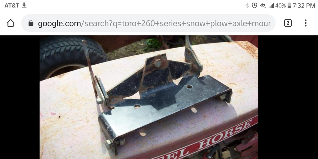

WVHillbilly520H 10,379 #14 Posted September 16, 2019 I wish I would have kept all the mounting brackets for the 26X series but I let it go to a "dealer/reseller" after converting the 79252 over to use on a classic (B,C,3,400) series tractor... The first 3 pics of post six were of the actual blade I had. 1 Share this post Link to post Share on other sites

WVHillbilly520H 10,379 #18 Posted September 25, 2019 On 9/21/2019 at 11:09 PM, Jason P said: Yeah might fabricate a temporary one The plow and frame is not the issue it's the rear axle mount front mount and actual lift linkage... Study those pics I posted especially 3 and 4. Share this post Link to post Share on other sites
Jason P 7 #19 Posted September 25, 2019 Rear mount looks like it bolts up to the frame by rear hitch Share this post Link to post Share on other sites
WVHillbilly520H 10,379 #21 Posted September 25, 2019 2 hours ago, Jason P said: Rear mount looks like it bolts up to the frame by rear hitch I believe it replaces the rear trailer pin hitch and reinforces the the frame to axle mounts so as to not break those aluminum transaxles. 1 Share this post Link to post Share on other sites
