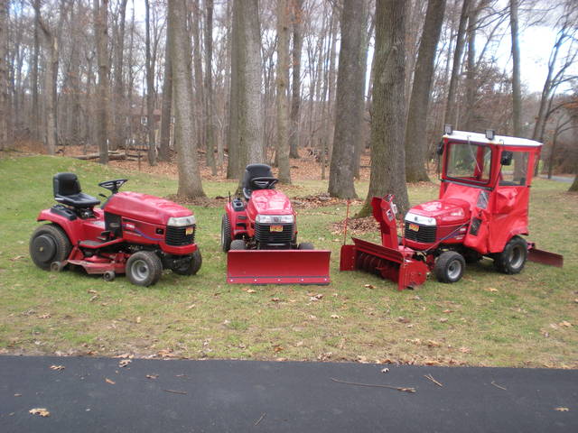

shallowwatersailor 3,222 #17 Posted August 27, 2015 (edited) I have three (1998 518xi, 2000 520xi, and a 1998 523Dxi) and I am happy with all of them. Don't let the lack of power steering be an issue with the 518xi and 520xi. They have a cross between the 520-H steering reduction and regular steering. I pull my Cyclone Rake with the 518 (13' total length!) without a steering issue. Other than the base 518, they have cruise control as well. Because of this Toro equipped them with a mechanical system to automatically lower the speed (7.2 mph in Hi) when turning. You could be potentially thrown off the tractor otherwise! The power steering is a hydraulic system done without a mechanical link so more parts. Not to say I don't like it on the diesel though. It is nice steering with just using the spinner while clearing snow.The tractor portion is virtually bulletproof with normal use. In that regard it is just like a classic Wheel Horse. The Eaton 11 is improved with a Hi-Lo range along with a neutral position handy for pushing it around or even towing. If pushing, it does weigh approximately 1100 pounds bare (add the deck of about 200-300 pounds depending what size) but I can do it. The step-though platform is nice for getting on or off. The attachments go on the same way as a Wheel Horse, some even easier.The engines are what differentiate between the models. Brandon already mentioned the Kawasaki-engined 520Lxi. I don't have one so won't comment. With the three Kohler engined models, I feel the Kohler Command has less issues than an Onan, but more than a Kohler K-series. I would say that these are the most common and readily available. Also easiest to own. With technology improvements comes more technical/fit issues. Kohler recommends that the engine shrouds be removed every 100 hours. The problem is that the engine needs to be pulled from the tractor to gain access. It is four bolts for the engine, two bolts for the driveshaft, electrical connections, and throttle and choke cables. But the engine needs to be pulled vertically because of the oil drain spigot. Most owners don't know this maintenance requirement until they start questioning the oil temperature gauge rising.This is more an engine issue than tractor problem.That said though, the diesel has become my favorite. I bought it with 605 hours and have used it for approximately 20 hours removing snow. I was in the midst of changing over to mow with when I was laid up with a broken ankle. At this point in the season, I'll just put the Winter equipment on again. The diesel does have the potential for being the most expensive to repair if the engine develops any issue. The injector pump, for example, is rather pricey! It does have a water/fuel separator so with normal startup procedures, it should not be an issue. I garage mine in an unheated attached garage but never failed to start last winter. Attachments are out there. They seem to be more readily available today than when I got my first five years ago as these tractors age. Toro also produced a clone tractor for New Holland (black attachments) so they are another source. Good luck in your search! Edited August 28, 2015 by shallowwatersailor 9 Share this post Link to post Share on other sites
