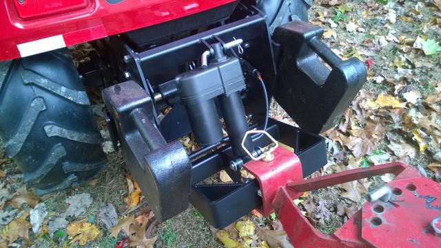

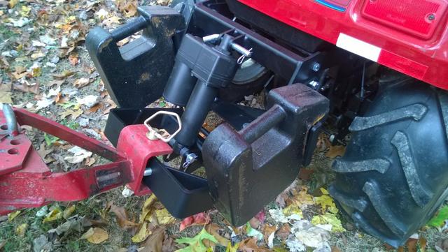

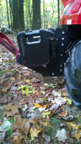

shallowwatersailor 3,222 #1 Posted October 20, 2014 (edited) I made another addition to "Paladin" to make it my primary worker. Right now I am setting it up for winter and installed a Johnny Bucket Universal Electric Sleeve Hitch. This is the tractor that will have the snowthrower so I am using a scrape plow on the rear to get up near the garage doors for snow. Once again the unique Wheel Horse hitch caused fitment issues ( attaching a Cyclone Rake was my previous challenge.) I needed to install the tongue bracket that bolts to the existing hitch backwards so that it didn't interfere with attaching the sleeve hitch. I lose the ability to put a trailer ball through the extra hole. But it would be too low to use anyway so I have plans on how to remedy this. The frame has holes at the rear for the OEM weight box and I used two of these for the metal straps. I sprung for the optional suitcase weight brackets as well. It took three tries at wiring it until I came up with actually a simple solution which doesn't require the wiring extension included with the kit and allows a quick disconnect if I need to remove the hitch. It is a well made item and should provide years of service. I was concerned about the additional length but that doesn't seem to be a problem. Edited October 21, 2014 by shallowwatersailor 6 Share this post Link to post Share on other sites

shallowwatersailor 3,222 #6 Posted October 22, 2014 The shipping weight for the hitch was 55 pounds. He does make a rather robust product! I am figuring on this tractor being almost 1,800 pounds to blow snow. 1 Share this post Link to post Share on other sites

shallowwatersailor 3,222 #13 Posted February 14, 2016 3 hours ago, DennisThornton said: Now that time has passed what are your thoughts? The JB Sleeve Hitch is extremely well made! It definitely added to the 523Dxi capability as I can still use the hydraulics for another attachment. It does require a tractor with a frame to the rear which precludes the "Classic" Wheel Horse. I could just order the sides for the sleeve hitch and be able to put it on one of the other 5xi as well. Besides the Roper Scratch Blade I did add the trash can hauler attachment that I had made. I could probably rig up a fork lift attachment for pallets as well do to the 250 lb. rating. There may be other uses, besides the standard garden attachments associated with a sleeve hitch. One thing I would do differently is to install the switch for the sleeve hitch on the High-Low console. I have it on the dash where It is awkward to operate and watch behind at the same time, especially with the cab on. It is a simple thing to move when I have time. 2 Share this post Link to post Share on other sites
