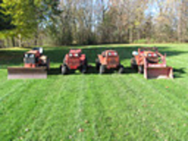

I have a 1976 D-250 and that tractor can do anything I put it up against. I use it to plow snow with every year, and it plows very will with the tractor style tires on the back. The only problem with mine is that the steering is very lose on it, but other than that I think they are great. Just kind of hard to find parts for. If you want to see my collection you can go to www.brandonswheelhorsestables.com .

i have one and my father has two. they really should be treated with total care. they are a beast. they are not a good work horse. hydrolics are weak at best. plowing stinks, you spend all night shifting years. the steering with fail. im lucky to have a bridgeport and milled a new one for pops. they turn long and hard. the only tractor that takes longer to turn is a simplicity 9020. restore it,show it off and buy a large hp hyro wheel horse for working.

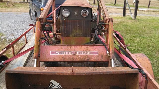

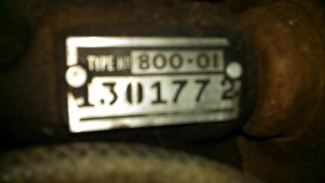

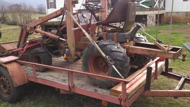

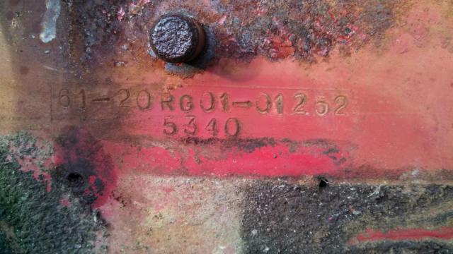

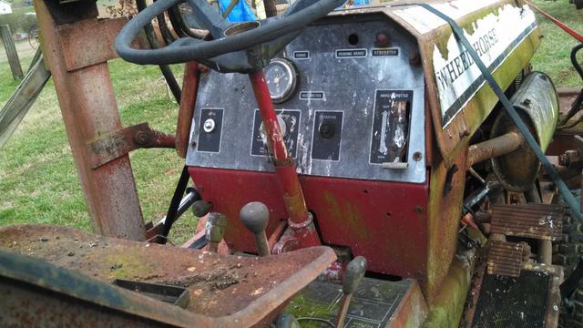

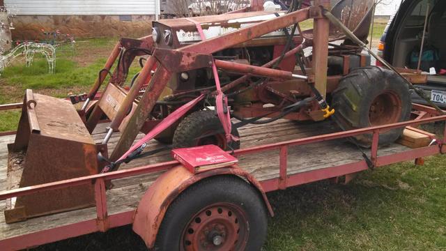

Stevw, This is really GREAT info you have posted here, Thank You!!
Now I have a few questions to ask about my newly aquired D-250.  When I bought it, it has an ARK 500 or 550 loader, haven't checked the loader tag yet, I couldn't find the tractor ID tag. I was hoping to find it under the front support for the loader upright arm, but all I found was a series of numbers stamped into the frame rail. After reading your post about the front remote quick connects, I only have 1 line on the left side mounted on the side of the radiator support, not coming out under the grill in the front of the tractor. Also mine has the foot operated PTO control mounted on the left foot rest running board and had the push/pull ignition switch and starter button. With all I have seen on this D-250 and from what you wrote, I believe it's a first year, 1976? Here's a few photos and can get more tomorrow if anyone lets me know what to take. Thanks everyone for your help in advance..
post-7529-0-70134500-1389063794_thumb.jppost-7529-0-18913900-1389063848_thumb.jppost-7529-0-76678300-1389063907_thumb.jppost-7529-0-35219300-1389063961_thumb.jppost-7529-0-79300900-1389063985_thumb.jppost-7529-0-45069600-1389064038_thumb.jp
