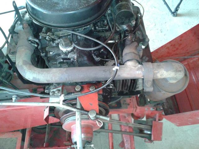

peterson9934 4 #1 Posted October 9, 2012 I want to replace the exhaust and muffler on my C-145 (has a 17hp kohler). It has at least 1 leak. I can't seem to find anywhere on the internet where I can find a new one. It doesn't have to look like the one I have now. I like the "stacks" but would settle for one just out to the side. Is threaded pipe an option for this motor? Just looking for suggestions. Share this post Link to post Share on other sites

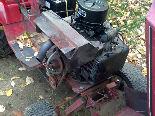

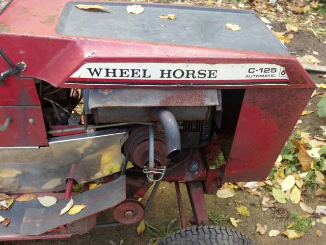

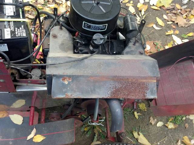

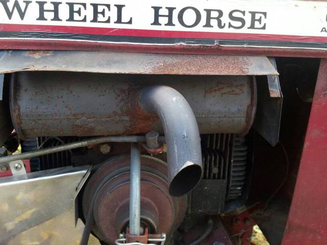

SousaKerry 503 #3 Posted October 10, 2012 The 17 I have on my C-125 came from a simplicity, I reused the muffler that it came with, which was mounted where your collector pipe is. I had to move the outlet and alter the sheetmetal a bit but it works and sounds mean!! I'll take a picture of it when I get home tonight. Share this post Link to post Share on other sites
SousaKerry 503 #4 Posted October 10, 2012 Here is mine Share this post Link to post Share on other sites
peterson9934 4 #5 Posted October 10, 2012 Thanks for the pics. Nice tractor. Share this post Link to post Share on other sites
