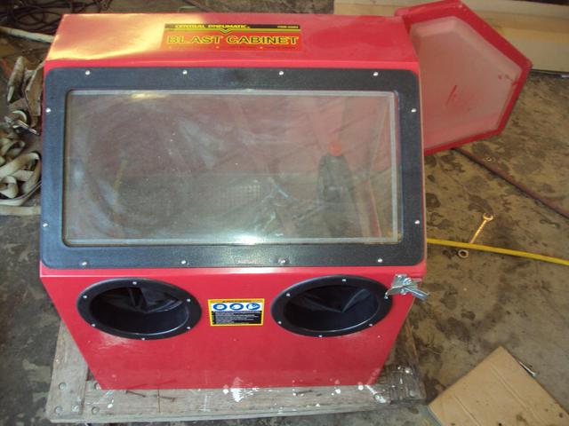

I"ve had a sand blaster for awhile now, and it works great, but makes a really big mess. Most of the time the things I want to sand blast are small, so I picked up a blast cabinet from Harbor freight today. It was on sale for $119, and I had a 20% off coupon, so I got it for less than $100. :woohoo: I'm out of sand at the moment, so I'll get some Monday, and try it out. I did'nt have my camera with me, and its already at my shop, so I copied a pic of it from Harbor Freight to post here, because I know what would happen if I didn't! :wwp::ROTF: Anyone else have one of these, if so does it work well?

The cabinet came with 3 of the disposable platic liners to protect the plexiglass window. I too have a suction feed blaster that I really like, but for small jobs this should be nice, as there will be no mess, and it catches all the sand. :thumbs:

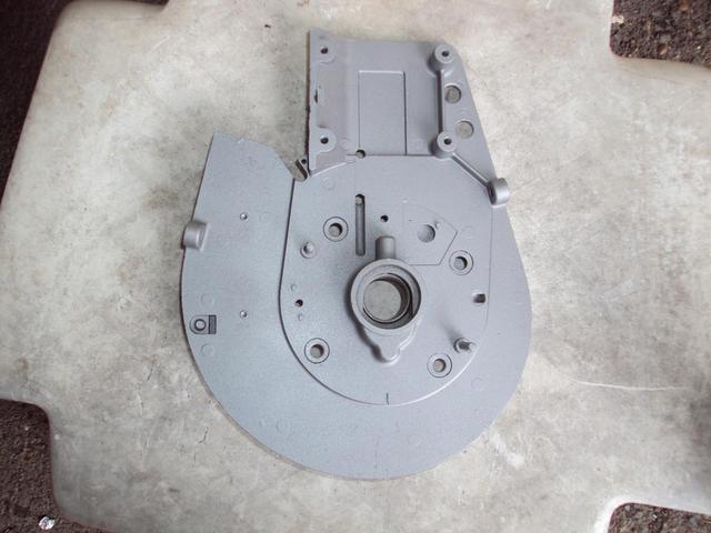

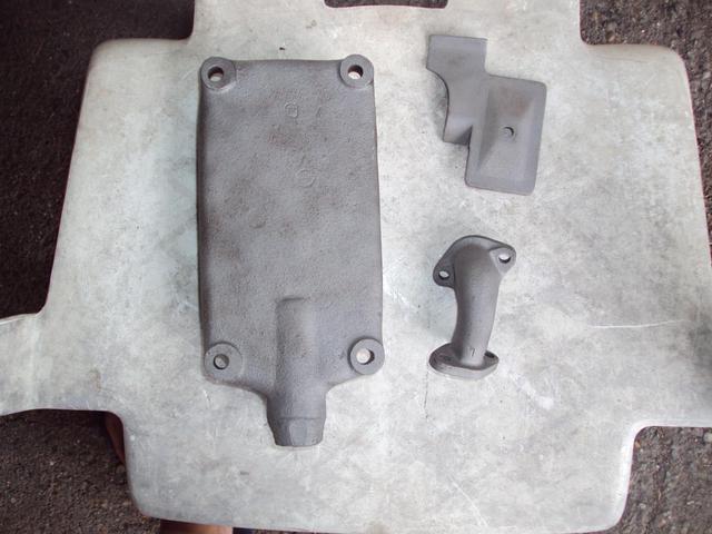

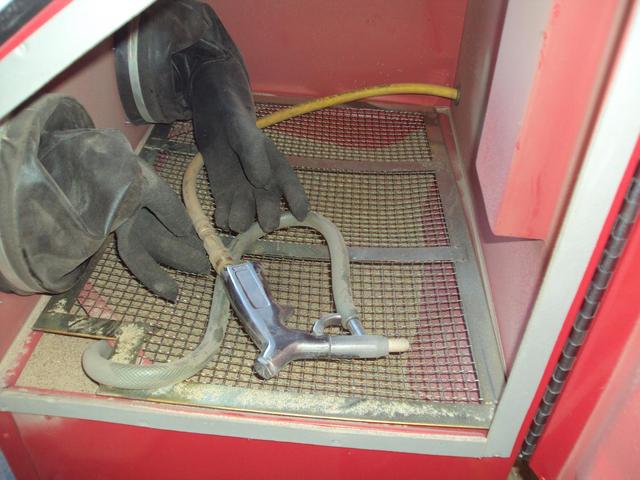

Never heard of such a thing. I'll have to check it out. :thumbs: I'm loving my blast cabinet. It cleans parts great, and doesn't make a mess that takes weeks to clean up, like my sand blaster. :woohoo: Here are a couple pics.

Remember to check and change your nozzles!
bowtiebutler956
If its working well, why would I need to change the nozzle? It came with a couple extras, but I wasn't sure why. :dunno: I'm still pretty new to sandblasting.
Matt :flags-texas:
grnlark
The abrasive coming through the gun is also abrasive on the nozzle tips. It will eventually wear the tips warranting replacement thus the reason you got extras.
Pull the nozzle out of the gun and compare it to a new one.If you do a lot of blasting and use the aggressive media they will wear fast. I used carbide nozzles from TP. 3 times the cost but about 10 times the life! :)
