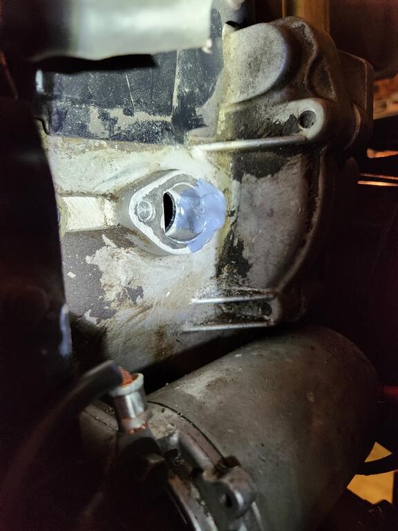

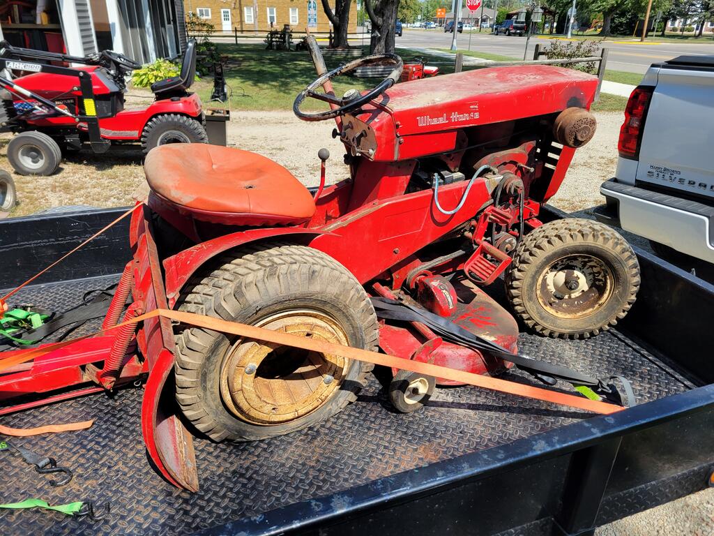

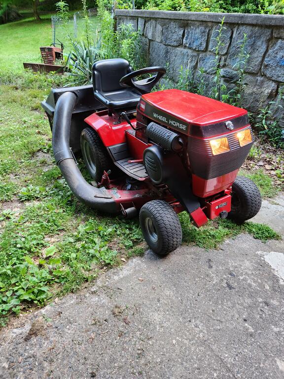

stratostar250 934 #2753 Posted June 24, 2023 2 minutes ago, stevebo said: Yes it has my friend! Hope you and the rest of all here have been well! I miss it here!! 😢 She's a 312-8 with about 300 hours. Plow was only used once, came with bagger and weights. Super nice shape except the right foot rest needs some paint. 😆 previous owner was replacing fuel pump and one bolt broke in the block, he tried to drill it out, but it broke the block kinda. Gonna try to clean it up, fill with JB weld, tap and send it 😆 I think she'll be 👌 7 1 Share this post Link to post Share on other sites

WHX?? 58,345 #2755 Posted June 25, 2023 13 hours ago, stratostar250 said: previous owner was replacing fuel pump and one bolt broke in the block, he tried to drill it out, but it broke the block kinda. Can't imagine how that happened. Pics of the damage... and repair please. 1 Share this post Link to post Share on other sites
stratostar250 934 #2756 Posted June 25, 2023 1 hour ago, WHX?? said: Can't imagine how that happened. Pics of the damage... and repair please. I always get excited and never take before pics. I cleaned it out and set it up with JB weld last night. It didn't really settle how I wanted it to, but it may be okay, we'll see. 4 Share this post Link to post Share on other sites
19richie66 17,950 #2757 Posted June 25, 2023 11 minutes ago, stratostar250 said: I always get excited and never take before pics. I cleaned it out and set it up with JB weld last night. It didn't really settle how I wanted it to, but it may be okay, we'll see. If worse case scenario happens, just put a simple block off plate there and tap it for a vacuum port. Get you a vacuum operated fuel pump and your in business. 👍 2 Share this post Link to post Share on other sites
stratostar250 934 #2758 Posted June 25, 2023 16 minutes ago, 19richie66 said: If worse case scenario happens, just put a simple block off plate there and tap it for a vacuum port. Get you a vacuum operated fuel pump and your in business. 👍 That's what I was thinking. He said there was a hole in the block. The second I saw it in person, I thought, " OH this will still run somehow" 4 Share this post Link to post Share on other sites

stratostar250 934 #2761 Posted June 25, 2023 24 minutes ago, WHX?? said: Won't be for lack of trying... Update, she runs, have very minimal seepage from the fuel pump mating area! Just did my lawn for an hour with it. Great machine. So glad I picked it up. I did found out that one of the coil mounts was actually broken off of the block, too. but I lined it up and tightened down the one that was still good and she fired right up and runs awesome! I'll probably have to fix that fin one day tho. 3 3 Share this post Link to post Share on other sites

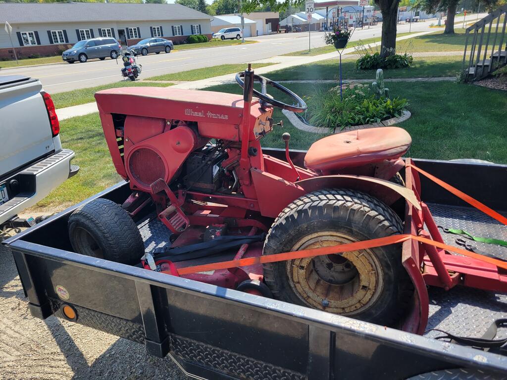

WHX?? 58,345 #2774 Posted September 1, 2023 Doesn't look to be orginal ... 1045 painted over...I best come get it.... 2 Share this post Link to post Share on other sites
rjg854 13,419 #2775 Posted September 2, 2023 Nice, wheel weights, deck, and plow, besides. 1 Share this post Link to post Share on other sites
