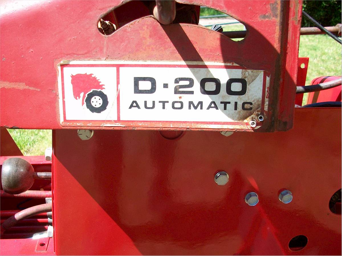

It was noticeable with this tractor that little care was taken to put the factory decals on squarely and there had obviously been another decal on the engine tin, probably added by the dealership. These seem to have been a poorer quality which later held moisture and caused rusting - had a similar example with my C-120.

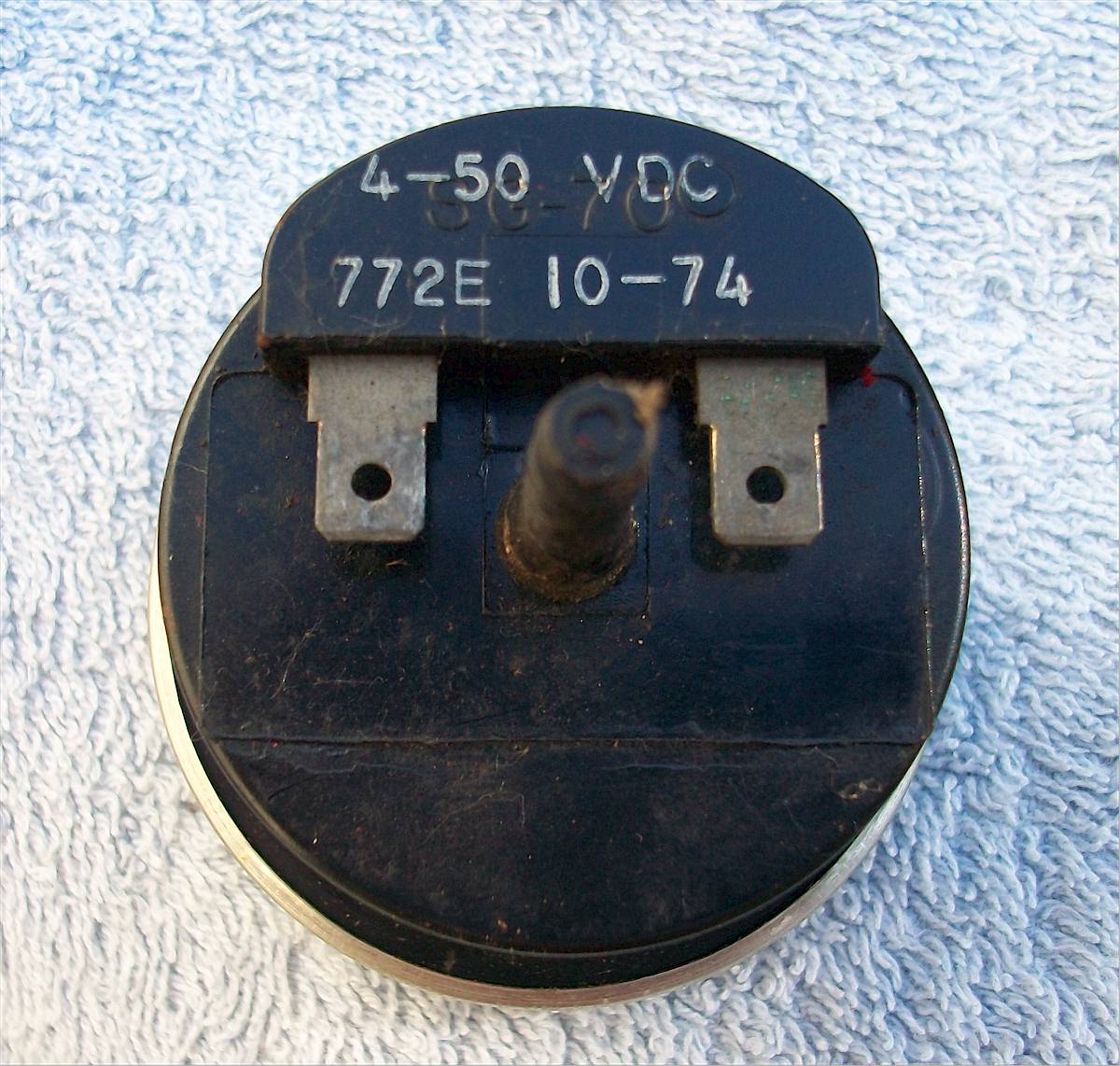

Based on the Toro reference set there was no decal on the parking brake knob which seems strange given that the other two similar knobs did have. I decided that I'd add one and Mark obliged by adding it to the set.
This knob had deteriorated much more than the others, leaving it with a dull brownish finish that was not removable with solvent. I considered spraying it with satin black paint but that would in time have worn off so tried some 'T-cut' (the stuff you use to remove the oxidized layer of paint that builds up over time on older automobiles). It did a reasonable job which I didn't push too far as I wasn't after a pool ball finish.
You can see the brown stuff that came off, probably oxidized bakelite or whatever the knob was made from.

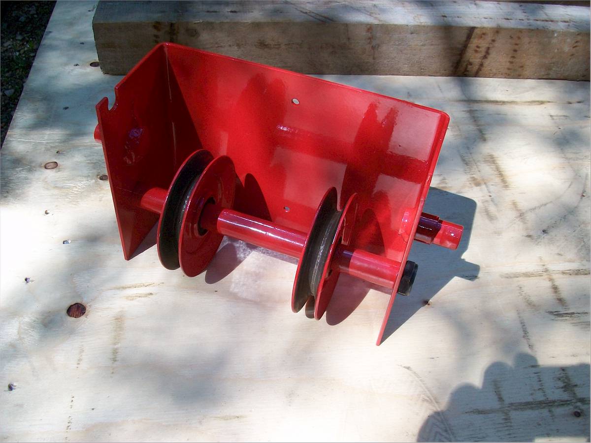

As mentioned in the last update post, the mule drive from Lonny arrived and it was in much better shape than I imagined from his description.
A bit of play in the pulley bearings but not enough to worry about, a bit rusty on the front face, but otherwise very serviceable. The only bit requiring attention was one of the studs that the Tach-a-matic grips onto.
The weld had obviously given up and the stud detatched from the frame at some point leading to a reasonable repair but with a major flaw. On one side brazing had been used to strengthen a stress fracture in the frame and on the other side a good strong weld made to hold it in place. Problem was (as you can see in the photo I think) it wasn't welded on squarely.
To my mind there's only one way to repair this sort of issue, you have to grind away the old weld, clean up the parts and line them up corrctly before welding them together again.
Using the longer of the spacer tubes from the pulley shaft to extend the stud together with a couple of magnets to hold everything true a good repair was possible and....... it fitted first time.
A couple of hours work and I had the makings of a very usable mule. Way less time than it would have taken me to fab one from scratch so I will remain eternally grateful to Lonny for that - Thanks mate! Tomorrow I'll shot blast it and get the primer on hopefully.
Once the engine oil / dust mix was removed it became clear that the pulleys were just zinc plated with no signs of red paint. I assume this indicates they've been replaced at some point so I'l probably just keep them that way as the oily muck seems to have preserved them pretty well.
Getting back to decals, first thanks Ian for that photo - it's good to know that these tiny WH logos did appear on some tractors though it appears not on all.
I'm debating whether to put the 'do not kick the living daylights out of this starter motor' decal in its original place or not. On mine it ws applied to the end of the motor which isn't exactly a flat surface though it did manage to stay on for all those years. Putting it on the side seems to be a better placement - any thoughts on that one?
Lastly (for now) - the black 'Caution' sticker as in here's how to use this tractor for maximum safety and minimal enjoyment. It's shown on the Toro site listing and Mark made me one but there was no evidence of there ever having been one on my 'D''. Has anyone got a photo of where it was placed when they did fit them?

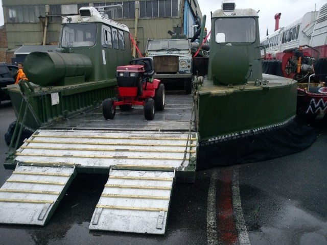

I've got the decals on the 312-8 now and not to be outdone with your Landrover picture, I attach picture of the SRN5/6 Well Deck hovercraft, with a landy and the wheel horse aboard.

Andy , you are showing signs of joining the 'Picky with Detail Club' ....Good on Yer Mate! and it's paying dividends. The Big 'D' is looking every bit a Looker/Worker. Completion is in sight and I bet your itching to ride that 'Bad Thing'.
Like the Hover Landy Horse pic Jeff.....that would be some sight to have a Transport Chariot like that to turn up with at the Ardingly Show imagine the look on the Gate Controllers face :jaw: or :scared-eek:

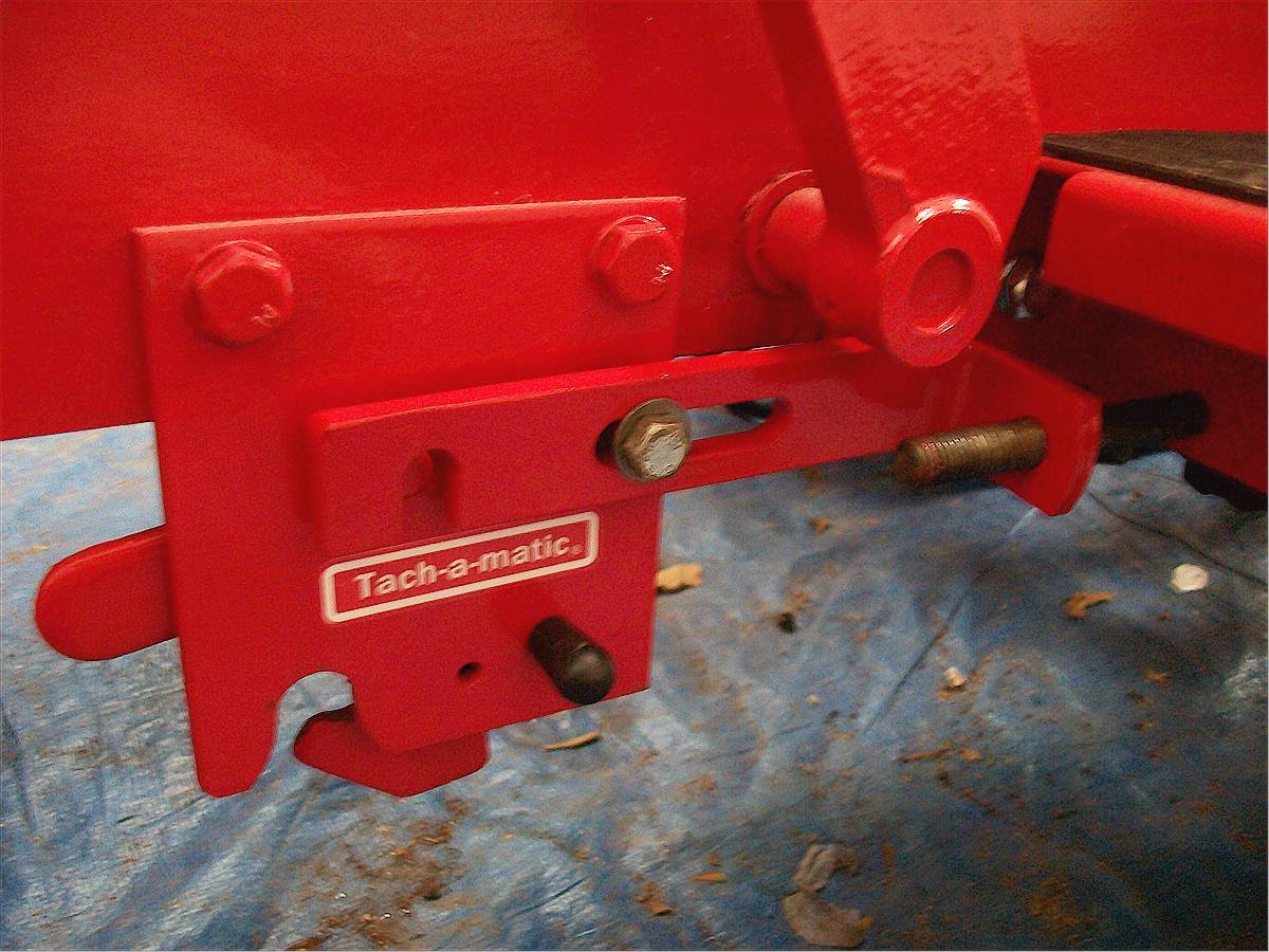

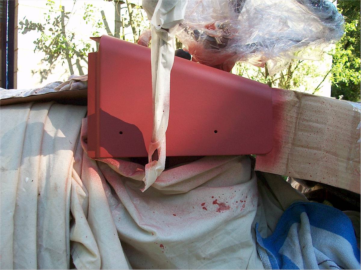

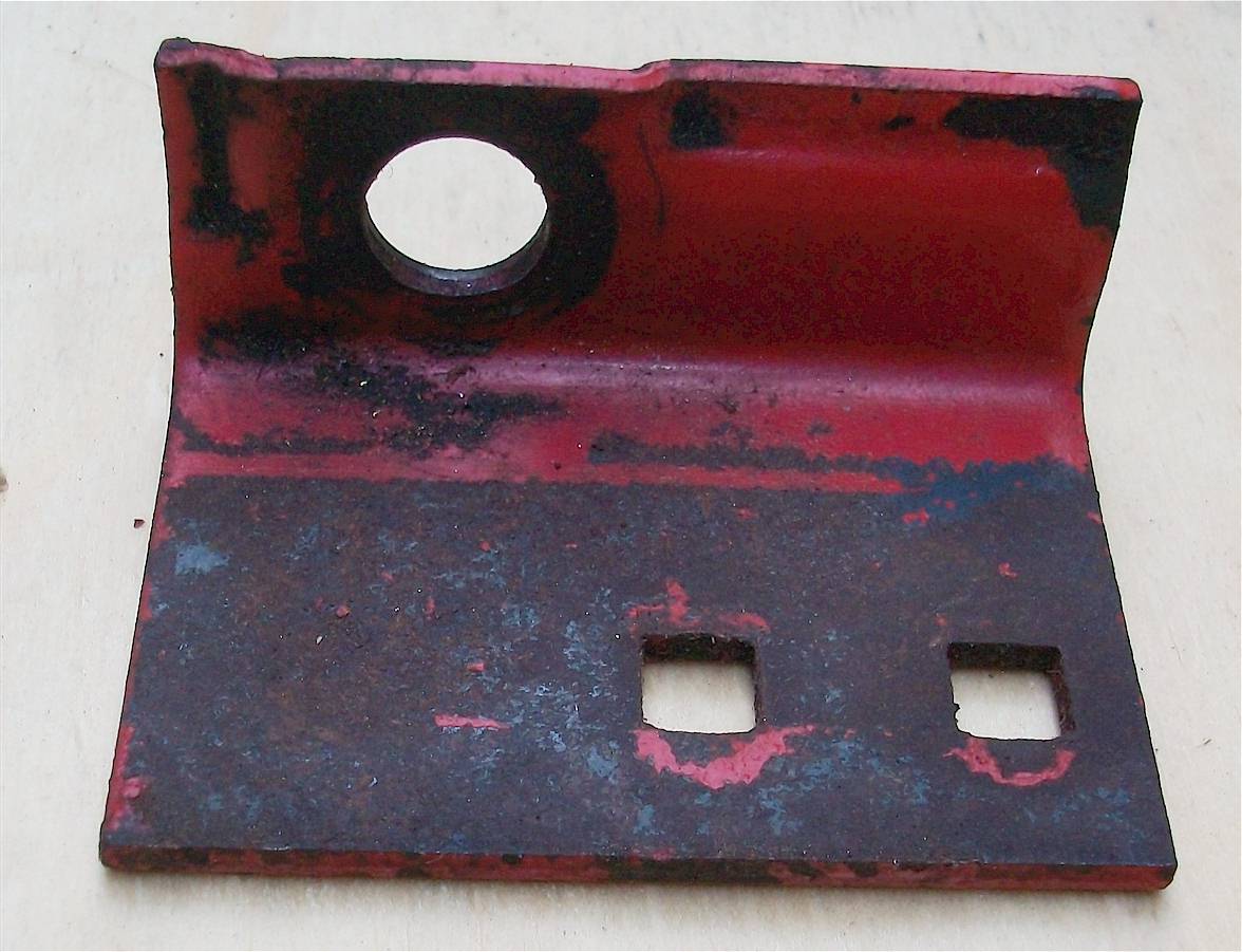

I'd been thinking about modifying a deck to fit on the 'D' and it was a few weeks ago now thatTim (Tap53) sent me the manual for a 'D' type mower deck complete with diagrams. Belt tensioning on a 'D' is achieved by an adjuster that moves the deck backwards on its hanger to take up the slack. I was just beginning to think about it having got a mule ready to fit when the paints hardened off and... suddenly there's a thread on RS about what's needed to fit a standard deck on a 'D'. As a result, Tom, (Trouty56) posted some detailed photos for me to work to which together with the diagrams finally made full sense.
Tom included a tape measure in key photos and Lonny (otrelwood) has also offered to measure up any critical dimensions I need as I go along so thanks guys and here we go ........
For authenticity (and as I don't have much imperial stock lying about) I decided to make use of the steel from the hanger assembly from a WH deck I scrapped recently.
Thought it would be a good idea to practice on a test piece first and started the bend using the smaller of the 90 degree dies
and finished it using the larger 90 degree die. The 'Heath Robinson' pressing arrangement worked well so onto the actual piece. (For reference, it takes just over three tons pressure to bend this size flat bar)
One problem with recycling old WH steel in this way is that there tend to be 'oles where 'oles shouldn't be and there was no clean length long enough so..... a bit of the bar that originally passed through the 'ole was welded in place to fill it.
One new tapped 'ole, a slot, and the adjuster from a standrd C-series mule later and we have an almost finished tensioner that's pretty close to the original.
Decided not to make the slot in it that engages the hanger until I've modified a standard one and can check that everything lines up as it should.
Tractor looks great with the decals Jeff, 'Sunday Best' rather than its working clothes eh? Hope it gets a cover on it at night!
I can't remember from my visit if that hovercraft still runs or not - if it does then I'll bring my tractors over and share the fuel bill for a return trip to Ardingly if that's ok.

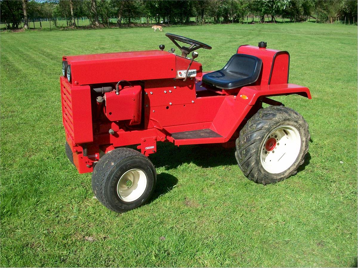

I guess it's time for a little update, little being the operative word as I haven't been able to spend a whole lot of time on the project over the past couple of weeks.

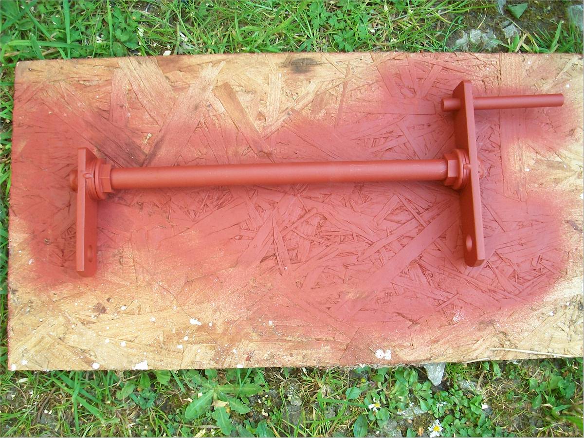

Finished off and painted the mule

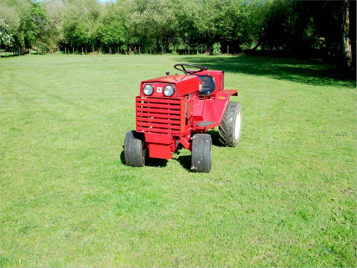

Fitted it and as it had finally stopped raining took the tractor for a drive round outside.
Finished and fitted the deck adjuster - it's probably not an exact replica but it looks ok and will do the job.
Thanks to Lonny and Bob for the photos and dimensions I've worked from which have also been used to fab the deck hanger bracket. I'd already placed the 'Tach-a-matic' decals where they were originally but noted with interest that when a deck adjuster was fitted they appear to have been placed higher between the two mounting bolts. Puzzle is - how did they know at the factory whether a particular tractor would end up with a deck or not? Hmmm.
It would have been nice to have turned up the proper looking spacer sleeves but as I don't have a lathe yet I had to improvise.
Some washers as spacers held in place with a little bead weld and instead of a steel turned sleeve we have nylon plumbing nuts on the basis that nylon against steel is better than steel on steel. I think it will look ok once it's painted red.

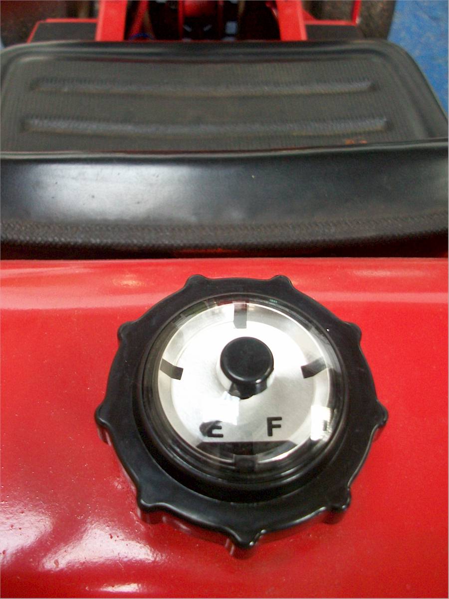

The gas cap arrived thanks to James who forwarded it on to me. I think it is safe to say that Kelch supplied the OEM factory part and the design has changed little over the years apart from an improved plastic float.
The original was 13 and 1/2" long, made no doubt to WH spec, but the nearest stadard item is 12" long. Looks good though and I now have a 'reserve' after the gage reaches empty. (sorry about photo quality - camera auto-focus in closeup mode chose the foreground)
Looks good on the tank too.
The 'E' looks distorted but it's just a trick played by the shape of the clear gage cover in the photo.

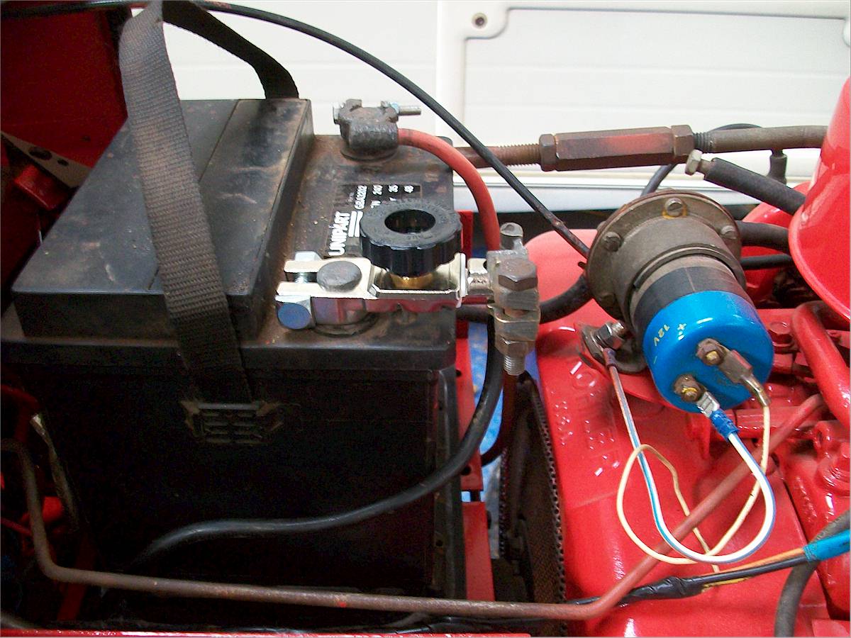

With various vintage vehicles and tractors stored together in a barn we (my son and I) have a golden rule - the batteries are left disconnected. The jeeps have factory isolators so I thought I'd add something to make disconnection easy on the 'D' and found this isolator which fits directly to thee battery post and takes the original earth lead as well.
Another bit of 'bling' thats 100% functional. Undo the thumbwheel a quarter turn and the battery's disconnected.

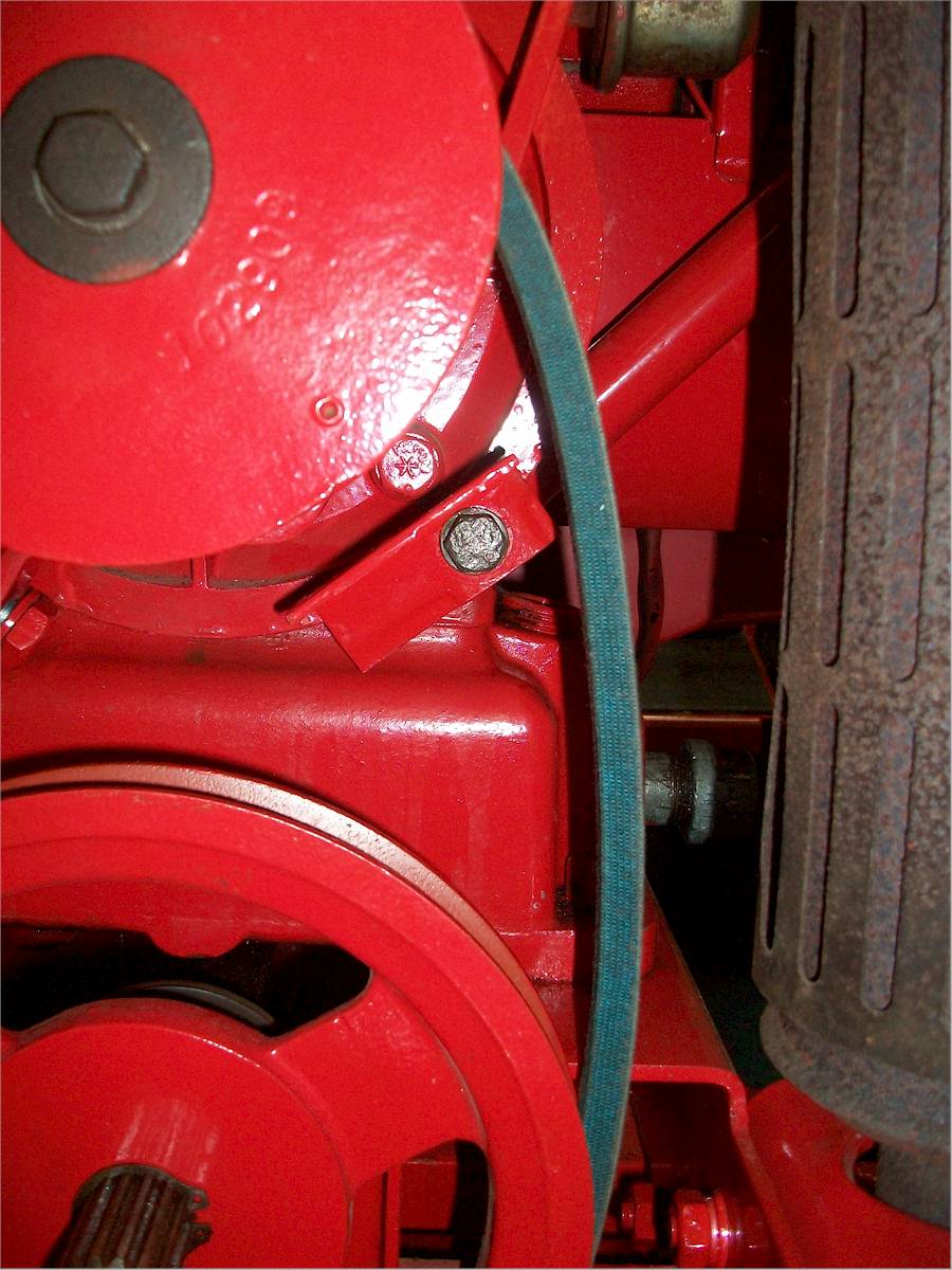

While I was back in painting mode thought it was about time I did the PTO brake bracket which is a little unusual on my example of a D-200. The brake normally mounts onto one of the PTO clutch lever arms but this is a different arrangement.
The bracket is certainly an OEM part and bolts onto one of the lugs on the aluminium engine plate.
The bracket was still in place whe I got the tractor but sadly the brake itself had been lost along with other of the smaller parts of the PTO which had been taken off. (The PTO came in kit form in a hessian sack)

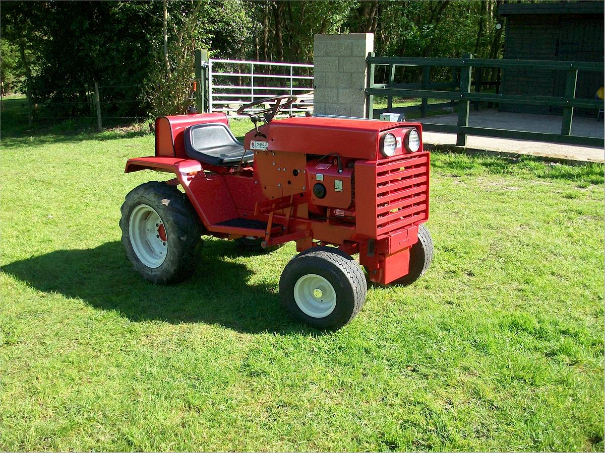

I'll sign off for now with a couple more photos of the beast on it's first outing after the rain stopped.

I am curious about the ignition coil. Is that standard for a D-200? It's very different from what I am used to seeing there.
j
otrelwood
I thought that was an electric fuel pump
JamesBe1
Haha. You're right. My bad. Serves me right for going on only a few hours of sleep.
It certainly is Lonny, and one of the better mods by a PO. Having said that, they didn't check beyond the fact that the original fuel pump had stopped working so I inherited an oil pan with way too much very thin oil in it where gas had been drawn into the crankcase via the faulty diaphragm.
My initial thoughts were to put an OEM pump back until I discovered the cost but at the end of the day I like the way that with an electric pump you turn the ign key, you can hear the pump tick a few times and know the carb is full before starting it up and getting it then to fire up 'on the button'.

Anyway, on to a little update:
As I said, the weather's been hot and sunny all this week but it's been snowing outside - the crack willow trees that surround the barn have been shedding their seed covering the grass and accumulating in corners just like snow. Today it seemed to have come to an end so managed to get outside with prepping and painting in mind.
The 'D' was about to lose it's last two factory decals - having noted the difficulty Jeff had getting the steering wheel off his, I decided some time ago to work round it by dealing with the instrument dash panel in situ. The remains of two rivets pretruding through the decal are from where a PO had fitted rubber strap type catches as I assume the original hood catches had broken. I used a MIG on the holes made in the hood for these but decided it was too risky at this point on the panel so opted for filler as it will be covered by a decal anyway.

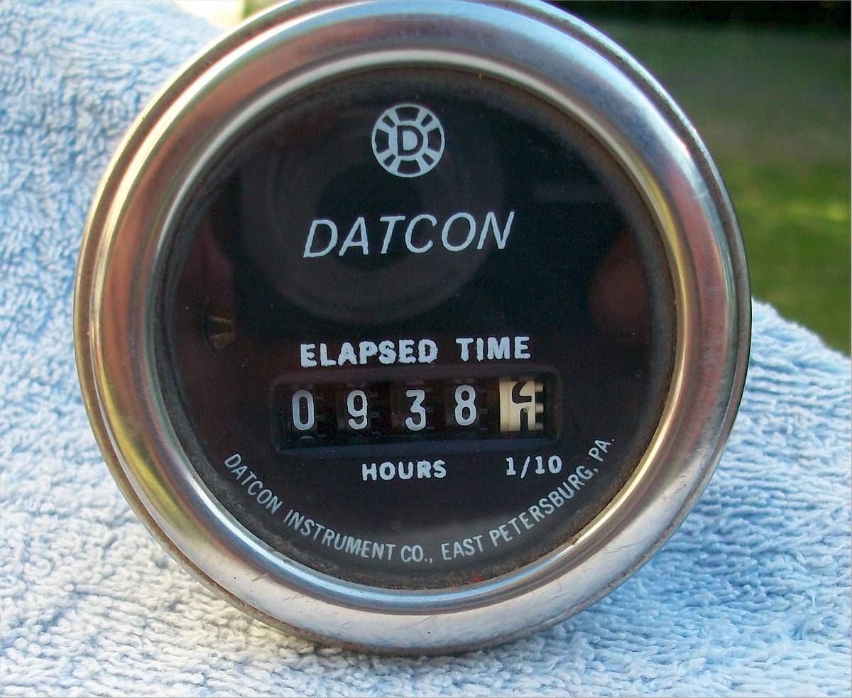

Removing the instruments raised a question in my mind that perhaps somebody will be able to answer concerning the hour meter. Is it OEM or aftermarket?
Either way there is a little mystery. The gage had obviously been removed at some point as there was no bracket holding it in place. On the back is what I would take to be a manufacturing date indicating 1974.
In a way the mystery deepens given that was way before the tractor was built. NOS perhaps?
Given the overal condition of the tractor when I got it I've always thought it must have done more hours than's on the clock.
The day's work also uncovered another little mystery that perhaps somebody can answer.
Under the decal on this side were three holes that had been there since new. On the other side were just two holes.
It occured to me that the two holes on each side look as though they may have been for a D-series solid 'badge' - was that the case with any of the models? I couldn't think of a reason for the third hole on one side though.
In case any eagle-eyed followers are wondering why the instrument dash light is still in place and masked off for painting - its because the large nut that secures it had rusted well and wouldn't turn on the plastic body without a high risk of braking it.
If you're also wondering how the plastic dash was removed with the light still in place - well that was easy, the plastic panel had split in half over the years in the sun.
I'l be interested in any answers to the puzzles. Hopefully the dash will go red tomorrow and I'll get some more of the decals on elsewhere.
