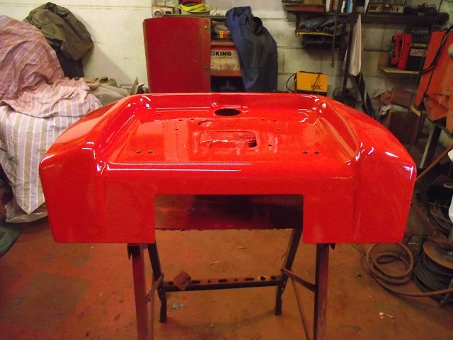

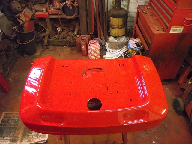

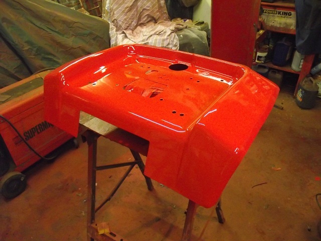

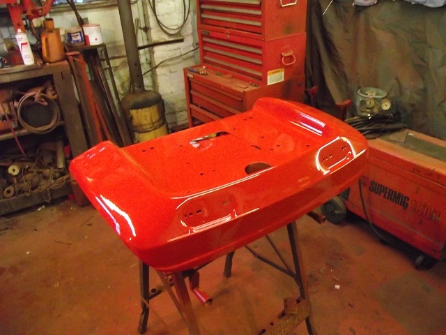

:flags-wavegreatbritain: Hooray! finally got the rear fender painted. Got fire lit and waited for the temp to rise a bit while i finally had a bit of a tidy up. I even found my bench at last. Managed about three coats of paint. Looks ok at moment, will see wot it looks like in mornin. probably take all week to dry though unless i can bring it into house. Snowin now though so can't carry it across yard.
Anyway heres a few pics. Enjoypost-6158-0-61851600-1328378195.jpgpost-6158-0-85263400-1328378202.jpgpost-6158-0-88538900-1328378207.jpgpost-6158-0-31298900-1328378215.jpg

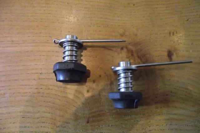

Hopefully will get fender on next weekend. Cant wait. got seat springs and hingy flappy bit painted today aswell, and made some new buffer springy seat switch things. (see pic) Will post more pics as i progress. Thanks for looking.post-6158-0-17635900-1328471280_thumb.jp

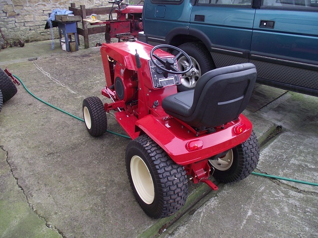

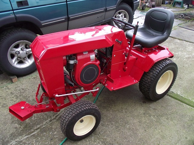

:UK: Thought i'd post a few updated pics of my c105 resto;post-6158-0-86001200-1330281855.jpg
Finally got it out side and had a little play.
Noticed a few minor niggles like loose nuts and bolts etc.
All seems ok. Just need to move seat forward a bit. Cant reach pedals properly! :banghead:
Need to repaint fender a some point too. Must have been too cold when i painted it and looks like it may have water in it. Tiny lttle bubbles appear when its cold and damp and makes it feel like sand paper. A bit annoying.
Going to paint the rest of my snow blade this week and then just need to wait for warmer weather to fit new decals. Need an urgent tidy of bench too! looks worse than my first post. gonna update pics of that too!

Your :wh: looks very sharp Raider, I like the black chaff screen with the chrome securing bolts, and your new seat looks coooomfy. :)
Did that model have a red bonnet originally or did you prefer red rather than black ? looks good whichever. :twocents-twocents:

Think the bonnet was black down middle. Might paint it black at some point. Thanks for looking everyone :banana-tux:
