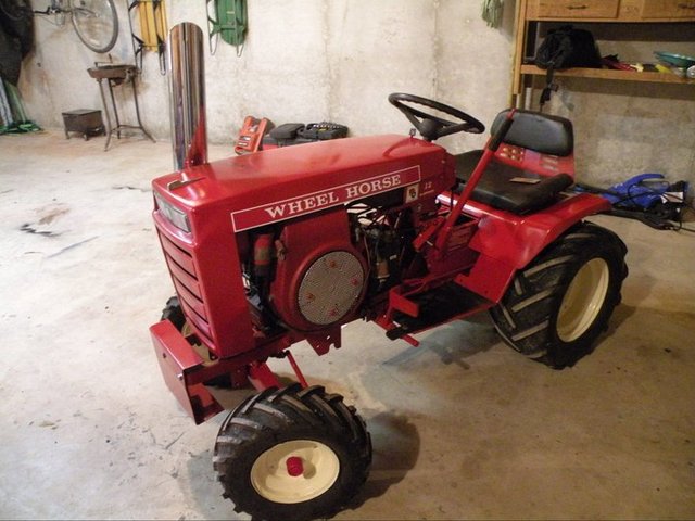

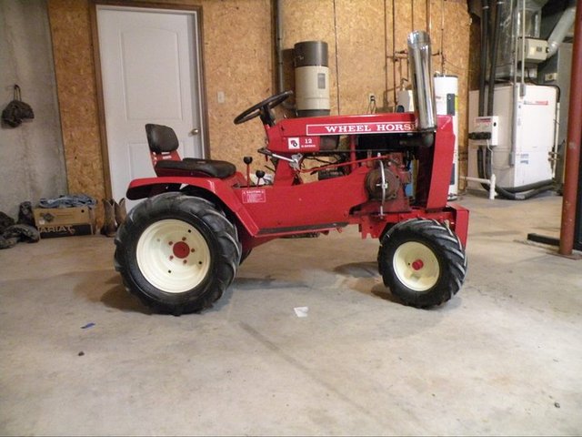

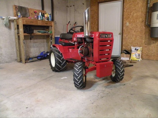

John Voss 76 #1 Posted January 17, 2012 I restored this tractor last year but now I am intersted in pulling. This tractor has the stock 12hp Kohlor and 8spd rear. I have Carlisle Super Lugs on it. I know I need a pulling hitch and wheelie bars. What else should I consider? Also will the transmission hold up the way it is considering its all stock? Do I need to put a stiffer clutch spring on it? Basically just need a baseline of everything I should consider to get it ready to go for this spring. Thanks Share this post Link to post Share on other sites
