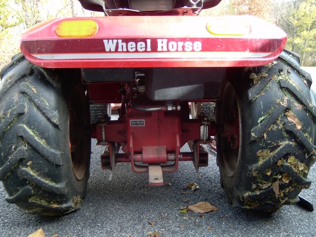

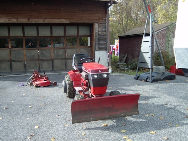

nylyon-(Admin) 9,035 #1 Posted November 8, 2007 How to install a 48" plow on your tractor, this assumes that the mower deck and mule drive are already removed. FIRST lay the plow on the ground in front of the tractor with the angle handle detached. SECOND roll the tractor over the plow until the engagement rod is just below the rear axle hitch. Be sure that while moving you move the angle handle out from under the tractor. Lift the rear of the plow into the hitch and lock it in. THIRD lower the lift handle and install the lift rod into the lift bar. Reattach the angle handle using some grease on the piviot points. That's all there is. I love how easy attachments are with these Horses... 6 Share this post Link to post Share on other sites

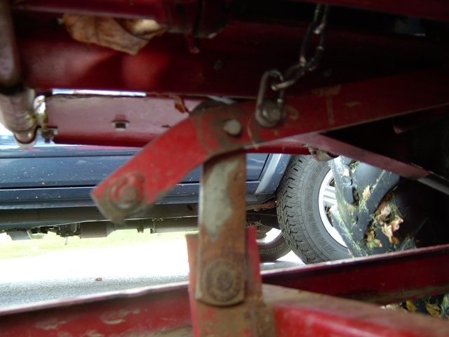

Tankman 3,528 #10 Posted October 15, 2016 There are two different lift links. 1 Share this post Link to post Share on other sites
elcamino/wheelhorse 9,363 #11 Posted October 21, 2016 @Tankman When you use the long link do you also use the short link. I am a little confused. If not does the lift bar just flop around? Share this post Link to post Share on other sites
Tankman 3,528 #12 Posted October 21, 2016 7 hours ago, elcamino/wheelhorse said: @Tankman When you use the long link do you also use the short link. I am a little confused. If not does the lift bar just flop around? Use both links to stop the flop. Share this post Link to post Share on other sites
elcamino/wheelhorse 9,363 #13 Posted October 21, 2016 @Tankman that's what I thought , but when I tried using both links , I could not get the plow to lift at all. I need to go back and see if I have the links in the right holes. Most days I don't know up from down or left from right. Share this post Link to post Share on other sites
shallowwatersailor 3,221 #14 Posted October 21, 2016 24 minutes ago, elcamino/wheelhorse said: @Tankman that's what I thought , but when I tried using both links , I could not get the plow to lift at all. I need to go back and see if I have the links in the right holes. Most days I don't know up from down or left from right. No, you only use one link. If you are using the short link (picture #3), you use the liftbar which will allow the blade to float. The long link attaches to the bellcrank directly and allows pressure to be applied to the blade. Yes, the liftbar stays loose with this arrangement, or you can remove it temporarily along with the trunnion and chain. Share this post Link to post Share on other sites
cleat 9,066 #15 Posted October 21, 2016 1 hour ago, shallowwatersailor said: Yes, the liftbar stays loose with this arrangement, or you can remove it temporarily along with the trunnion and chain. Or you can disconnect the trunnion and chain then tie them and the liftbar up out of the way if you are uncomfortable with removing it. (I personally would remove it to ensure nothing gets caught). 1 Share this post Link to post Share on other sites
