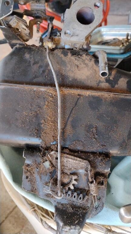

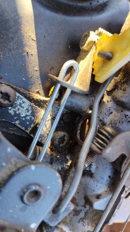

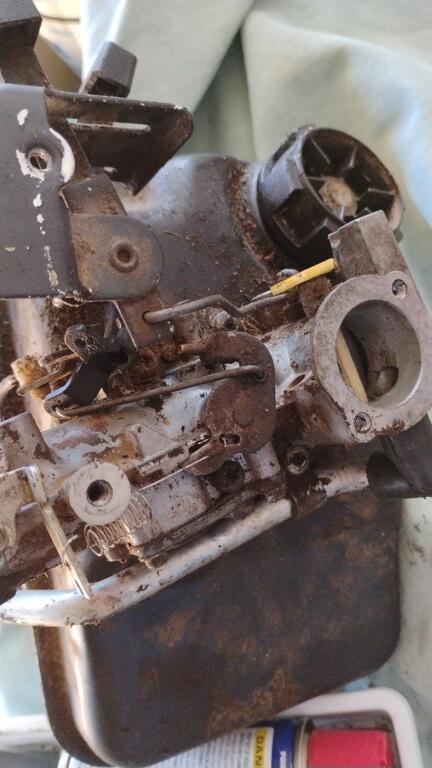

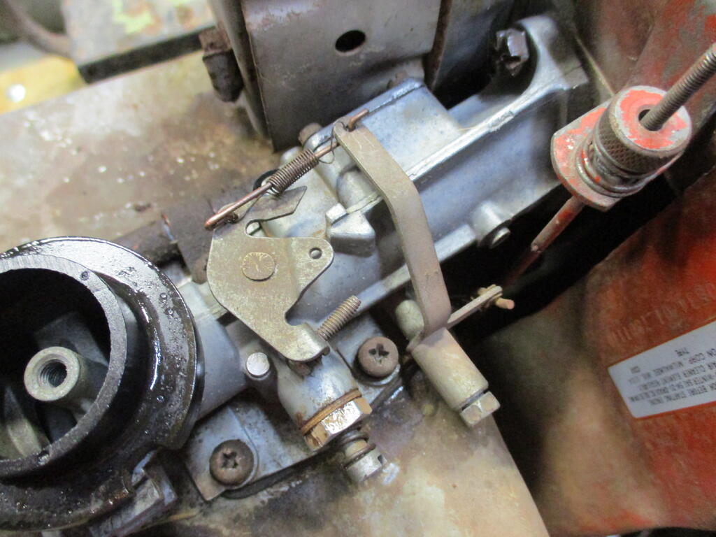

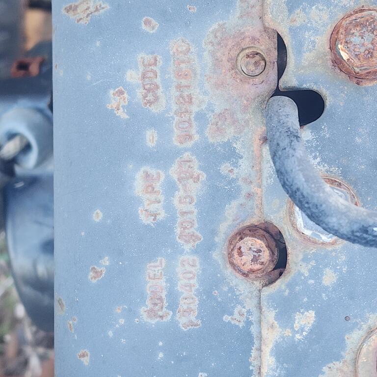

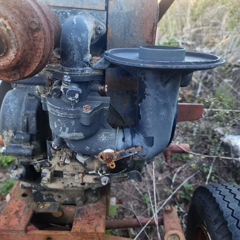

The 5 HP B&S on my Trac Vac was becoming hard starting and needing choke.   So I started to remove the carb and found it was loose from the block which is probably the problem.  The two bolts were loose about 3 turns. While I was in there, I decided to remove it and do a cleaning.
I could use a manual and pictures of the throttle and governor linkage to help me do the reassembly.
M/N 135232
Type 1036 E1
Code 930813 YA
   IMG_20261019_161341733_BURST001.jpg.4d85a8dbd9ab22857bb71cfe13310013.jpgIMG_20261019_161319305_BURST001.jpg.62683bdf95f9d170753d67dd0788e7ba.jpg
     @gwest_ca    TIA Garry.

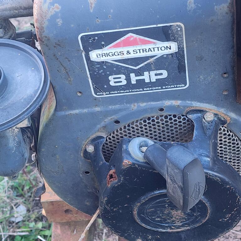

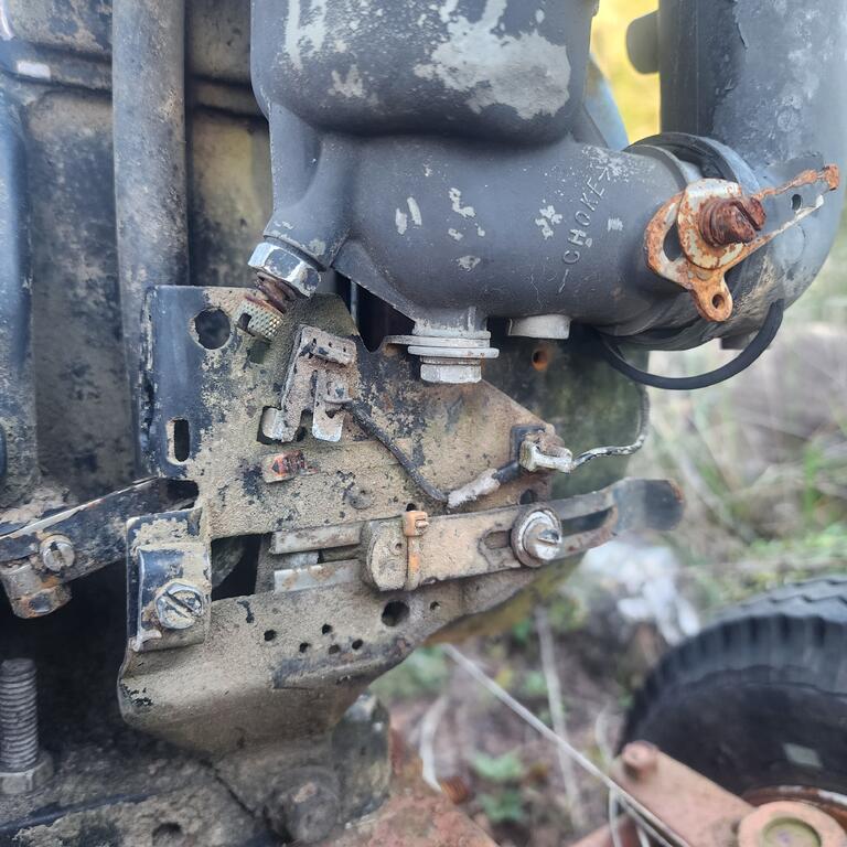

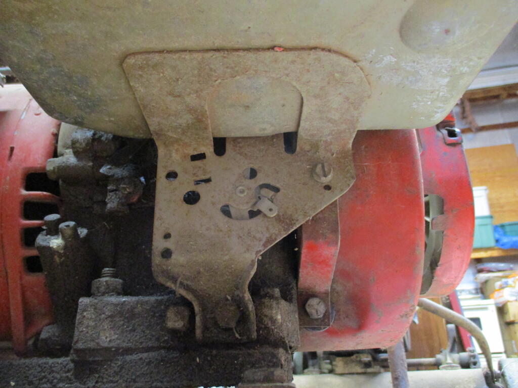

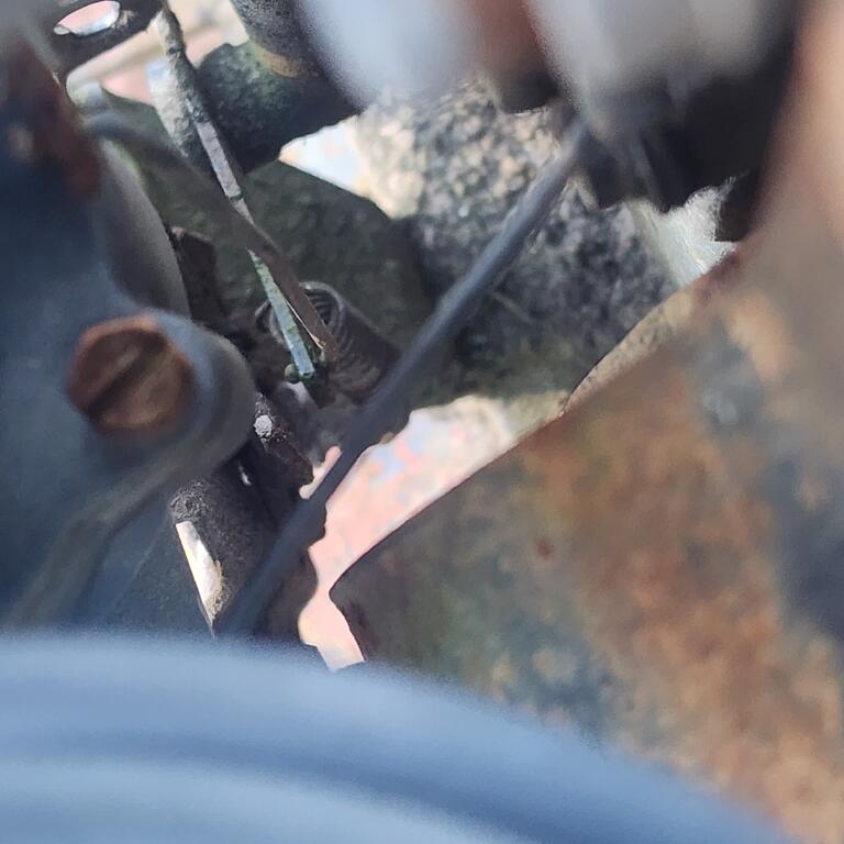

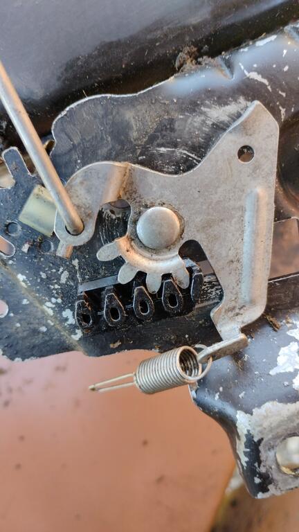

5 hp BS flat head, but it is on a generator the orange thumb screw is the speed adjustment...
Is yours an OHV??
 I have an OHV some where if that is what you need
  • Like 2

Flat head...Thanks Paul.

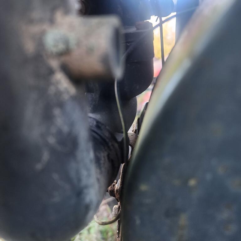

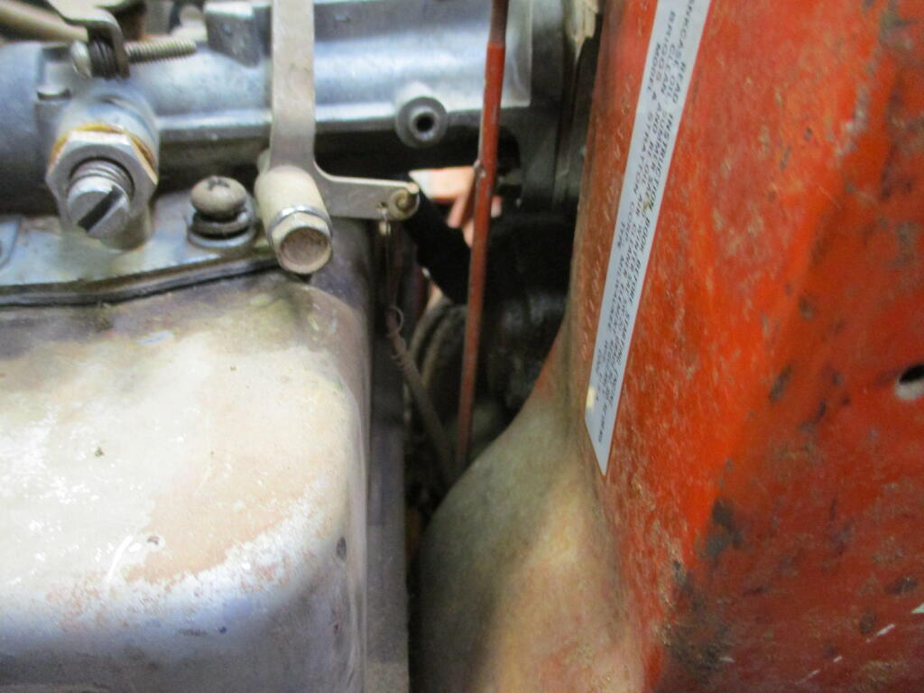

I tried, but things are so tight I could not see the gov. linkage till I removed the fuel tank.    I may have to pull the engine to reassemble the linkage from the bottom.

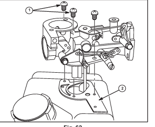

Often there is info in the B&S operator manual also if you can find one.

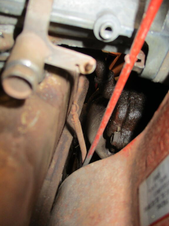

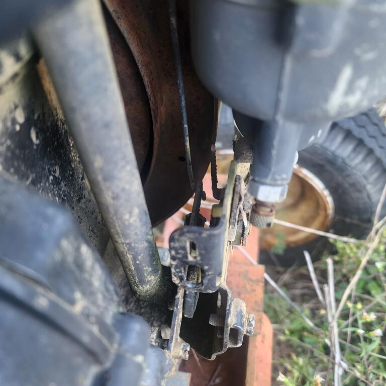

Best I can do on the bottom side.  There is  nu way to really see anything with out pulling the tank and carb  Sorry

Found an operator manual that has carb info

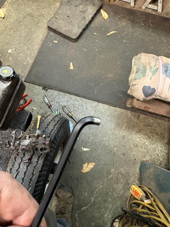

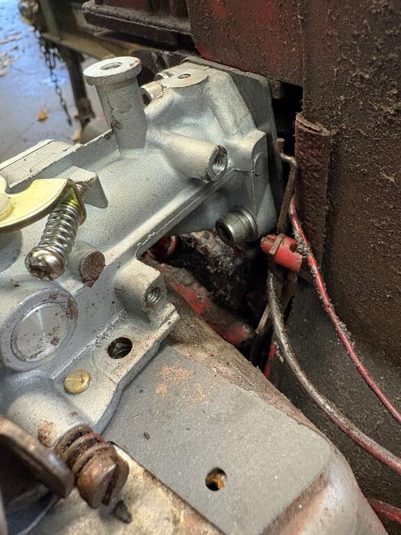

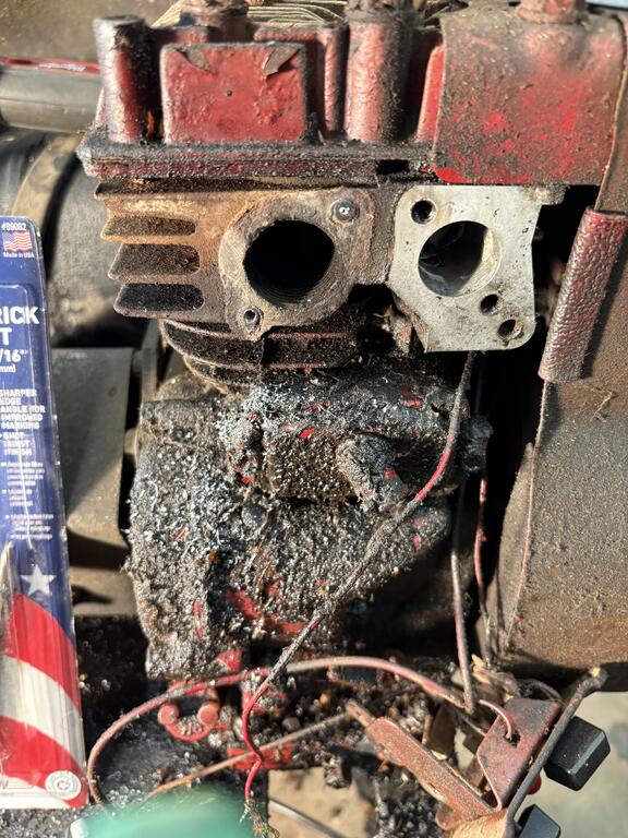

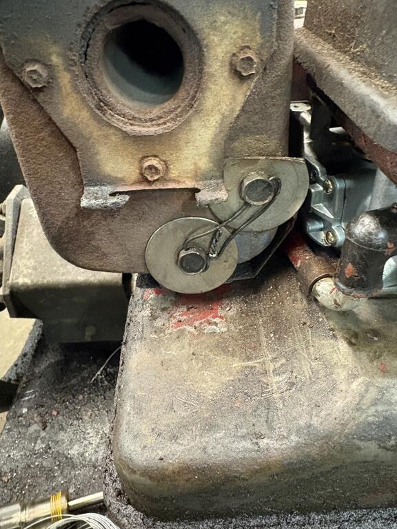

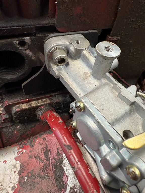

I had the same issue of the carb bolts getting loose on the 5hp B&S on our wood splitter.  This turned into more of a disaster, I tried taking off its muffler so I could have more access and both of them broke off.  After I drilled out the broken off bolts and Helicoiled new threads, I used some Allen head bolts to remount the carb.  I cut off an Allen wrench so it would reach the bolts.  That allowed me to get those carb bolts very tight!  Then I used a wire on the muffler bolts.
ri702bill
Excellent safety wire job. Note that if either bolt loosens, it tightens the wire.

The B&S single L head service manual has some diagrams.  If you give me the engine  Model and series I can look it up and scan the pages this evening
