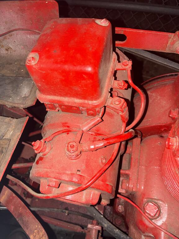

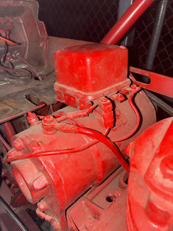

HorseingAround 1 #1 Posted 9 hours ago I have a wheel horse 885 and it does not charge. What is the issue with my tractor I am pretty good at wireing but idk why it’s not charging maybe I am missing a wire? the thick wire I think goes to my ignition I have a button to start it and a switch to turn on everything else Share this post Link to post Share on other sites

ri702bill 12,984 #3 Posted 4 hours ago That is a 4 wire regulator - 3 are visable, one is under it. Is that one intact? Remove the regulator cover and observe the contact arm area of both relays inside.One is open with the key off, it closes to allow charging. (It MUST open when off so as to not discharge the battery). The other is the one opening & closing rapidly when running. With the engine running, it should spark at the contacts in use. If not, it needs to be cleaned. All that arcing is normal, but burns and erodes the contacts. Disconnect the battery! Lightly file the contacts - do not use sandpaper! Some folks use a crisp new dollar bill instead. Hook the battery up and see if it charges. IMHO - the wiring is old and painted - there may be corrosion where the wire terminals connect to the tabs & the S/G. A good cleaning is in order too. 2 Share this post Link to post Share on other sites
squonk 48,076 #4 Posted 2 hours ago Wire from the battery should be on the center terminal of the regulator 3 1 Share this post Link to post Share on other sites
953 nut 69,152 #5 Posted 1 hour ago Is this a new problem that just started? I think @squonk has spotted the problem for you. Below is a simple wiring diagram that shows how he functions of the wiring system interact. You do not have lights but the lighter is connected to the "L" on the regulator. 1 Share this post Link to post Share on other sites
