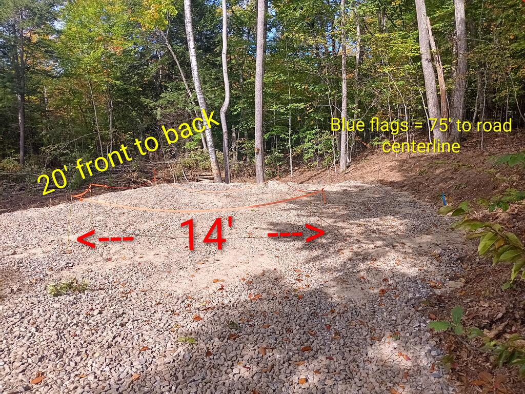

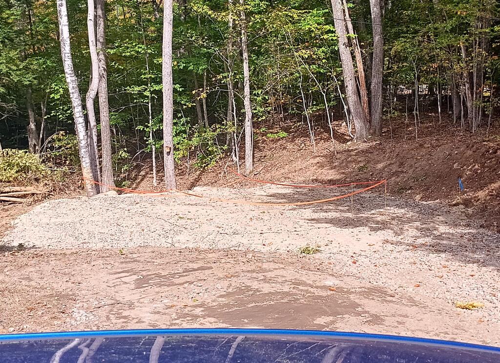

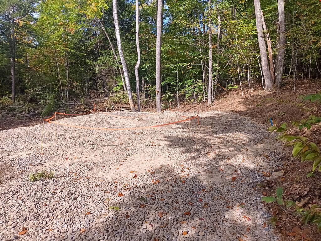

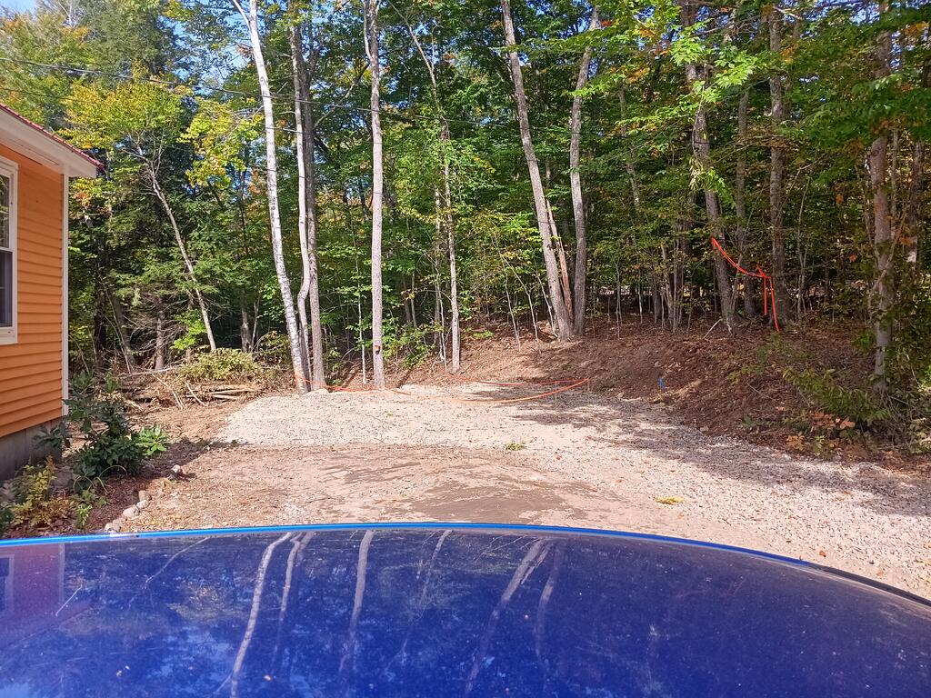

ebinmaine 81,178 #1 Posted October 4 (edited) In October of 2025 we bought ourselves a new camper. Smallest least expensive model we could get and yet still more than we needed in features. We had it tarp covered last winter and always intended to build a hard sided structure. Both Trina and I are firm believers that campers (and many other things) should be protected from the sun and precipitation as often as possible. After waiting patiently for about 10 months to get an excavator here for site prep, we're finally ready to get our part of the building process going. The camper living space box is approximately 13' long by 8' wide. Add the hitch and we need a 16' minimum storage length. After a fair bit of reading and searching we decided on this metal framed unit for the beginning of the structure. At 14' x 20' this will be more than large enough for the camper trailer and several extras. Other pieces of equipment and tools will also be stored here. Once the above pictured structure is built we'll add the rest of the metal to fully enclose it. There will be large doors both front and rear. Here's a few pics showing the proposed location of the new camper cover building. This would allow us to drive a tractor out the back side of the building because it's about 8' from the drop off by the trees. It would also allow us to drive a tractor along the right side of the building and be able to use the ramp our excavator operator left for us. That ramp is to the right of the 3 trees at pic center, and curls around to the left and behind them. This pic shows proximity to the house. Better zoom. The openings of the ends are 14.3' according to the online pics. 20 foot front to rear. 14.8' to top middle peak. The blue flags are for the Code Enforcement Officer to see so he knows we actually measured. Not guessed. 75 feet is the minimum amount of setback. We'll have about 79' to the angled support leg closest to the road. Today I ordered a set of 16 mobile home anchors. These are USA 🇺🇸 MADE. 30" depth with a 4" round fan width. By the chart I found we should use 12 of them for a 130 MPH wind resistance. If we get a realistic half that it'll be fine. One big thing to figure out will be how to open the front for the full 14' wide and 13 ish foot tall door. Edited October 4 by ebinmaine 7 Share this post Link to post Share on other sites
ri702bill 13,319 #2 Posted October 4 Eric - are you planning to do a concrete pad for the frame and trailer to sit on? A very small amount of pitch - 3/16" per foot would suffice for the inner portion... 1 Share this post Link to post Share on other sites
ebinmaine 81,178 #3 Posted October 4 10 minutes ago, ri702bill said: Eric - are you planning to do a concrete pad for the frame and trailer to sit on? A very small amount of pitch - 3/16" per foot would suffice for the inner portion... At a later date it's possible. Not in the initial build. There is plenty of drainage for water runoff and melting snow in the current base of rocks/sand/gravel. It would be great to have the stability of a concrete area once the new aggregate is settled. 2 1 Share this post Link to post Share on other sites

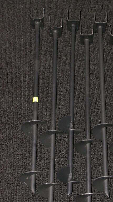

8ntruck 9,405 #4 Posted October 4 What are you going to run the anchors into? The new fill? 1 Share this post Link to post Share on other sites
ebinmaine 81,178 #5 Posted October 4 14 minutes ago, 8ntruck said: What are you going to run the anchors into? The new fill? Yes. No other option. We really don't have serious issues with wind damage. (Knock on wood) After reading multiple online posts I believe we should not have a heavy duty post attachment point that goes below the standard frost line. Our frost line is between 36" and 48". It seems the mobility of the frost creates a break point. With that in mind I decided to go with the 30" depth anchors. 2 Share this post Link to post Share on other sites
8ntruck 9,405 #6 Posted October 4 Hopefully, the auger pitch will find its way between the stones. 1 1 Share this post Link to post Share on other sites
ebinmaine 81,178 #7 Posted October 4 1 minute ago, 8ntruck said: Hopefully, the auger pitch will find its way between the stones. On one side it'll be fine. There's several feet of new fill on the left/downhill side. On the upward/right side.... we shall see. 2 1 Share this post Link to post Share on other sites

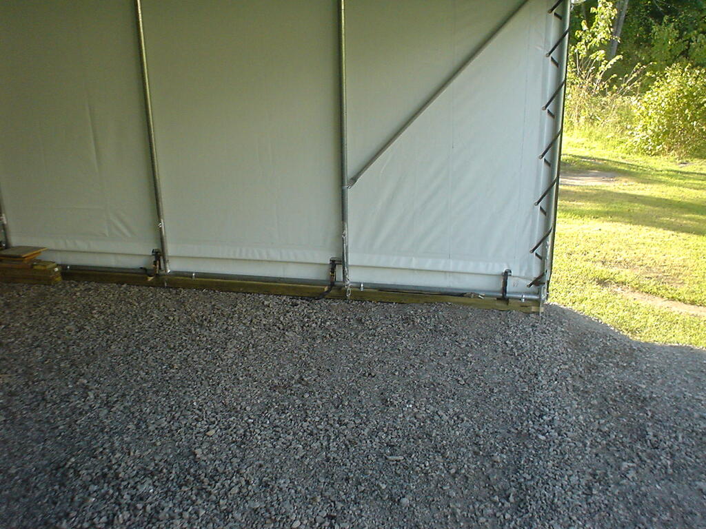

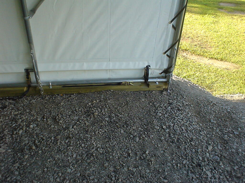

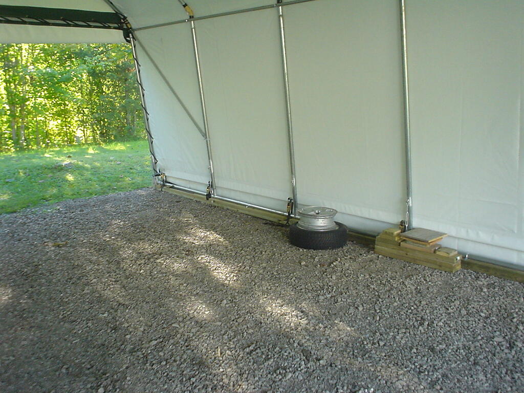

Beap52 2,526 #8 Posted October 5 I am in total agreement with you two on keeping a roof over stuff. If it's got wheels and tires, I want it under cover. When our kids had a carport installed. I laid 2x6 treated wood under the runners. I felt this kept the metal runner off the gravel and hopefully last longer. Our camper's carport is bolted down to the cement pad. I park the camper on rubber mats. I hope this is better on the tires than parking on cement for months on end. Great project you've got going on. 1 1 1 Share this post Link to post Share on other sites
ebinmaine 81,178 #9 Posted October 5 9 hours ago, Beap52 said: I laid 2x6 treated wood under the runners. I felt this kept the metal runner off the gravel and hopefully last longer I might do this specifically under the contact points. I'm wondering if it would help keep the metal legs from digging into the ground some. 2 Share this post Link to post Share on other sites

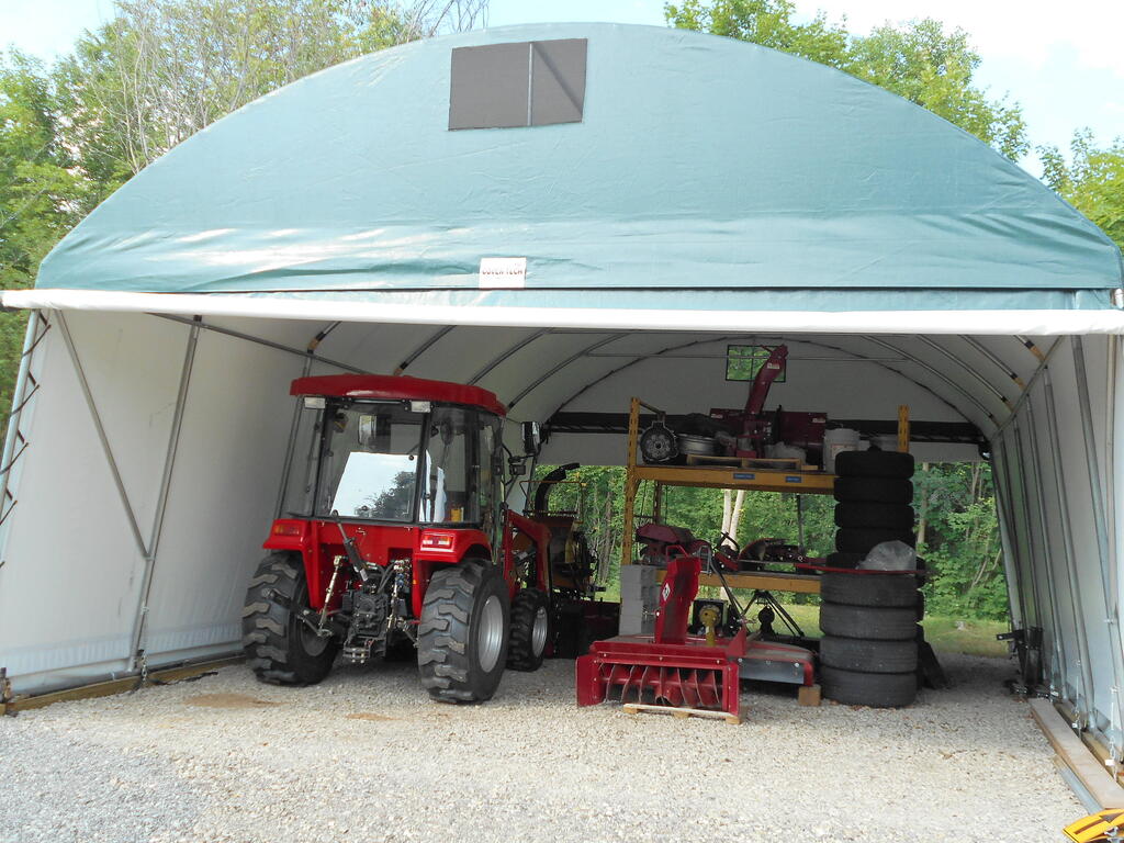

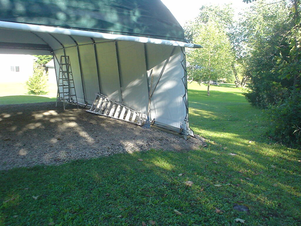

cleat 9,409 #12 Posted October 9 On 10/4/2026 at 8:26 PM, Beap52 said: I am in total agreement with you two on keeping a roof over stuff. If it's got wheels and tires, I want it under cover. When our kids had a carport installed. I laid 2x6 treated wood under the runners. I felt this kept the metal runner off the gravel and hopefully last longer. Our camper's carport is bolted down to the cement pad. I park the camper on rubber mats. I hope this is better on the tires than parking on cement for months on end. Great project you've got going on. My 20x30 tent garage is sitting on two layers of pressure treated 2x6 with the upper layer notched for the tension straps. I did this to keep the steel frame off the ground and to gain the 3" of extra height I wanted for my tractor with cab to pass in easier. It has been 12 years now and the wood & metal are getting along just fine with no rot or corrosion. + 1 2 1 2 Share this post Link to post Share on other sites
kwalshy 267 #13 Posted October 9 Eric, Who did you purchase your car/camper port from? Thanks. 1 Share this post Link to post Share on other sites
lynnmor 9,073 #14 Posted October 9 Some people use railroad ties for a base when installing metal buildings. If you have a good source they should outlast the new generation of treated lumber. 1 1 Share this post Link to post Share on other sites
rjg854 13,425 #15 Posted October 9 2 hours ago, cleat said: My 20x30 tent garage Is that a Cover-All product? 1 Share this post Link to post Share on other sites
cleat 9,409 #16 Posted October 9 27 minutes ago, rjg854 said: Is that a Cover-All product? It is a Cover Tech. I had it made and shipped from New Brunswick. Frame is still perfect but it will need a new cover in the next year or two. 1 Share this post Link to post Share on other sites
rjg854 13,425 #17 Posted October 9 6 minutes ago, cleat said: It is a Cover Tech. We used to erect Cover-All buildings for the company and many of the things I was looking at looked familiar to the way they were put together so that was the reason for my inquirery. I didn't think they had products that small. 1 Share this post Link to post Share on other sites

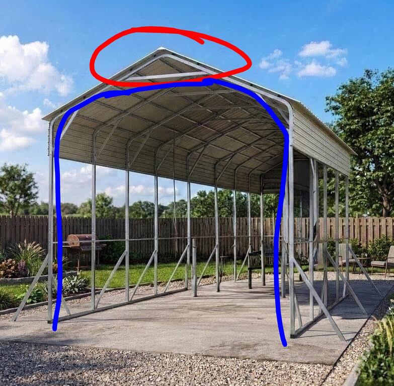

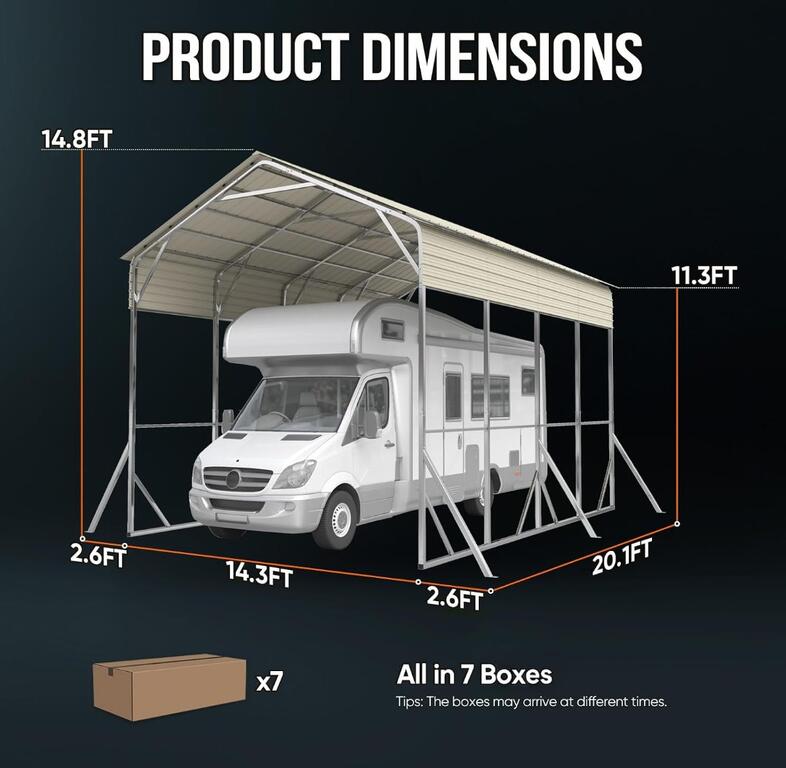

sjoemie himself 3,274 #19 Posted October 10 On 10/4/2026 at 10:30 PM, ebinmaine said: One big thing to figure out will be how to open the front for the full 14' wide and 13 ish foot tall door. Meaning the front of the shed is not that big once it's installed? Are you wanting to go with swing-open, sliding or maybe even roll-up doors? If going swing open I think a bolt-on solution would be best. Make a frame out of zinc coated square tubing and rivet or bolt everything together. Then clad the metal frame with same material as used on the sides of the building. Should give a nice and sturdy but lightweight door. Hinges can be simple barndoor style hinges and can be bolted to the structure and doors. With some planning ahead you can probably get them to swing open 180° if not 210° to get them out of the way of everything. On the part of storing the camper on the tires. Investing in a few cheap axle stands might save the expensive rubbers from getting a flat spot. 1 Share this post Link to post Share on other sites
ebinmaine 81,178 #20 Posted October 10 1 hour ago, sjoemie himself said: Meaning the front of the shed is not that big once it's installed? Are you wanting to go with swing-open, sliding or maybe even roll-up doors? Swing open is the only option. Sliding or roll up won't open enough of the end for the camper to get in. I need the door to open to approximately the blue area. Possibly considering a bi fold design as well. 1 hour ago, sjoemie himself said: If going swing open I think a bolt-on solution would be best. Make a frame out of zinc coated square tubing and rivet or bolt everything together. Then clad the metal frame with same material as used on the sides of the building. Should give a nice and sturdy but lightweight door. This is pretty much what I'm thinking. Another door frame material to consider is pvc pipe. I'm also considering a door made mostly of sheet goods like pvc. Very costly though. 1 hour ago, sjoemie himself said: Hinges can be simple barndoor style hinges and can be bolted to the structure and doors. There are also long thin strap style hinges. Those have the advantage of a long swinging piece with multiple points of attachment. 1 hour ago, sjoemie himself said: With some planning ahead you can probably get them to swing open 180° if not 210° to get them out of the way of everything. On the part of storing the camper on the tires. Investing in a few cheap axle stands might save the expensive rubbers from getting a flat spot. This camper has its own rear jacks. I also have a set of jacks to add to the front. So it won't be an issue here. Interesting point...... the tires getting a flat spot... depends who you ask and obviously, how long it stays in the same position. Opinions on tires are as plentiful and dividing as engine oil, truck brands, religion, or politics. You MUST do this and you CAN’T do that covers the exact same piece of advice in the same paragraph. Ahh well..... 1 Share this post Link to post Share on other sites
sjoemie himself 3,274 #21 Posted October 10 2 hours ago, ebinmaine said: sheet goods like pvc. Very costly though. Don't have any experience with that. Is that laminated sheet? My gut says it might be heavier than steel though. 2 hours ago, ebinmaine said: strap style hinges Yes, those are the ones. Think we're talking about the same hinges. About bi-folding doors, I get the space saving aspect however with more moving parts comes more complexity and also more movement means more play and more places to sag or wear over time. 3 hours ago, ebinmaine said: So it won't be an issue here. All good than. Logically I would say a tire that rotates from time to time is happier than a tire that sits for looong periods, since rotating what's what it's designed for. But I'm no tire expert 1 Share this post Link to post Share on other sites
ebinmaine 81,178 #22 Posted October 10 7 minutes ago, sjoemie himself said: Don't have any experience with that. Is that laminated sheet? My gut says it might be heavier than steel though. Solid vinyl. Same as vinyl boards but 4 feet wide. Thickness varies from 1/2" to 1.25". A 4 ft x 8 ft x 3/4" thick piece is under 100 lbs. Each section of 4 foot wide by (12 to 14) foot tall door would be around 200 lbs or less after hardware like hinges and handles. 7 minutes ago, sjoemie himself said: 3 hours ago, ebinmaine said: strap style hinges Yes, those are the ones. Think we're talking about the same hinges. About bi-folding doors, I get the space saving aspect however with more moving parts comes more complexity and also more movement means more play and more places to sag or wear over time. I may be forced to fold the doors, depending on exactly where the building sets. There's a slight incline in front of it. 1 1 Share this post Link to post Share on other sites

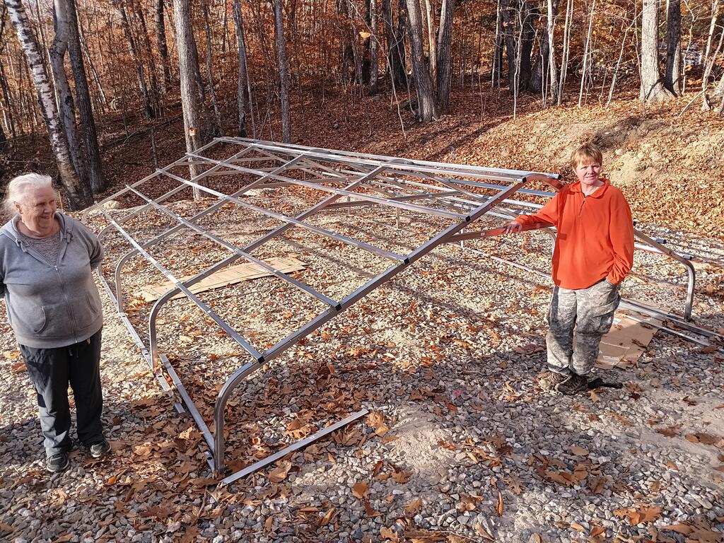

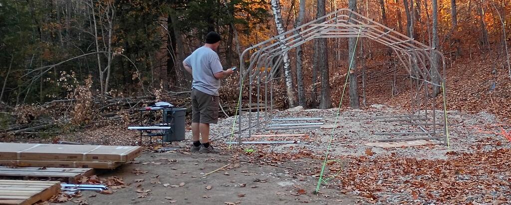

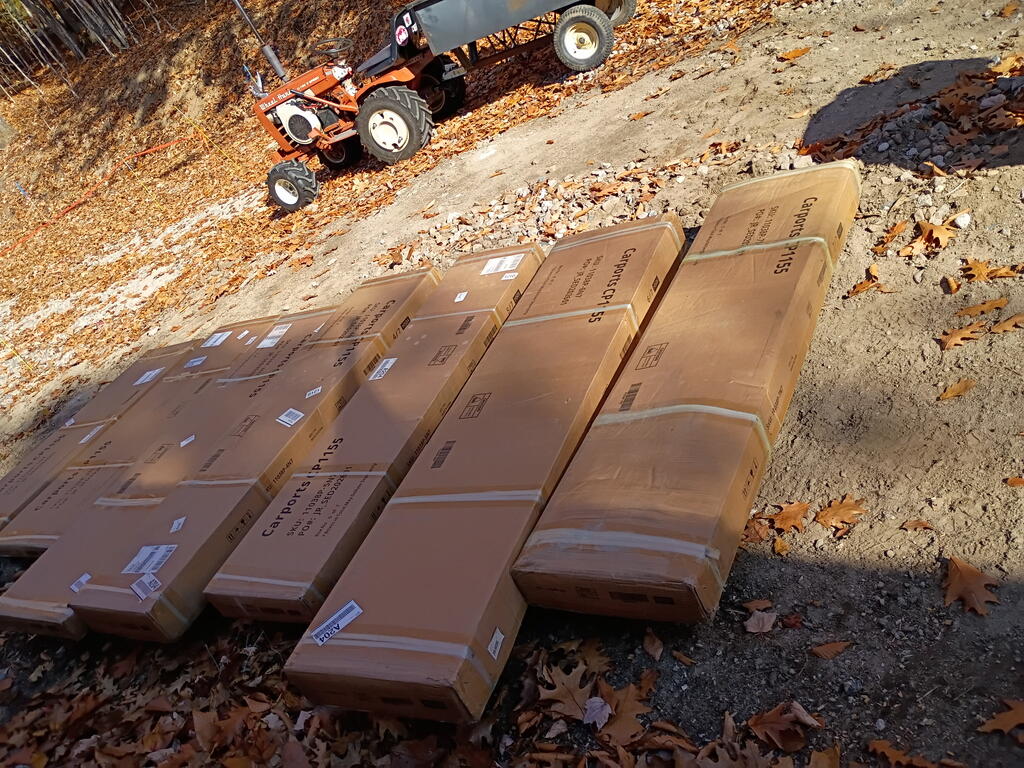

ebinmaine 81,178 #23 Posted October 30 We've begun the construction of the building. Yesterday we moved all 7 of the heavy boxes across the yard with Cinnamon Horse and the black trailer. We opened and reinspected all materials. All fasteners, framing, and brackets were separated and laid out. Today we began by making the whole roof. Added the first vertical section of the legs and all the cross braces possible. There's a slight lean away from the picture taking position here so we got some paracord and tent cords and tied the frame to the ground at 3 places. Tomorrow we'll continue with adding more screws and then the lower section of the side legs. We've decided to order good quality properly fitting metal roofing instead of using the supplied small thinner multiple pieces. For a few hundred dollars investment we'll have a much stronger build and far less possibilities for roof leaks with the better fasteners and no horizontal seams. 7 1 1 3 Share this post Link to post Share on other sites

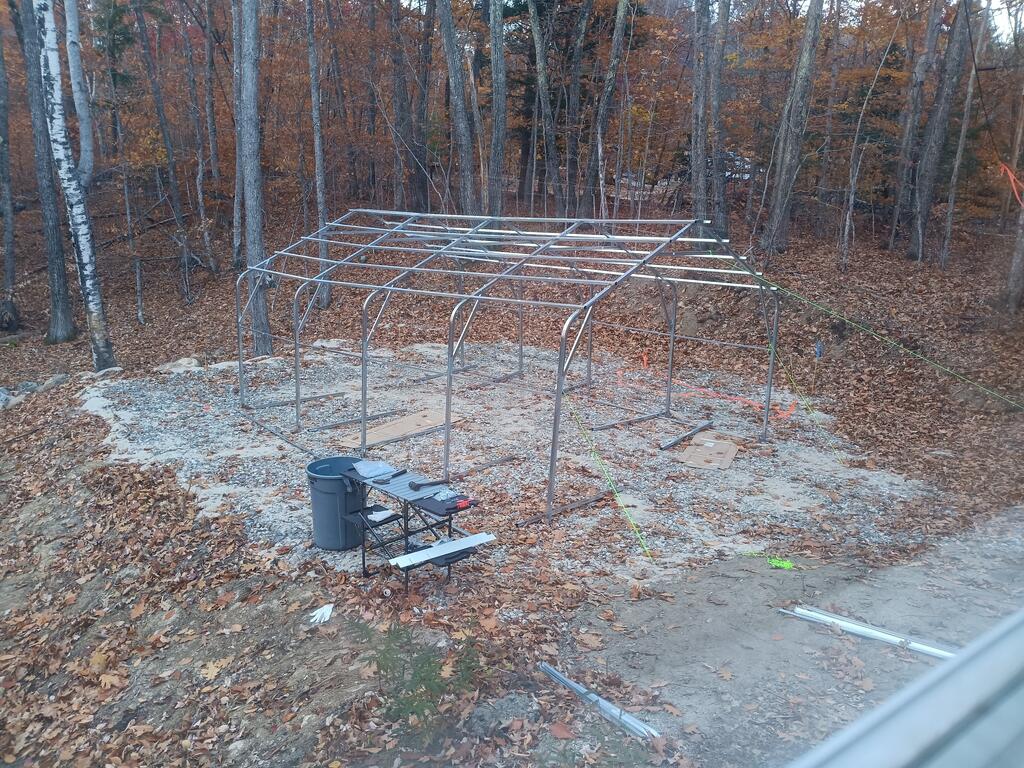

ebinmaine 81,178 #24 Posted October 31 This morning Trina, her momma, and I got the lower legs under the roof. Raising the roof structure to set the upper half of the legs was a workout but reasonably done on the first side. More challenging on the other. Different angles and more structure to move. We knew that doing the lower set would be even more "fun". I had a thought yesterday afternoon about using the tow crane setup on Cinnamon Horse to lift the middle leg high enough to get the other four legs set. After some measuring and adding the floor jack to the mix, it was just enough height to work. Here you can see the first set of lowers in place with the lower rail. We then added all the bracing for that side and moved to the last set. As you can see above we stuck the boat winch hook up in the end of the center brace. Lifty uppy and set the other legs. Hers the final part of the metal frame construction. There will be a PT 2 x 6 frame all around. Two layers on the long sides. Single thickness on the shorter ends for easier vehicle access. There's enough room to drive a C series tractor with an 8 foot trailer down the right side to access the forest ramp. Also enough room all the way around to drive a smaller rig or C series with no trailer. Purely by accident we also created a parking spot on the left for another road trailer. Maybe where the 16 foot flatbed will live for the winter. 19 hours ago, ebinmaine said: We've decided to order good quality properly fitting metal roofing instead of using the supplied small thinner multiple pieces. For a few hundred dollars investment we'll have a much stronger build and far less possibilities for roof leaks with the better fasteners and no horizontal seams. To elaborate on this.. We've also decided to order metal roofing panels for the long walls. This will offer yet more structural integrity and weather resistance. The back wall will likely be a light duty frame of some sort utilizing the kit supplied small pieces of sheet metal. The front wall will basically be a whole door as noted in a post above. Most likely a light duty wood frame with sheets of very thin Advantech. I'm definitely open to other ideas and suggestions there. 2 2 Share this post Link to post Share on other sites
Handy Don 17,688 #25 Posted October 31 (edited) 1 hour ago, ebinmaine said: I'm definitely open to other ideas and suggestions there. Force field Consider bifolds (or even accordian) to keep as much weight as possible directly supported vertically by the hinge/pivot and not trying to deform the frame when the door is open? Edited October 31 by Handy Don 2 1 Share this post Link to post Share on other sites
