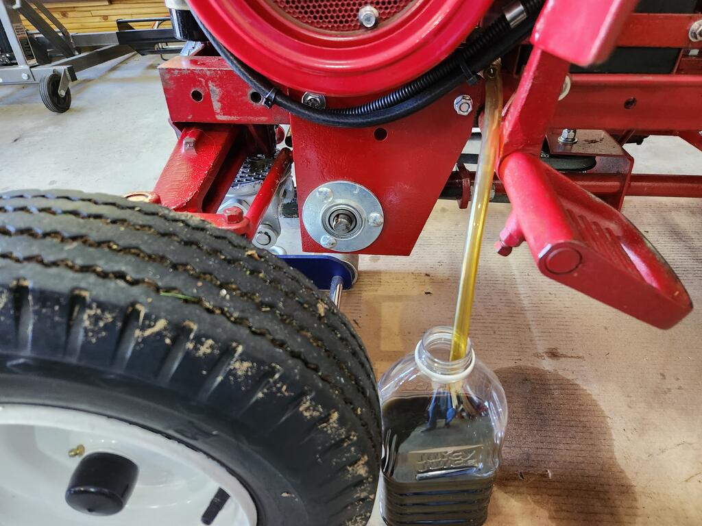

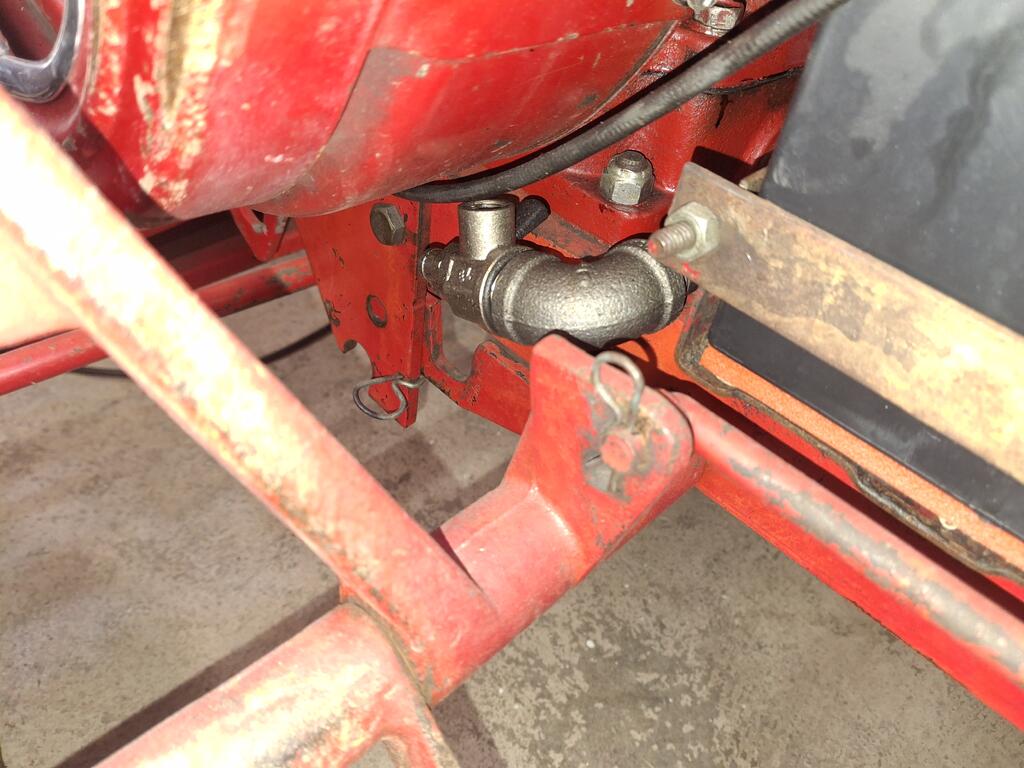

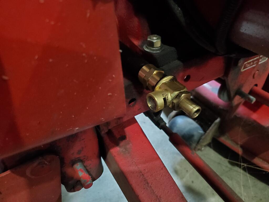

squonk 48,426 #12 Posted October 1 (edited) On 9/30/2026 at 2:01 PM, ri702bill said: Pictures?? I ask because of the added length... does it get in the way of anything? This is how I put them on the small block short framers to clear the clutch pedal. I can leave a deck on and use a hose so I don't get oil all over the deck. On my C-160 it comes out straight and again a hose end and hose to keep the deck clean. Edited October 1 by squonk 1 Share this post Link to post Share on other sites
