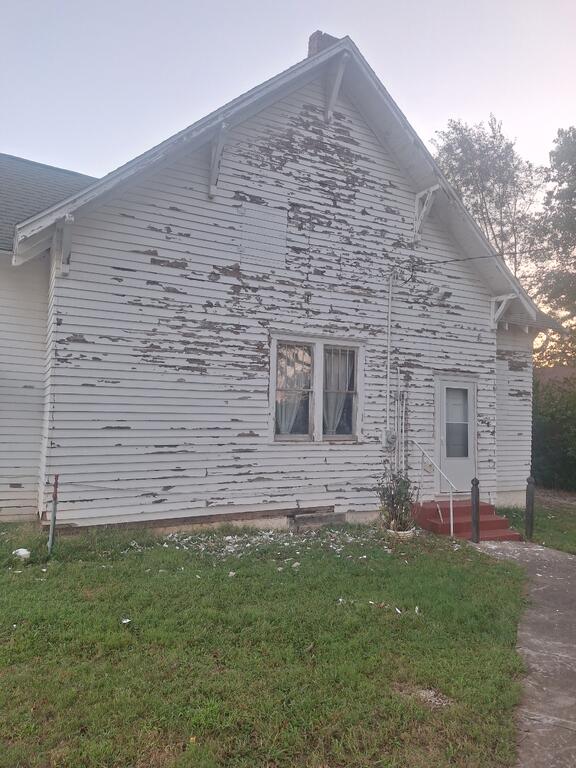

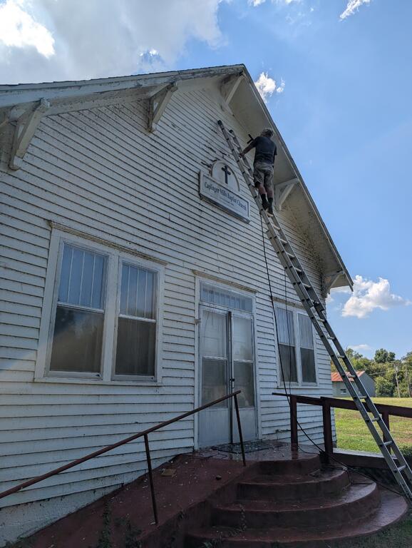

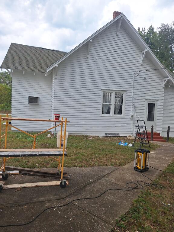

Beap52 2,535 #1 Posted September 30 A small church in our association is needing some work done to it's one hundred year old building. I was asked to lead a team to start repairs. Helpers has been pretty sparse so most of it was done by me. I didn't attempt to work on the gable ends without someone there to help with the 28' ladder. There are three pictures. One is the back of the church after I scraped the paint. Two is finished paint on the back--window is still needing paint removed from glass.--Helpers don't seem to have steady hand to cut-in paint but I'm appreciative of the help. Notice how far from level the side room's ridge is. The 2x4 rafters on the main building probably have an 8" (or more) belly. The last two paint jobs were done by folks who left overspray on the windows and storm windows. A church member believes it has been fifteen or more years since last paint job. The window sashes were almost bare of paint so it's likely been 25 or more years since they had any freshening up. Three is me power washing the front of the building. I scraped the paint, Power washed, spot primed bare wood then top coated. The helpers mainly focused on windows and yard work and helping me move ladders and tools. In addition to painting, I've made several repairs. From replacing siding ( that I made out of cedar), making new metal window drip cap, replacing three window sills. I'm doing my best to make the building more resistive to water invasion. I found it interesting that none of the windows has sash locks. In other words, until the storm windows were installed, all a person had to do was raise a window to gain entry. Interesting side note: The church is getting new roof because of hail damage. The roofing supplier loaded the roof pretty much at the the top of the valley where the side room is attached to the main roof. With the belly in the main ridge, If I was the roofer, I probably wouldn't have allowed the supplier to load in one location only. At least spread it over a larger area. A member and I measured the ceiling to floor height after the shingles were placed upon the roof. Once the new roof is installed. We'll measure to see if there was any deflection in the ceiling to floor measurement. 4 7 6 Share this post Link to post Share on other sites

lynnmor 9,081 #4 Posted September 30 With the paint falling off so often, I suspect that you have a moisture problem, painting the interior with a vapor barrier product might be worthwhile. 1 Share this post Link to post Share on other sites

Beap52 2,535 #6 Posted October 1 10 hours ago, lynnmor said: With the paint falling off so often, I suspect that you have a moisture problem, painting the interior with a vapor barrier product might be worthwhile. I agree that moisture is a problem. For one, there are no gutters and the water on the uphill side can make it's way under the foundation. I have suggested they make a swale to help re-direct the water. I don't think the building is heated except on Sundays and then they are using two of the wall hung ventless heaters--huge producers of moisture. The building is not insulated, except for 4" fiberglass batts in the dropped ceiling. Based upon my experience, not having insulation in these type of wall helps with longevity of the paint. Years ago we were working on a house with clapboard siding. After a rain, we were able to observe that the redwood siding had moisture on the backside. The house had blown-in insulation in the sidewalls and in cavities that failed to get insulation, the paint held better. I think that the insulation held the moisture and the siding could not dry as it normally would. I really don't know a solution for this small community church. Actually, I suspect the damage has already been done. Hopefully my work has added a few years to the building. 2 1 Share this post Link to post Share on other sites
lynnmor 9,081 #7 Posted October 1 11 hours ago, Beap52 said: I agree that moisture is a problem. For one, there are no gutters and the water on the uphill side can make it's way under the foundation. I have suggested they make a swale to help re-direct the water. I don't think the building is heated except on Sundays and then they are using two of the wall hung ventless heaters--huge producers of moisture. The building is not insulated, except for 4" fiberglass batts in the dropped ceiling. Based upon my experience, not having insulation in these type of wall helps with longevity of the paint. Years ago we were working on a house with clapboard siding. After a rain, we were able to observe that the redwood siding had moisture on the backside. The house had blown-in insulation in the sidewalls and in cavities that failed to get insulation, the paint held better. I think that the insulation held the moisture and the siding could not dry as it normally would. The moisture condenses on the inside of the cold siding causing the problem. It comes thru the inside wall as a vapor, thus the need for a vapor barrier, regular paint and building materials allow the moisture to pass right thru till it touches a surface that is cold enough to reach the dew point. The paint I mentioned will help but it isn't perfect. The sporadic use of the building adds to the problem since there likely is wide swings in temperature and humidity. You know the problems and others need to chip in to make the corrections or become volunteers for all future painting. 1 Share this post Link to post Share on other sites
Beap52 2,535 #8 Posted October 1 10 hours ago, lynnmor said: The moisture condenses on the inside of the cold siding causing the problem. It comes thru the inside wall as a vapor, thus the need for a vapor barrier, regular paint and building materials allow the moisture to pass right thru till it touches a surface that is cold enough to reach the dew point. The paint I mentioned will help but it isn't perfect. The sporadic use of the building adds to the problem since there likely is wide swings in temperature and humidity. You know the problems and others need to chip in to make the corrections or become volunteers for all future painting. Remember when it was fashionable to staple plastic sheeting between the studs and drywall? It wasn't long before mold was growing on drywall especially in high humidity areas such as kitchens and bathrooms. Share this post Link to post Share on other sites
