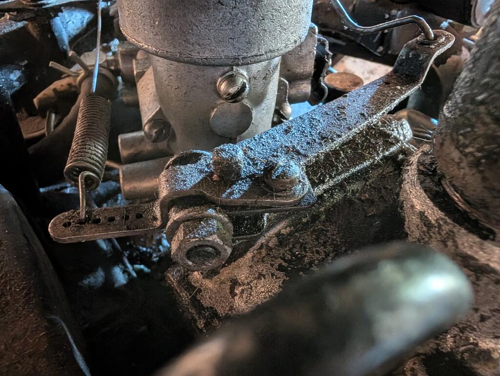

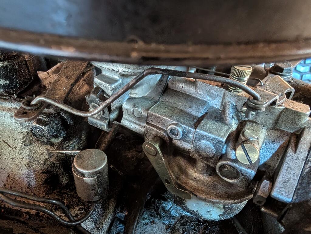

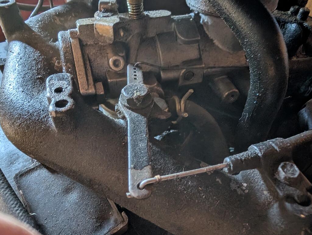

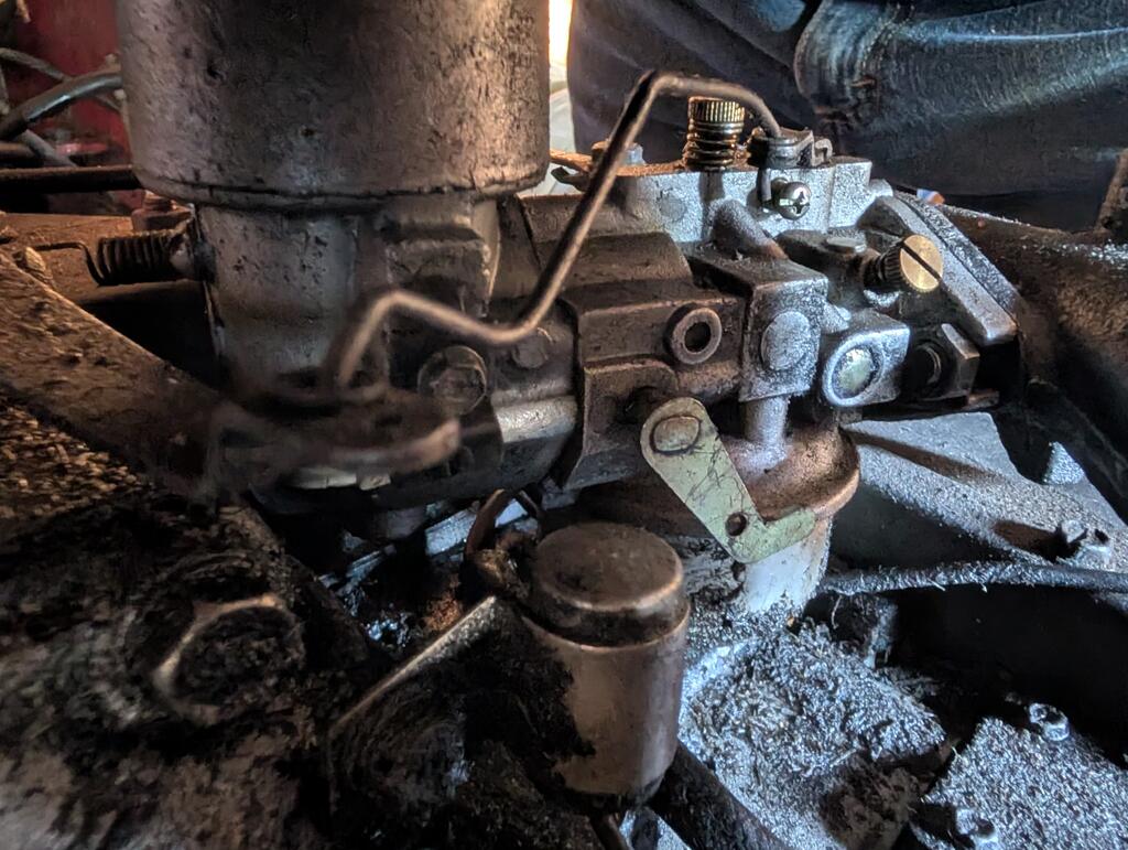

I grabbed some pictures of the carb linkage on my C-195.  The guy I bought it from said that he had replaced the carb, so I can't sayif it came from the factory this way.  The throttle and governor work OK.  The choke is not connected to the choke laver on the dash at the moment - seems the choke shaft on the carb is 90 degrees different than the original carb.
Picture 1.  Throttle cable connection to bell crank on left side of tractor.  The link on the other end connects to the governor arm.
Picture 2.  Governor arm.  Left-hand side spring goes to bellcrank that the throttle cable connects to.  The link on the right hand of the governor arm connects to the throttle shaft.  View is from the rear of the carb.
Picture 3.  The link between the governor arm and throttle shaft.PXL_20260928_193207290.thumb.jpg.6fe58c57a4935320729f426e75748ef3.jpg
Picture 4. Another view of governor arm to throttle shaft.  This view also shows the choke shaft - it is horizontal on this carb,PXL_20260928_193330176.thumb.jpg.9111b9eda9d781c4245ccc1854c51f64.jpg where on the original carb, the shaft ran vertically.
Hope these help you.

Yup.  My choke is not connected to the lever on the dash.  The current cable routing does not work with a horizontal choke shaft & i haven't gotten around to figuring out a solution.  It gets started with the hood open, so i can reach the choke lever on the carb.  It usually fires right up, allowing me to open the choke & close the hood.
