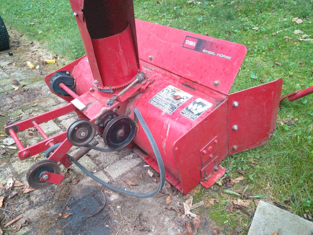

BPEisenhower 738 #1 Posted September 26 Hello all! After much debating, I'm going to give the C195 a workout.....with snowthrower. However, it's from that 520H and want to know if its going to work with my C195.. (fingers crossed). 1 Share this post Link to post Share on other sites
wallfish 20,744 #2 Posted September 26 Yes, it will work. Weights and chains make better traction. I even use #40 roller chain wrapped around the fronts for much better steering. Adjust the ground speed as necessary to keep it loaded up and keep it from clogging 3 2 Share this post Link to post Share on other sites
ri702bill 13,389 #3 Posted September 27 And a quick spray down on the auger & chute with your favorite slick stuff in a can before the storm helps. I find the cheapo store brand cooking spray works fine - just don't leave the can outside in the cold! 1 Share this post Link to post Share on other sites

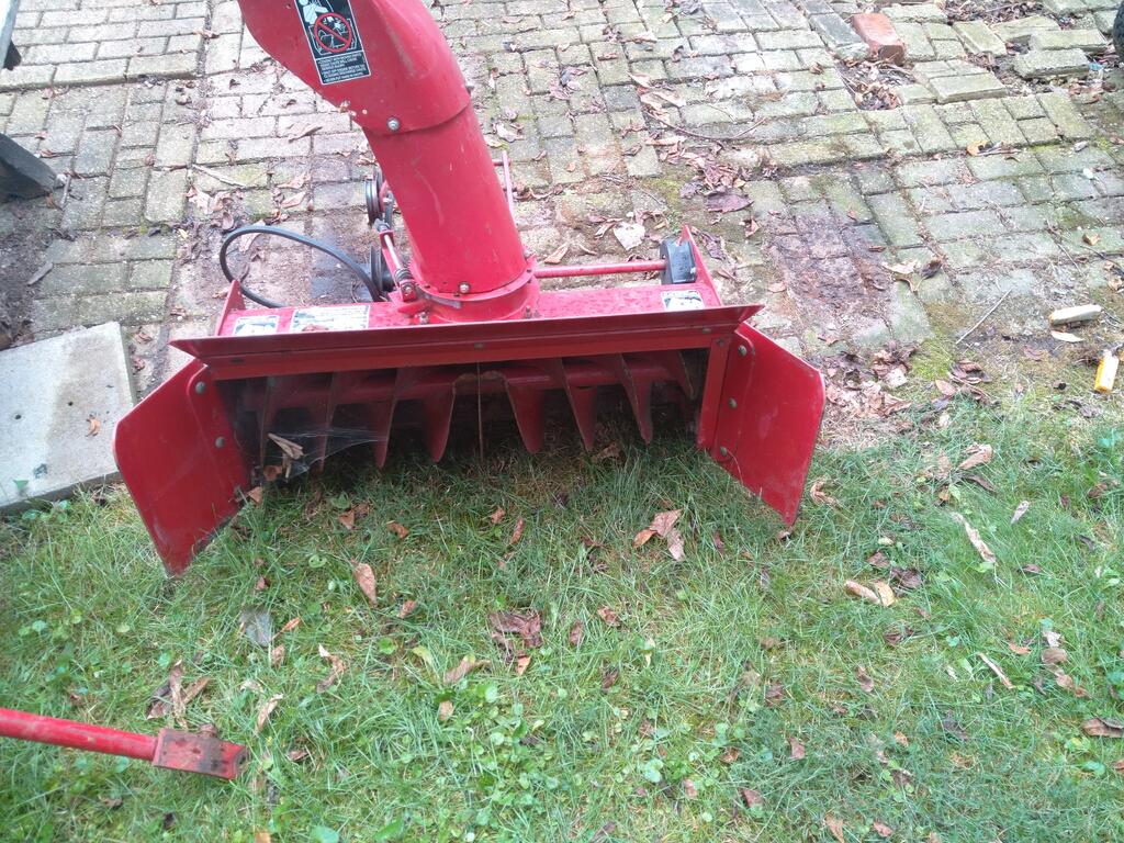

BPEisenhower 738 #4 Posted September 27 20 hours ago, wallfish said: Yes, it will work. Weights and chains make better traction. I even use #40 roller chain wrapped around the fronts for much better steering. Adjust the ground speed as necessary to keep it loaded up and keep it from clogging And so, I got it attached to the front of my C195 and now another problem, the lifting rod that slides in and out of the tube, where does it pin to? Plus, the drive belt needs to be changed, too short. Not sure how it went on a 520 but it's a pain... Share this post Link to post Share on other sites
wallfish 20,744 #5 Posted September 27 The flag pins to the bellcrank. you can find the manual in the manuals section Share this post Link to post Share on other sites

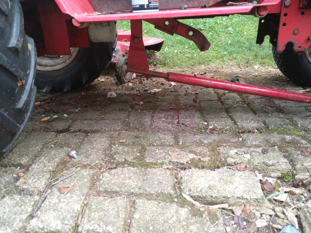

wallfish 20,744 #8 Posted September 27 17 minutes ago, BPEisenhower said: You'll need to add some 3/4" ID spacers to that flag rod if it doesn't lift enough. You want to leave enough play in it to slide in and out so the blower can float up and down a bit when blowing 2 Share this post Link to post Share on other sites
BPEisenhower 738 #9 Posted September 28 23 hours ago, wallfish said: You'll need to add some 3/4" ID spacers to that flag rod if it doesn't lift enough. You want to leave enough play in it to slide in and out so the blower can float up and down a bit when blowing Unfortunately, I can't figure out how to get it to lift. Tired of wasting time. Anyone close to me can have this thrower for free Share this post Link to post Share on other sites

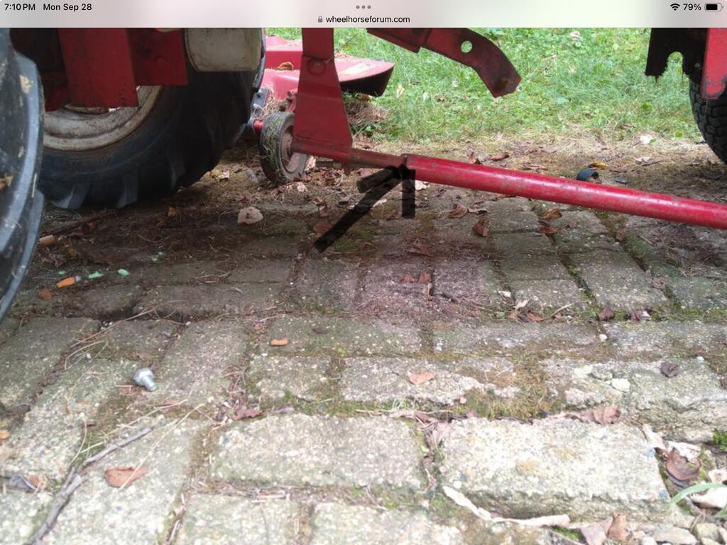

c-series don 12,751 #10 Posted September 28 If there’s not already holes in the lift flag drill one where the black arrow is pointing and put a hairpin cotter pin in the hole. It may require adding some washers or drilling another hole for proper adjustment. Share this post Link to post Share on other sites
lynnmor 9,081 #11 Posted September 29 On 9/27/2026 at 7:19 PM, BPEisenhower said: That flag pins way up in there, I have no idea what is hanging down there where you pinned. Share this post Link to post Share on other sites
c-series don 12,751 #12 Posted September 29 @lynnmor I agree but I thought that piece sticking down was part of the rockshaft, but I’m not familiar with the underside of a C-195. Share this post Link to post Share on other sites
BPEisenhower 738 #13 Posted September 29 21 hours ago, c-series don said: @lynnmor I agree but I thought that piece sticking down was part of the rockshaft, but I’m not familiar with the underside of a C-195. Went ahead and cut a piece of schedule 80 pipe and put a washer on both ends. Took out majorly of the float but, it raises and lowers. Didn't put the spring on and plan on using heavy duty caster wheels instead of the skids. Have to find drive belt since 520 and C195 are different. Was going to give away the thrower but, the neighbor asked if he can use it this winter and in return, he will keep it in his heated garage.... 2 Share this post Link to post Share on other sites
