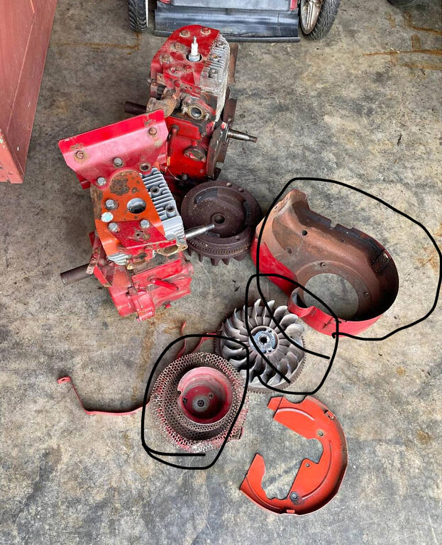

are these all the parts I’d need to convert K181 856 electric to Pullstart? Ones I’ve circled- shroud, magneto-pull cup

I don't see a backing plate wit a magneto mounted to it.

Those look more like Tecumseh engines...
The head bolts are through the upper plate and the gas tank bracket is angled odd. Mebbe not.
But you'll need a fair amount of parts $$$ to change from a Starter/Generator engine to a pull start.

The particular parts pictured are not for a pull-start, they are for a gear-drive starter.
That setup will only work in your tractor if you relocate the battery (see @Thegearhead0324's 1267 thread). You will find on the short-frame units that a gear drive starter and the battery will attempt to occupy some of the same space, and Newtonian physics generally disallows this.

I understand all that. However if you look at the parts he circled in the picture he posted, those particular parts are for a gear-drive starter.
The flywheel has teeth, the engine shroud has a starter drop, and the screen technically has a pulley you could wrap a rope around, put it is not a true pull-start recoil setup.
Those parts on an engine with the magneto ignition on it can still be used as a pull start only engine. No starter, no battery, no physics. I was going by the title and his question.
The only mistake he made was calling the flywheel a magneto.
There are some engines with gear starter that have magneto ignition that do not need the starter or a battery to run. They can still do it even though it has a ring gear and bump out on the shroud for a starter

The engine in the front of the photo looks like a tecky like @ebinmaine stated, it does not have to fuel pump area and the same breather as the kohlers. The engine in the back does however look like a kohler

Techy throttle linkage hook up on front engine
