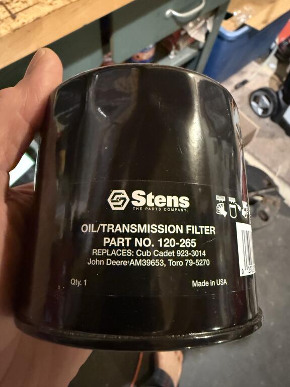

Sparky-(Admin) 26,260 #4 Posted 3 hours ago 7 minutes ago, WHX?? said: Wonder who makes those Sten filters? Quick search came up with this: Stens brand filters are manufactured by Arrowhead Engineered Products, which acquired Stens from Ariens Company. 2 1 Share this post Link to post Share on other sites
