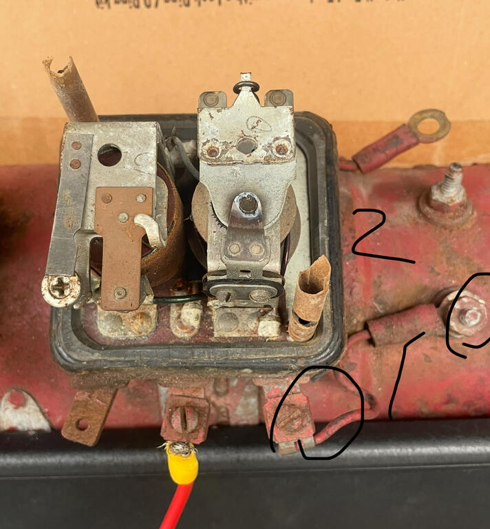

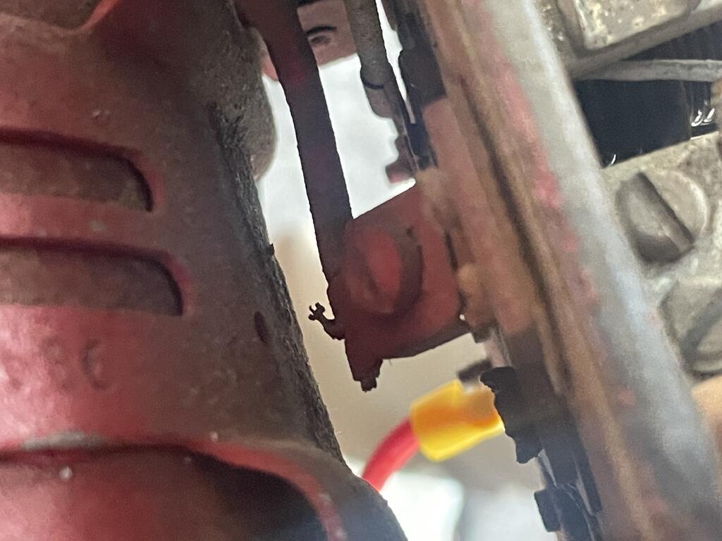

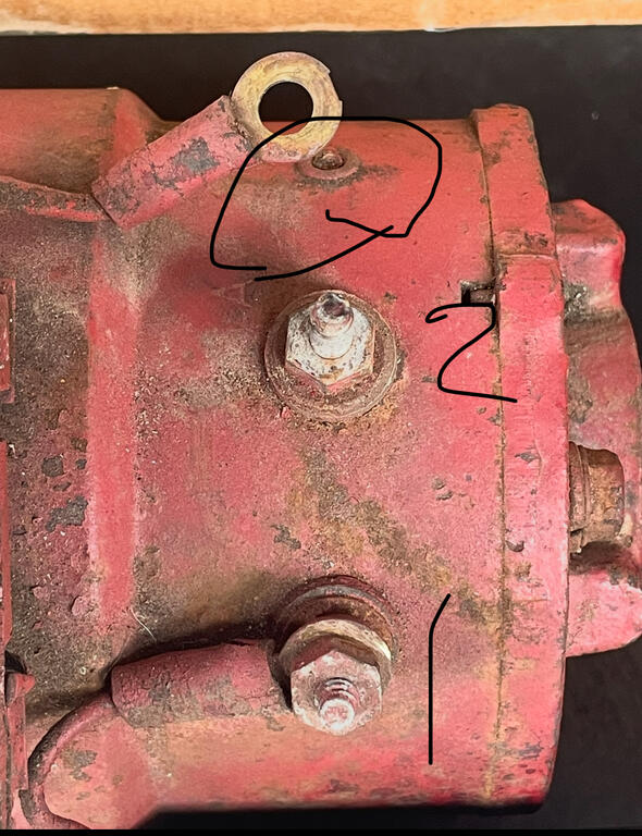

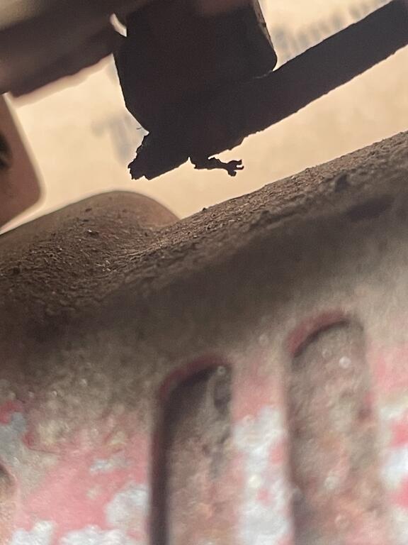

FLtractor
On 9/20/2026 at 6:16 AM, squonk said:
Make sure the short wire underneath the regulator that goes to the gen is broken.
Evening Squonk, my S/G for my K181 not turning over but was professional bench tested and it works but was told the voltage r regulator doesn’t charge. My question is the wire underneath my voltage regulator here.. does that anything to do with the starter turning over when key turned or that’s just the batter power- to ignition switch to the 2 terminal on the S/G to voltage regulator. Picture or my under wire appears tab not supposed be bent and wire may be frayed needed replacing
pfrederi
That wire is what feeds the generator output to the regulator and then after the regulator regulates that out put it goes to the battery
FLtractor
Posted (edited)
So The battery powers the generator.. electrical current flows through that wire underneath to power the voltage regulator and then electrical current flows through the middle outside front terminal to the + battery terminal to keep it charged? So it’s a related self contained loop cycle if you will.. not sure if official electrical  term.
If the powers flows into the voltage regulator underneath then what is wire going to terminal 1 here from voltage regular to S/G for?

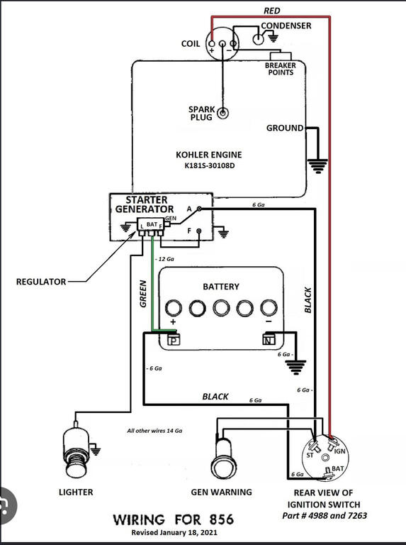

953 nut
No, the heavy wire from the battery "+" to the switch, the heavy wire from the switch to the S/G "A" terminal and the ground wire back to the battery "-" terminal are the only components in the start wiring. I run the ground wire directly from the battery to one of the S?G mounting bolts.
The diagram below should be helpful.
FLtractor
So your diagram in conjunction with my 856 specific. Helps thank you.
on 856 diagram- what does the F terminal with wire to voltage gen front terminal on far right do? If power goes INto voltage regulator through terminal A. Does power go back into S/G through terminal wire F?
