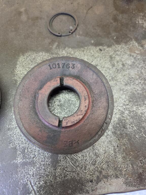

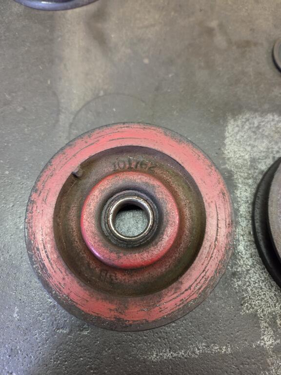

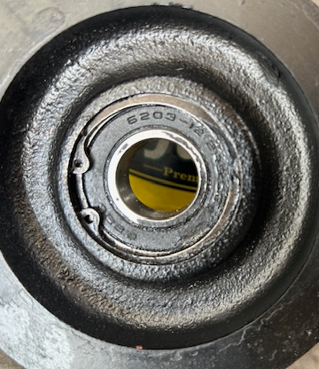

Trying to find new bearings for these pulleys.  The V pulley had a 6203-12 bearing in it, but it was loose and had been shimmed in a failed attempt to make it work.   What bearings do I need?  Thanks

@BillD  got cha ! did some snoopin around , ,lucky you ! https://www.google.com/search?q=101763+bearing&rlz=1C1CHBF_ most important  feature ?  WIDE EASLY REMOVABLE SIDE GREASE SHIELDS !  flat pocket screwdriver / small flat  putty knife , pops those right out , wipe out  original  lube ? carb cleaner  flush , then LUCAS EXTRA HD , GREEN CHASSIS GREASE , 550  deg  flash point , polyurea rated , anti sling , completely transforms that bearing  into a smooth / quiet /  long lasting  unit for  brutal  set ups . every bearing  in my  pto, mule drive , mower decks , related , needle bearings , have this , did this change over  years ago , never had a failure ,  what an opportunity ! pete
